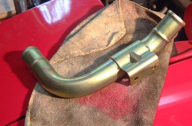

 It could be this pipe under the air cleaner assembly. You can see the rusted hole in the right side where the rubber hose would be attached.

Does the “bottom pipe” or that metal pipe run close to the engine block? This was the side that the leak was spraying from.
