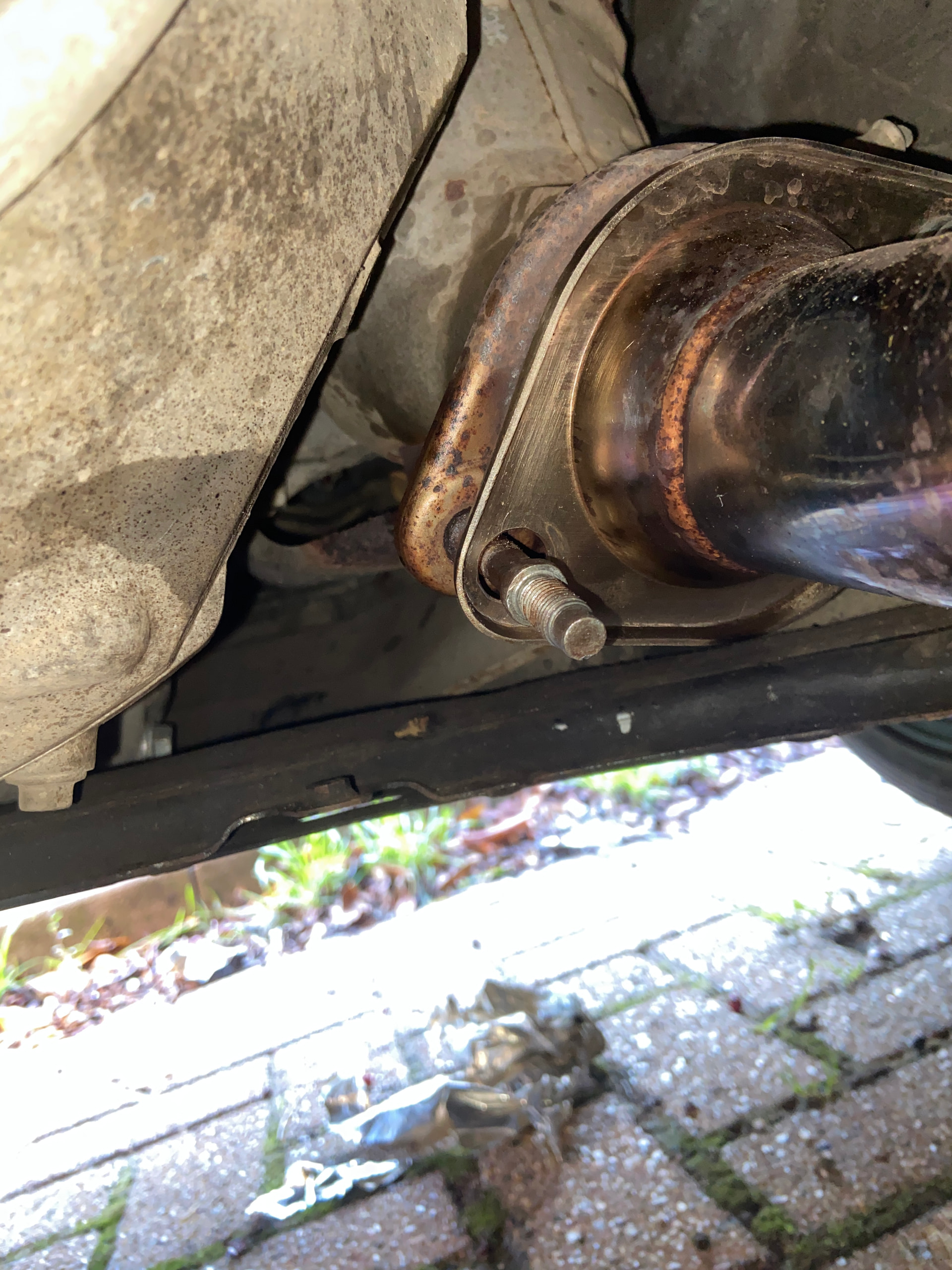

So i installed a new midpipe 2 ish months ago, one bolt came out fine and i couldn’t get this one out and i just used a sealer and it finally broke and i’m now addressing the exhaist leak. But how the hell does this one come out?? The other side has a brand new bolt and spring and i have one for this side too but i could never get this out i need help asap

Two nuts on the threaded nip them together fit ring spanner on with a long pribar give you more leverage crack it off……
That looks like a captive stud, welded to the flange. It has a shoulder to prevent over-tightening the spring. The Mellens drawing shows two captive studs on the manifold flange.
Was that an old photo and it’s now broken? If so, then the easy option is dremel to cut it flush and then drill out the residue.
Yes, this, there doesn’t look to be anything wrong with that stud, can’t you just put the spring and a nut on it?
Best bet. I had this problem when replacing the manifold. Ended up having to cut bolt but was not a problem as was replacing the manifold. Could you just re tap the bolt and leave the bolt in the manifold?
Probably, was told to use a thread chaser so ill try it out as my new manifold bolts i bought dont fit on which is annoying, but its prob due to rust between the threads
If you can resurrect the existing bolt id go for that. Getting the manifold out for me was a bigger job -ideally 2 person and heat shield bolts very challenging. Even after that I still couldn’t get my ceased manifold bolt out -even on the bench . But as I was replacing the manifold it was not an issue .(maybe an excuse for you to get a new header :+1::joy:)
