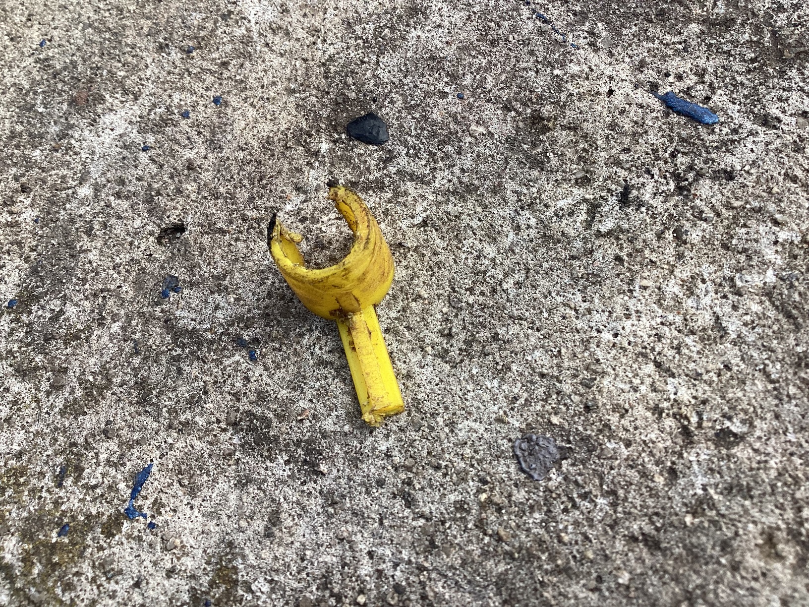

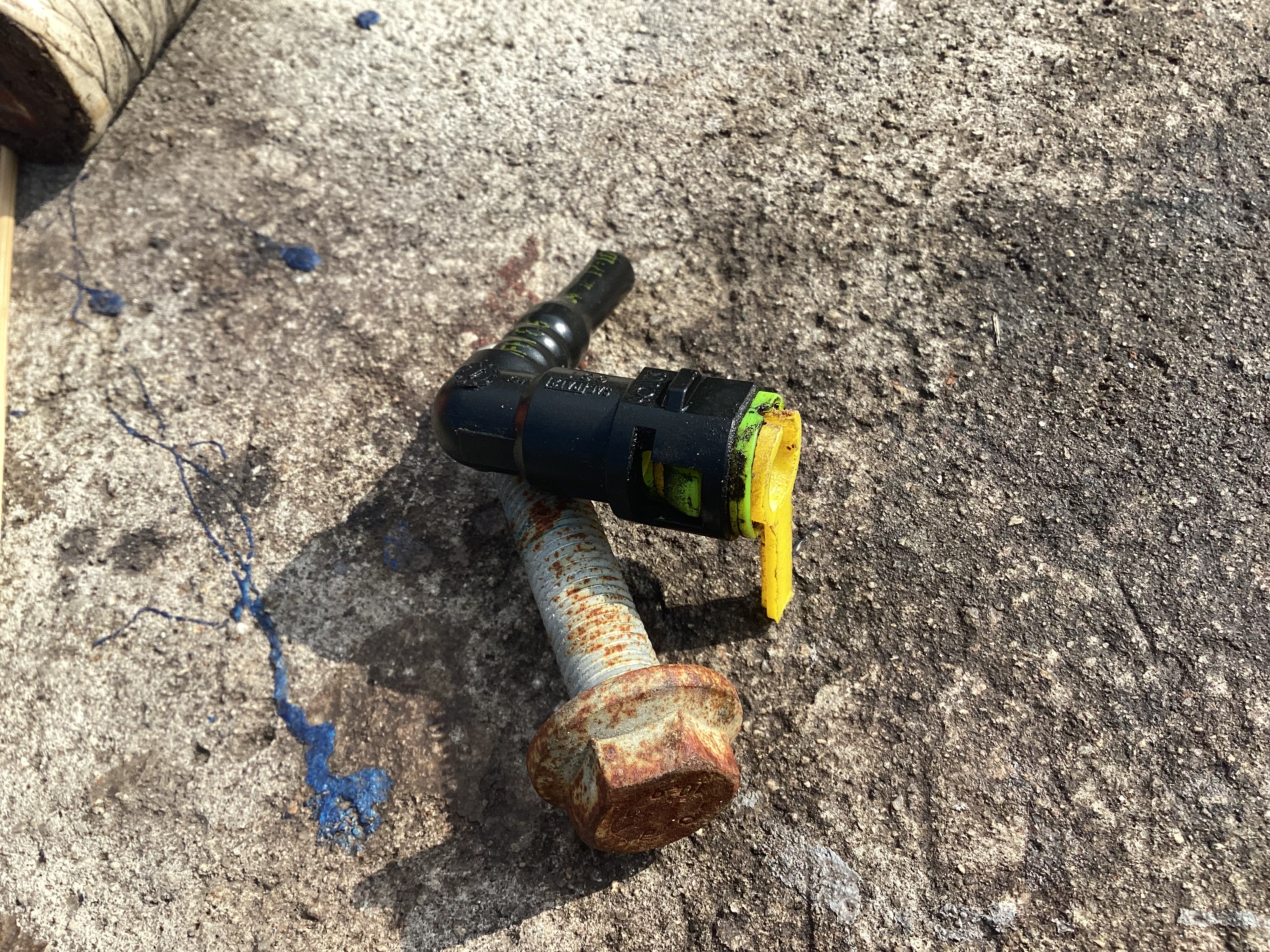

Yes, it can be done with picks or shaped barbecue sticks but it’s very awkward in the shed on the replacement; let alone in the confines of the car. Found a bit of plastic that I’m whittling into shape hopefully……
Success!

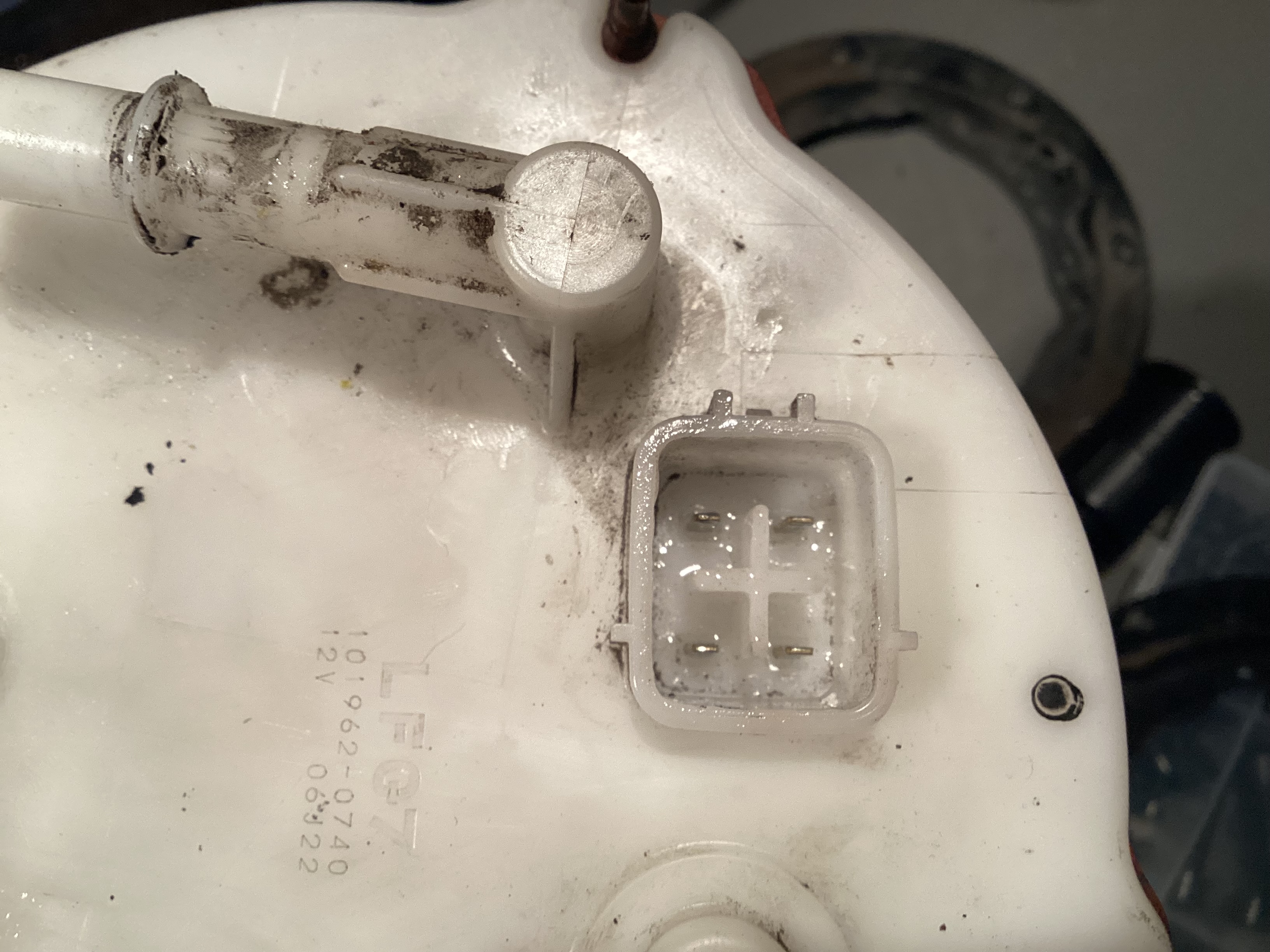

Here a pic of my replacement fuel pump assembly. The one in my car has one of those pins missing, probably because of overheating over time. There sadly isn’t a workaround so replacement is the only sensible option…
