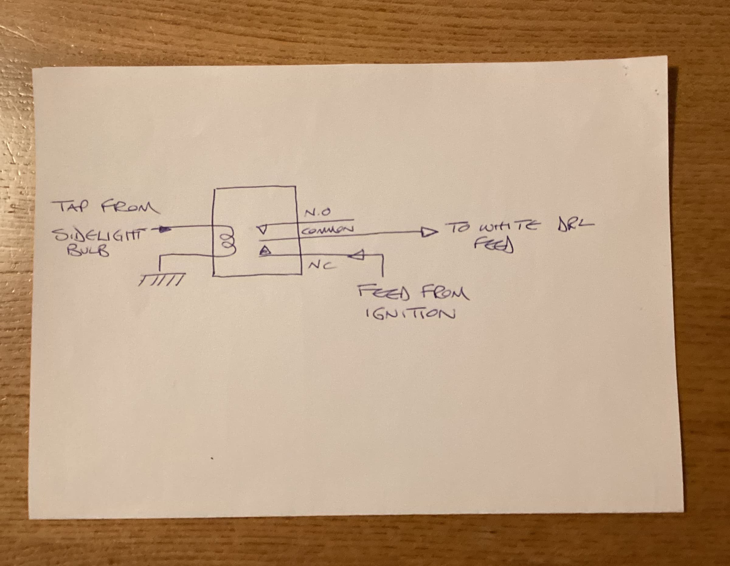

Secondly, for turning the DRLs off, I used a standard auto 5 pin relay to break the DRL power connection when the sidelights were on using the common & normally closed terminals. So either dipped beam or main beam will power the white DRL off. I think the DRL feed wire from memory was white, but it could be red. I’ll have to check that in the morning.
[EDIT] I’m pretty sure the fused feed wire with my kit is red and not white.
See the diagram below

Well I decided to go down the 5 pin relay route, and within 5 minutes had it all working as it should be, typical…
certainly should have gone that way to start with :+1:
