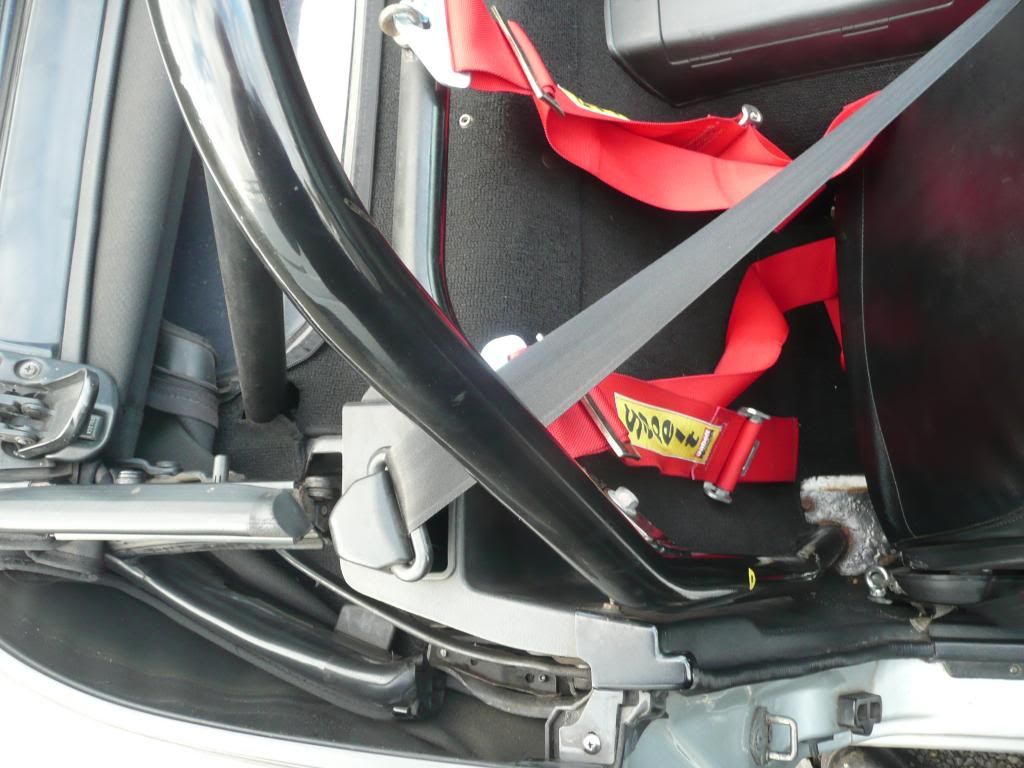

Ā This is a Tr lane gp xĀ  .Ā  As you can see the drivers seat is right back to the bulk head.Ā  Be aware if you get a rear shunt without a helmet like all bars you will probably smack the back of your head on the bar. I have this bar fitted and i’m 6’1
Thanks Nedski !Ā  Looking at the picture I’m still unsure about the location of that front hoop.Ā  I think that is going to cause me some problems because as I’ve said I’m tall and wide (not fat - just wide !)Ā  I guess the only way to be sure is to sit in a car with one fitted.Ā  Might go and see the very nice chaps up at Roddisons in Sheffield and see if they’ve got something I could look at and get a better idea.Ā  Thanks again.
Just to add a bit more. Ā This is a Carbing bar and the leg goes behind the seat to the floor. It lost me a good 30-40mm of rearwards seat movement and I had to sell it as I need all the room I can get. The TR lane gives full seat travel.
This another TR Lane with the seat full back. The Bar does not inhibit seat movement. Ā There are other good bars in the market but I’m only familiar with the these.
