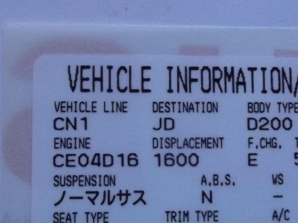

Thank you everyone who’s replied, I’m so grateful I really am. The links thanks again guys, I’ll update when I’ve had a good old read and research. Again my Eunos recently flew straight through the MOT, to be honest we’ve been busy with our grandkids so very very little mileage was done in the last period between tests.
Below photo taken at the MOT garage.
cheers
