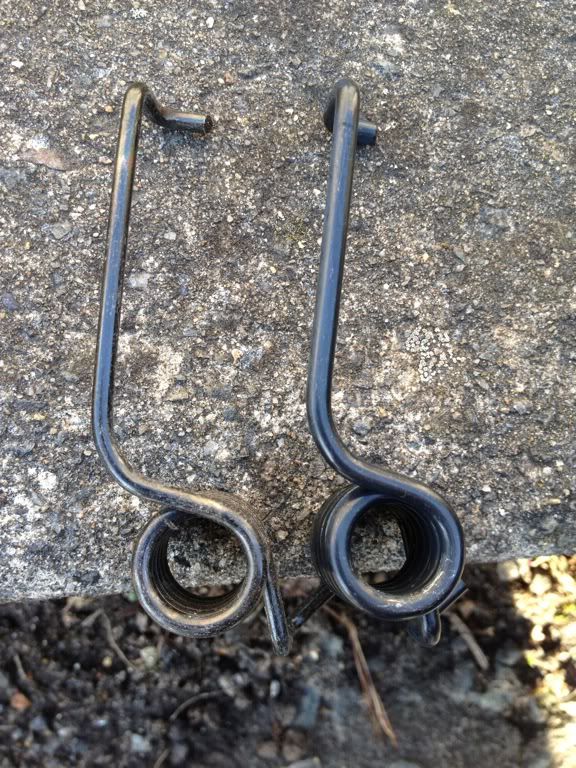

The beautiful weather yesterday was the reason I needed to fit the new springs to the soft top.
It was an easy job (10 mins) with a plier and fixed the little folding problem right away. Great stuff!!
Here are some picture of the old and new springs. Note that the new springs are noticably beefier and you could feel the extra strength when fitting them too.
Old and new soft top springs 1
Old and new soft top springs 2
