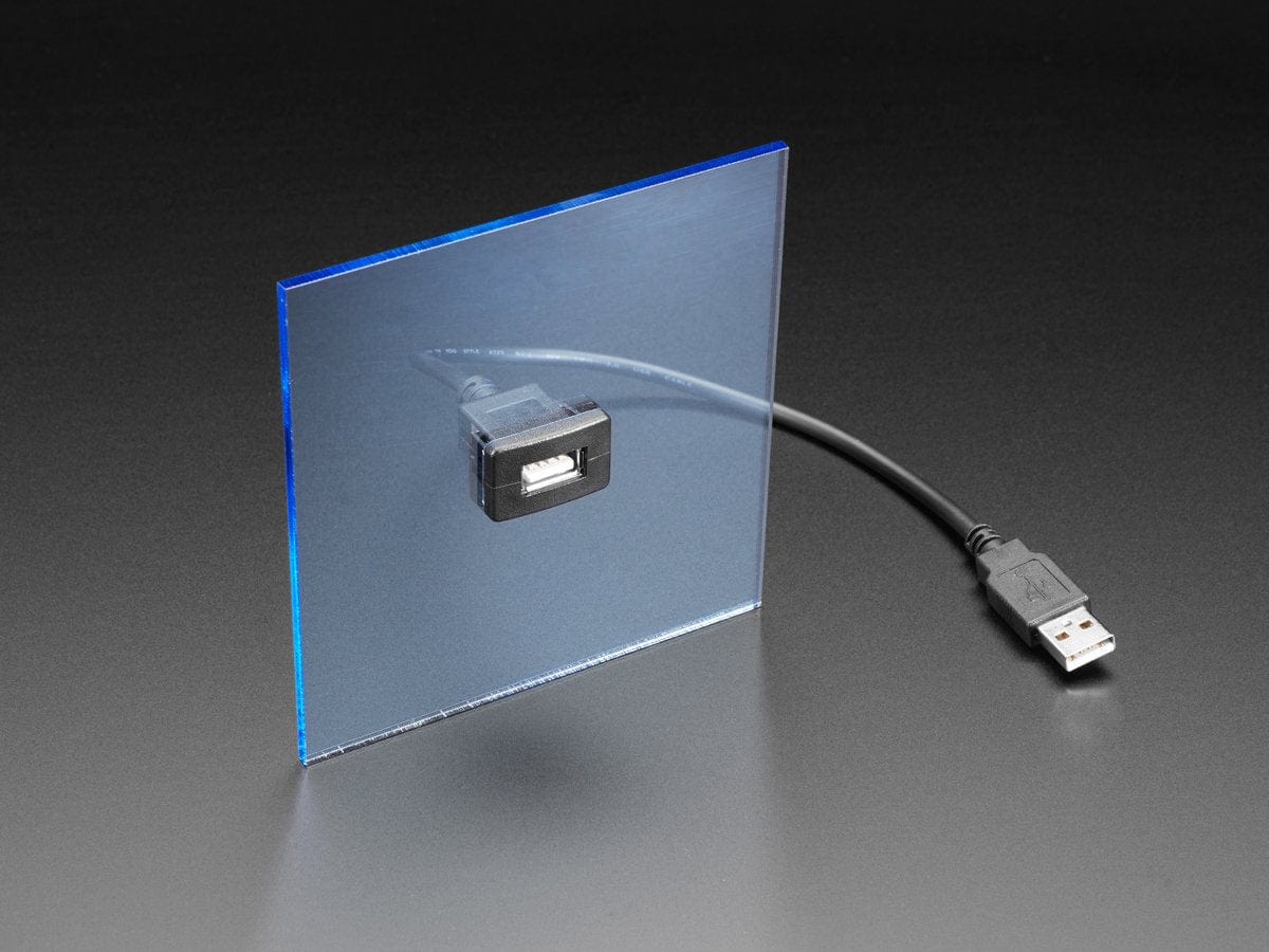

I’m struggling to find a small panel that allows the USB connector to be used. Has anyone come across this before ?

Yes something like those, thank you. The dimensions aren’t exact so some fettling may be needed. I’ll wait and see if anyone else has a proper solution. Thanks again for finding those.

I found this one on Amazon thanks to your ideas. Probably have to file down the edges to fit.
5Gbps USB 3.0 Male to Female Panel Mount Mount Short Cable Adapter, Extends and expands USB 3.0 ports, providing a secure and stable environment for data transfer or charging. Designed to fit standard XLR/D-sub panel mounting dimensions (19mm x...
£15.99
Brought off ebay, perfect fit. £9.95
USB 3.0 flush mount extension cable designed to provide a high-speed USB port through dashboards, panels, or custom installations. USB 3.0 Type-A male to female extension. Car dashboard USB extension.
