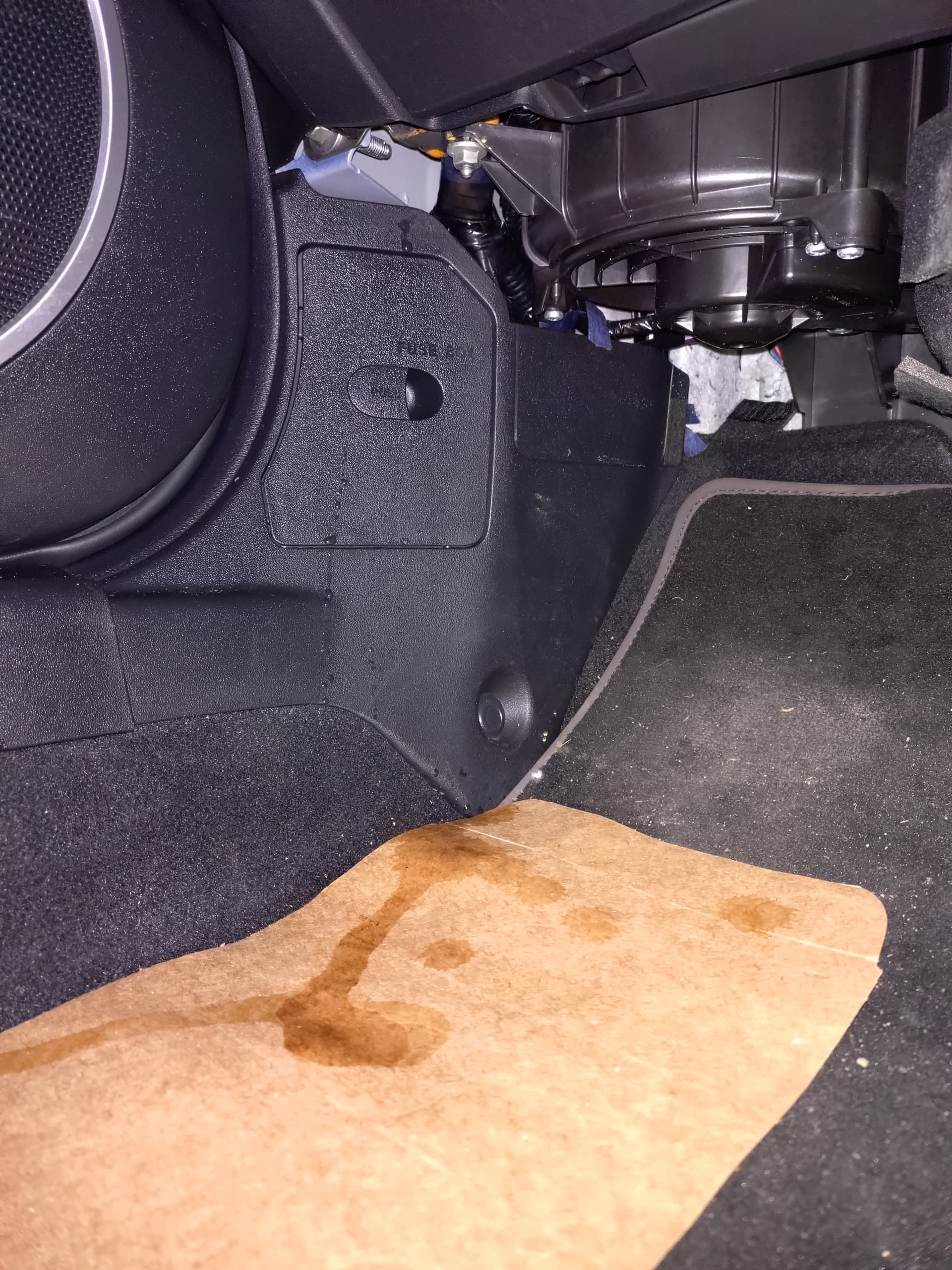

Water leak inside passenger side
  1. My model of MX-5 is: Niseko MK3 2008
  2. I’m based near: Leicester
  3. I’m looking for technical help or recommendations on: Hi, I’m wondering if anyone knows where or what is causing this leak inside. It’s on the passenger side, seems to be coming down the side onto the carpet making it a little wet. It’s not too bad right now but would like to fix it before it gets worse. Doesn’t always leak if it’s raining, only sometimes which is weird. Also tried using the hose to see if it comes through anywhere but it doesn’t seem to leak when I do that also. It must be a very slow leak just don’t know where.
Scuttle grommets!
Front NS drain hole, located just above by windowscreen wiper. Just youtube it , theres loads of guides
I’d be looking inside that fuse box too, behind that little door. All kinds of electrical gremlins can happen if water gets in there.
As mentioned search the forum for NC scuttle grommet sealing.
