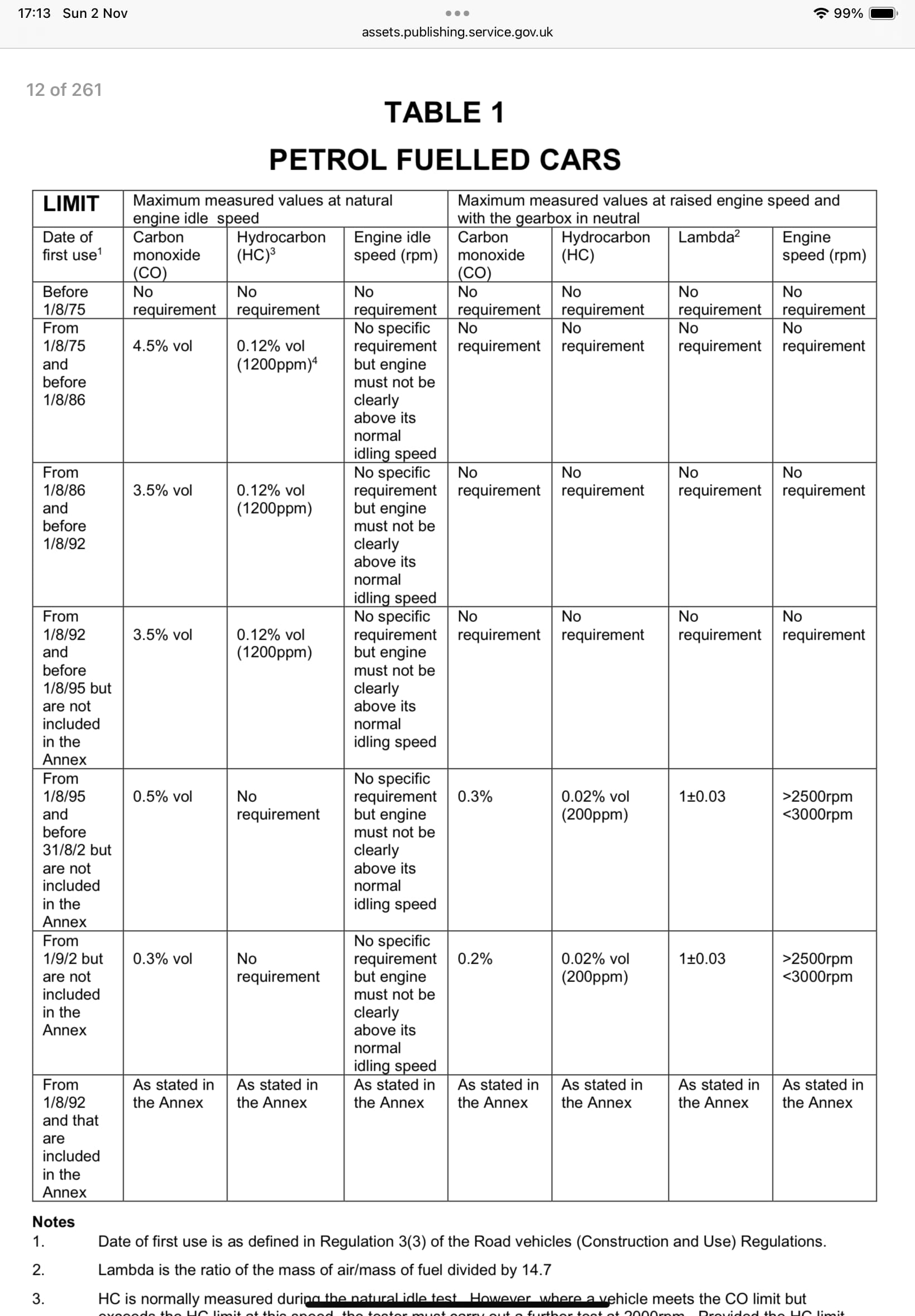

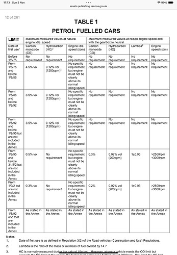

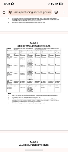

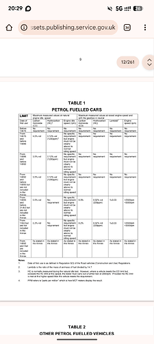

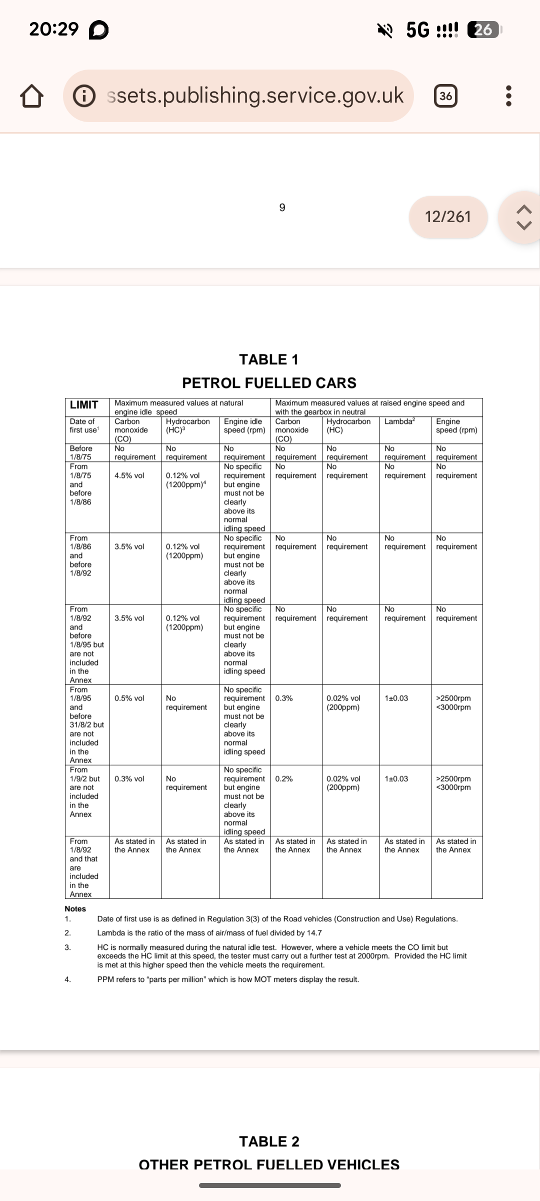

Have a look at this. Mot emissions regulations
You will find which category your Eunos falls into.
If manufactured before August 1992, then it needs to be tested to non cat standards.
3.5% CO and 0.12% HC on natural idle.
if manufactured between August 1992 and August 1995 and not mentioned in the annex, (It’s not)
It’s the same levels.
