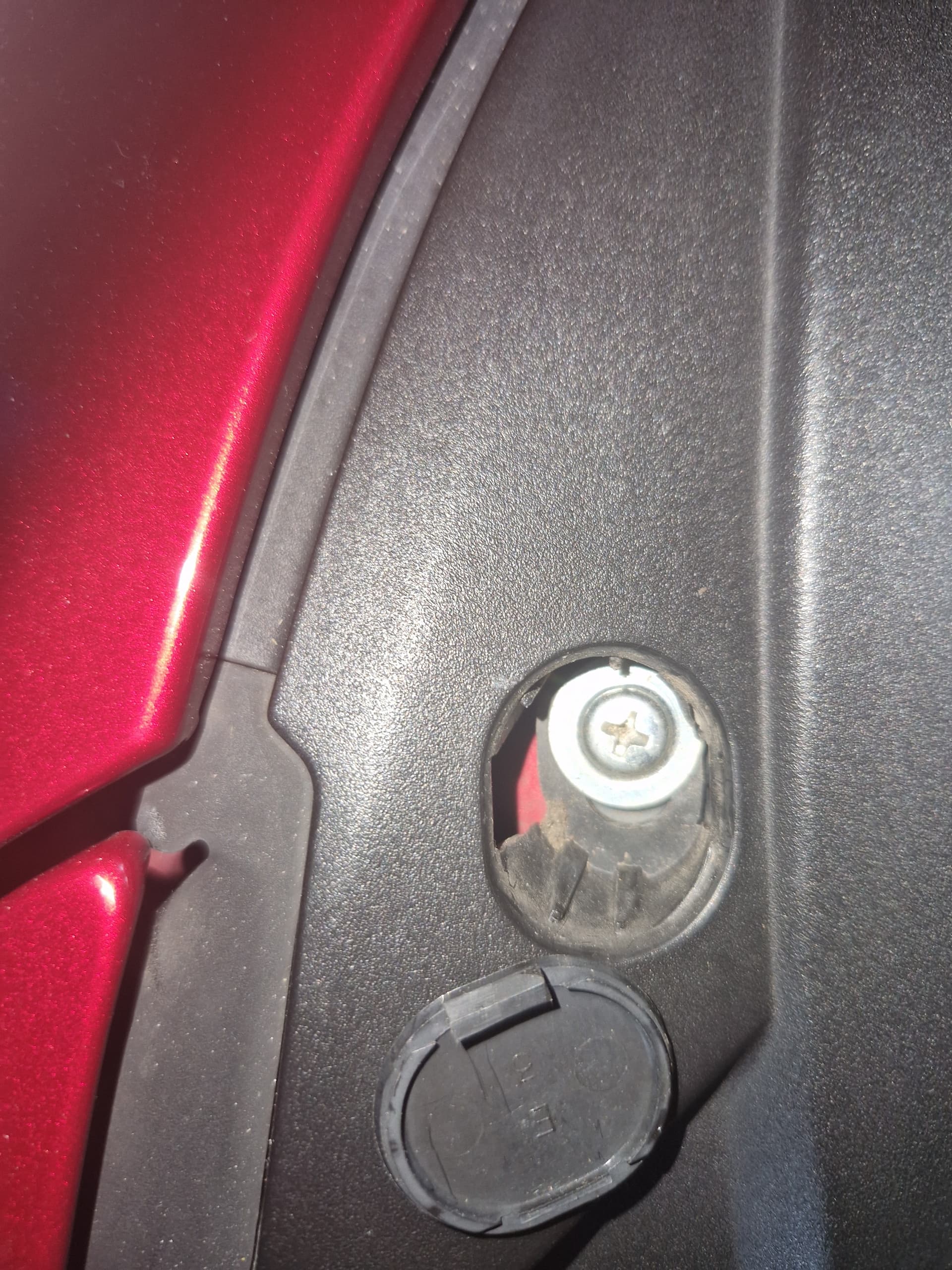

Windscreen panel plugs
  1. My model of MX-5 is: __25 Yr Anniversary
  2. I’m based near: __edinburgh
  3. I’m looking for technical help or recommendations on: __sealing blanking plugs
I think you might be looking for these :- Windscreen Cowl Leak Repair Kit, Mk3/3.5/3.75 – MX5 Parts
Should I silicon them in or cut piece of plastic to cover holes & silicon that in
Thanks for details, didn’t know they sold kits.
Just bought covers.
Alistair
Before you install your new covers, I’d strongly suggest that you remove the panel that they are attached to and seal the grommets below with lots of sealant.
(The covers, in my experience, are a one-time only fit. Once they are in place it’s all but impossible to remove them without breaking them).
Thanks for reply Philip.
Agree I’ve now watched a few videos on YouTube describing how to fix this issue so will be sealing them.
Alistair
