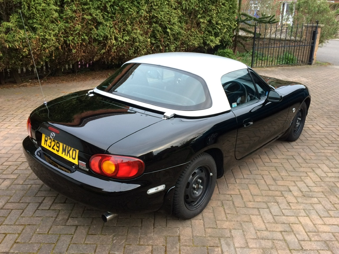

It just so happens that I’ve got a set of four steel winter wheels in black for sale (14”) to fit a Mk1/2. I’ve sold my NB so won’t be using them again. The wheels have excellent Goodyear Ultragrip 8 tyres with plenty of tread (they only did one season). Any takers let me know £150 asked.
