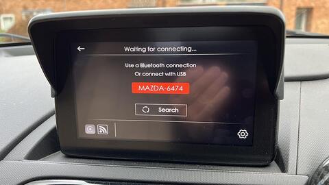

I switched the car to accessory mode and the device booted and asked a couple of questions, make and model of car. It then asked to create a bluetooth connection to the iphone
A few seconds later, it booted to CarPlay automatically. You can go to settings and look for updates, manual connection, bluetooth name etc etc but other than checking for a software update (there wasn’t t one), I left well alone.

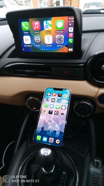

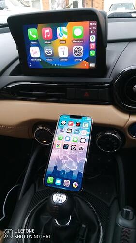

… and just to prove “no leads”

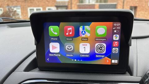

I did a couple of timing tests, unlocking, watching entertainment system boot thru warning screen etc and by the time it was ready to use, the wireless carplay adapter had already booted and connected to my iphone in my pocket. Impressed.

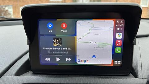

I tried out iphone maps, google maps, tunein radio, messages, whatsapp and they all worked OK as did Siri and the phone for calls.
