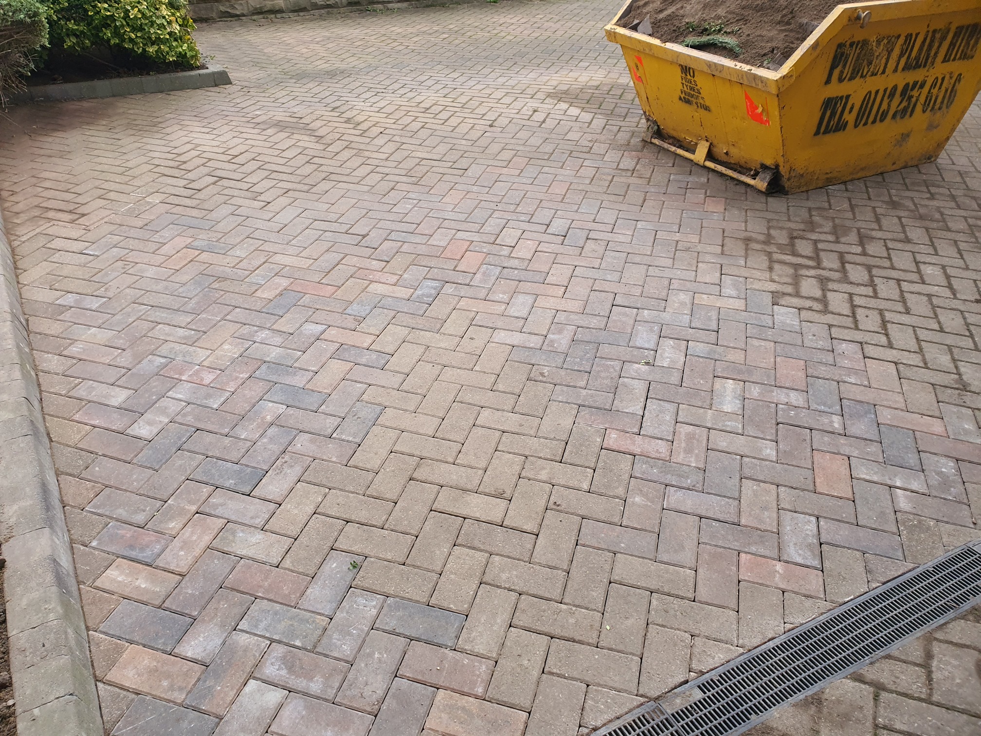

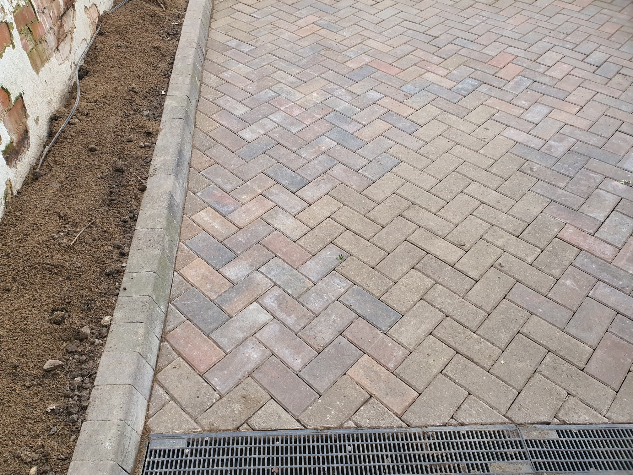

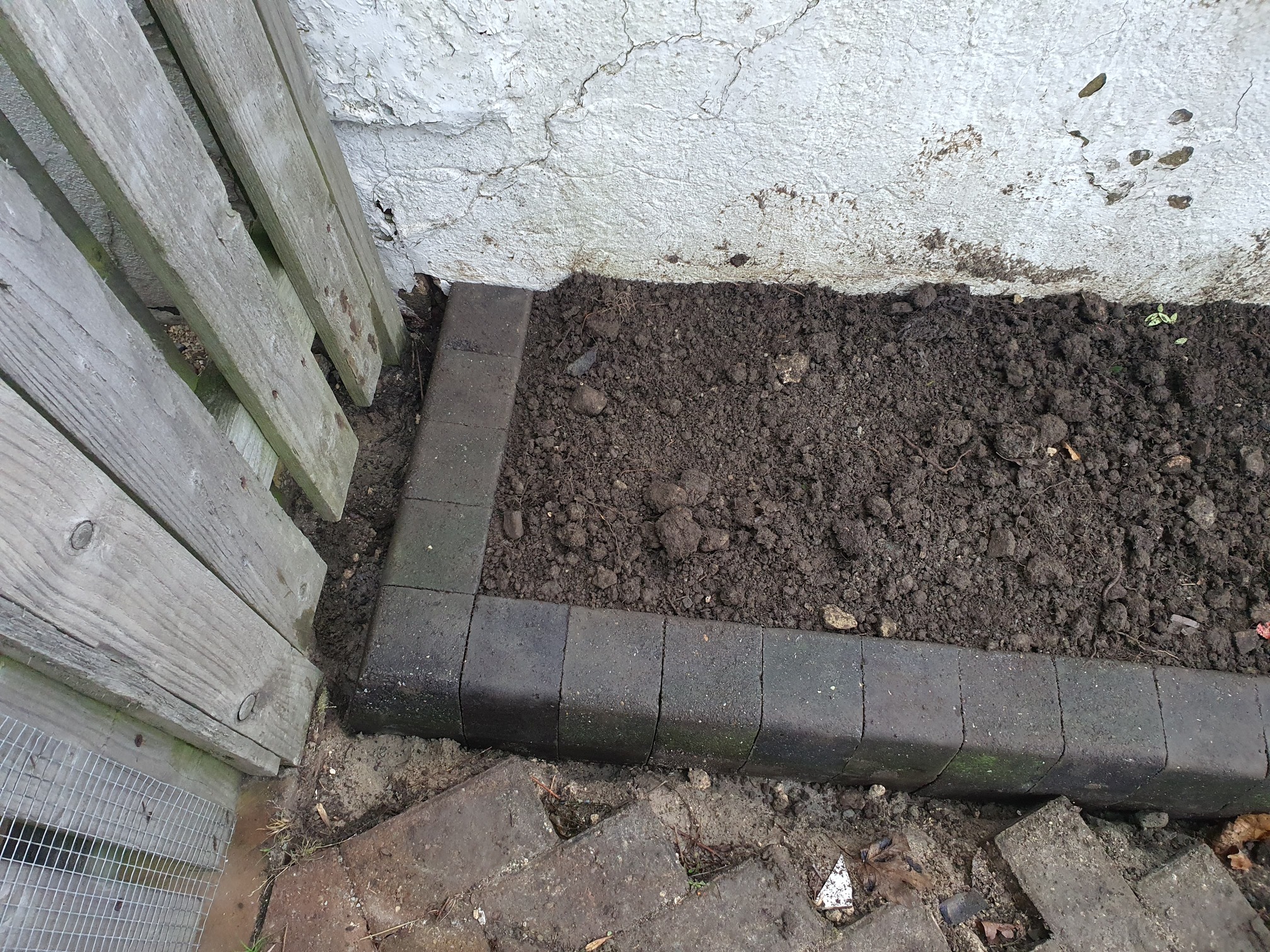

So, things have moved on a bit further today. Despite some rain, I’ve managed to lay the kerbs in the new position, haunch them too and dig out the last of the soil, placing it to the rear of the kerbs. The materials arrived mid morning so go stuck in until mid afternoon. These are the results.

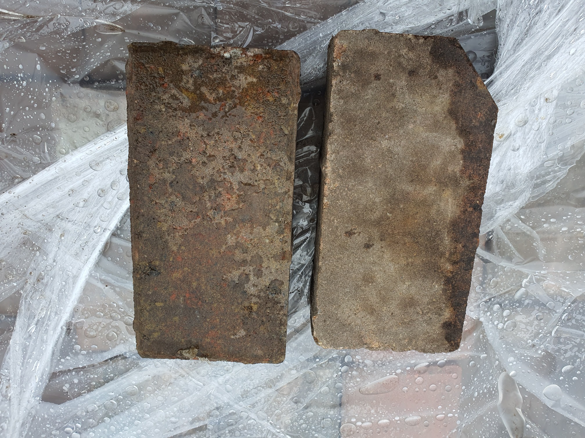

The blocks were ordered from a thumbnail photo but are almost a perfect match!
The one on the right is original, the left one is the new.
I’m on track to start laying blocks tomorrow with a view to completing them over the weekend :+1: TBH though, there are loads of cuts and that will be time consuming. I’ve saved all the original cut blocks, some might fit the gaps :crossed_fingers:

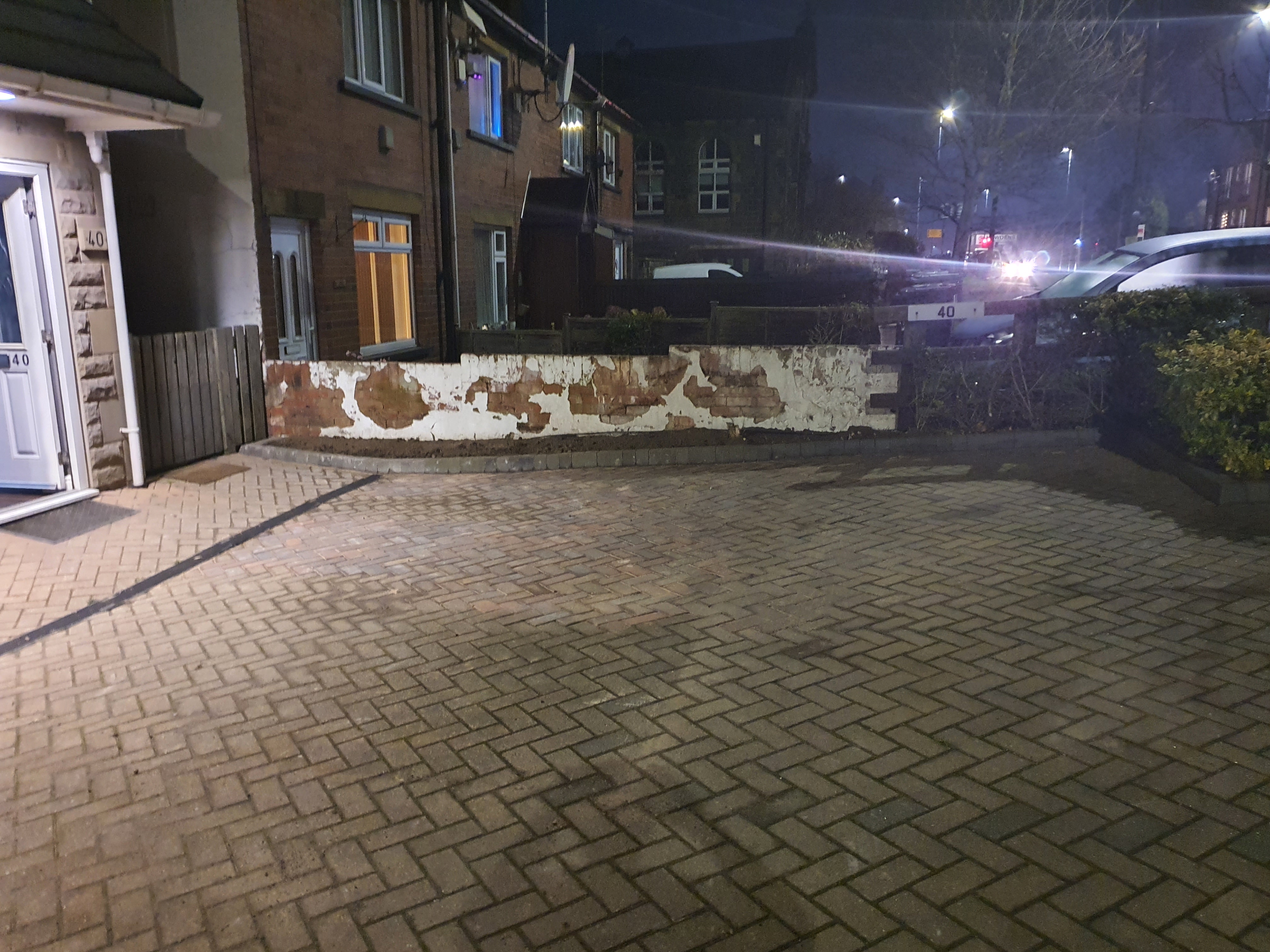

The boundary wall looks atrocious but it belongs to next door, the render is falling off and it all just is a mess. I’m thinking that I will clean off the loose render and get some masonry paint on it. After all, it’s me that has to look at it. The neighbour just isn’t bothered, his gable end has also been rendered and looks almost as bad!

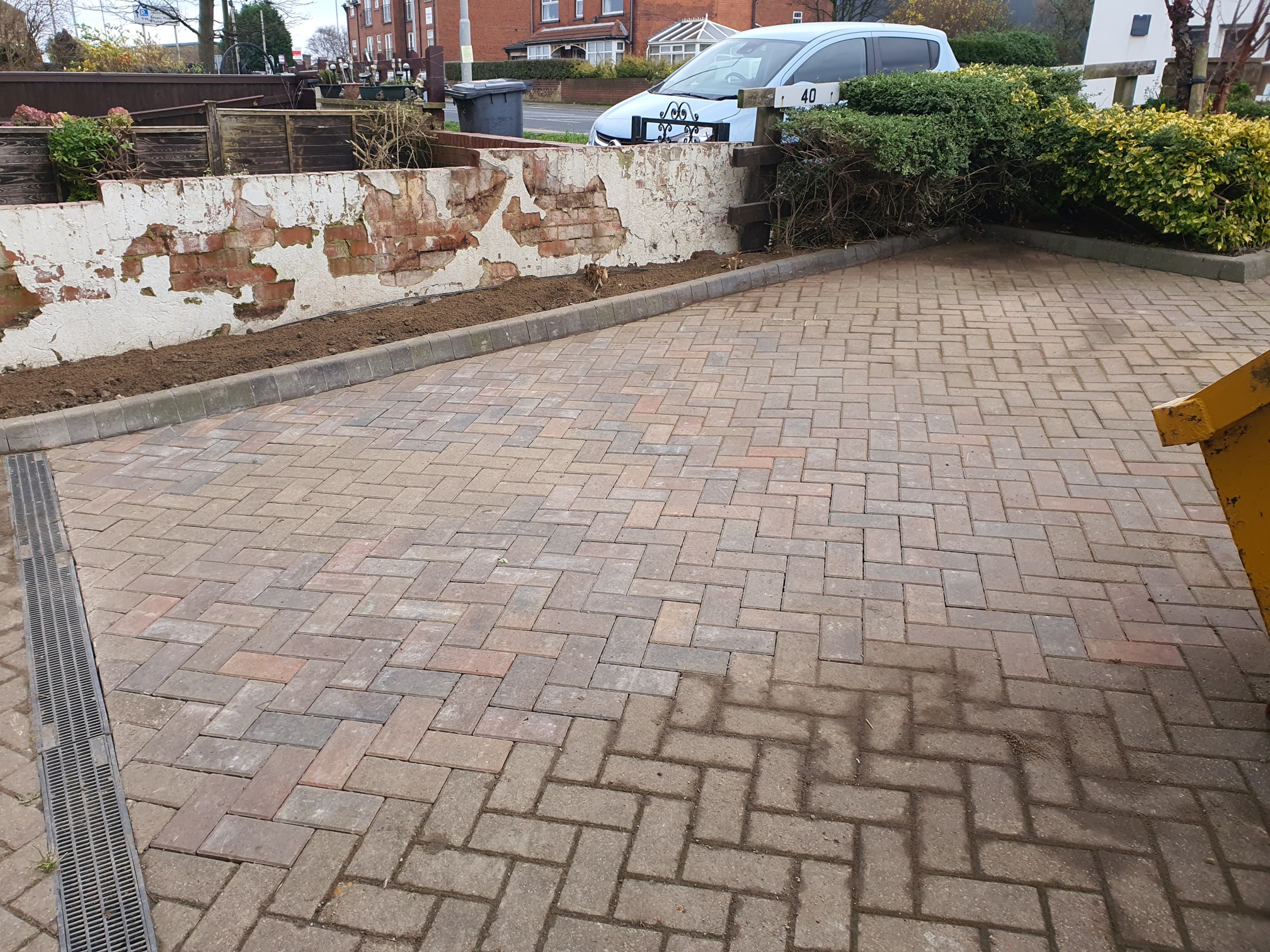

Got quite a bit done yesterday :+1:

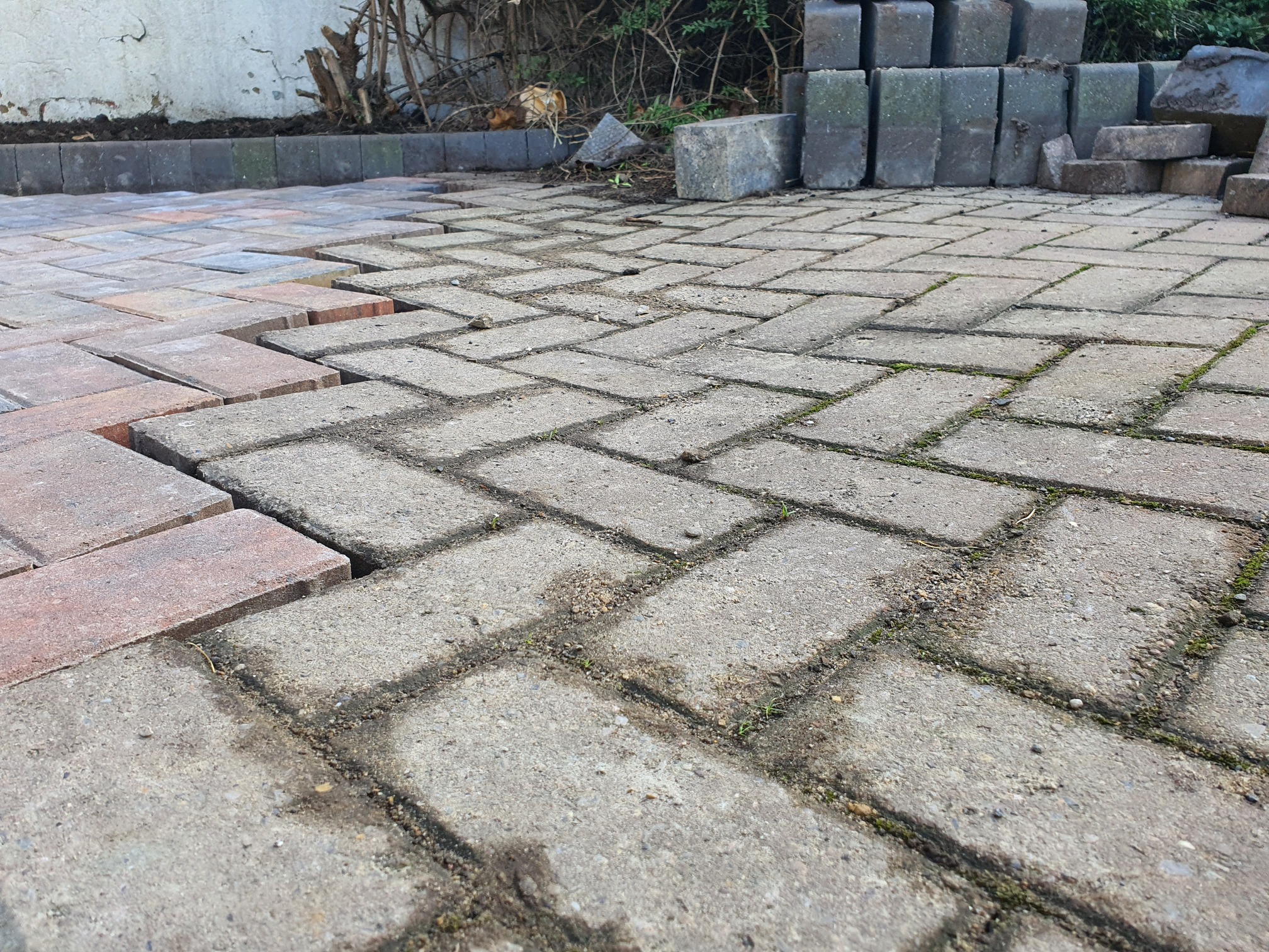

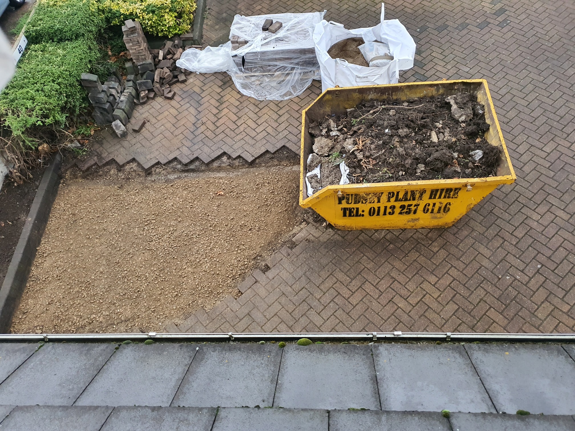

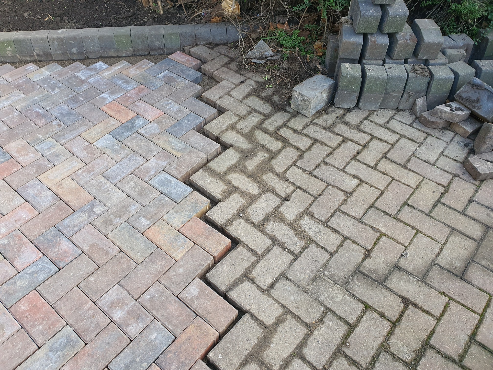

All the cutting still to do and on that note, I’ve purchased a 9" grinder plus a diamond stone cutting blade. Not my favourite tool TBH but I want/need a clean cut. I started laying the blocks and soon found out that as they diverged and went either side of the original flower bed, (now removed) the ‘bond’ was starting to creep a bit, leaving ever wider gaps in the joints :thinking:. I ended up taking them all out, plus more of the existing ones, following the drainage channel as a base line, like the rest of the forecourt. This has resulted in this,
Its my intention to lay a header course of blocks, cutting a channel out, one edge being in the existing and one at the new edge,
The existing edge has a depressed area where the wheel track of the parking space is. Poor workmanship (not mine) but I’m going to relay that area to the correct levels,
Not easy to show on pics but it will be worth doing.

Well, almost there now!
I’ve rung the skip company, hopefully collect tomorrow, then, providing it stays dry, a few bags of kiln dried paving sand for the joints and Robert’s yer Dads brother! :smiley:

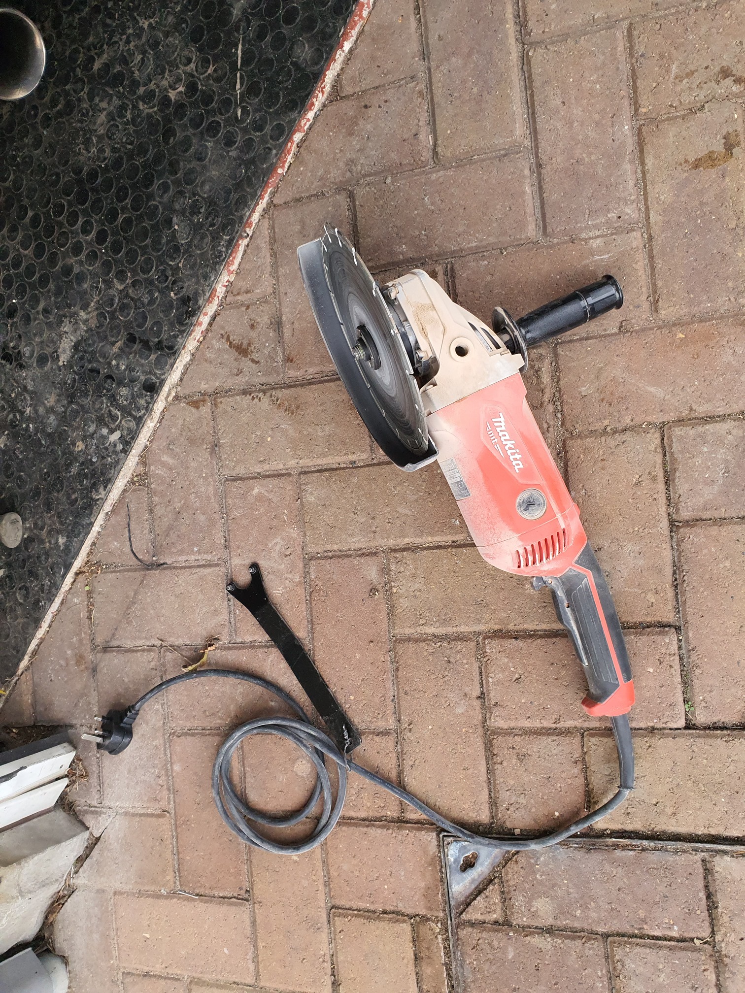

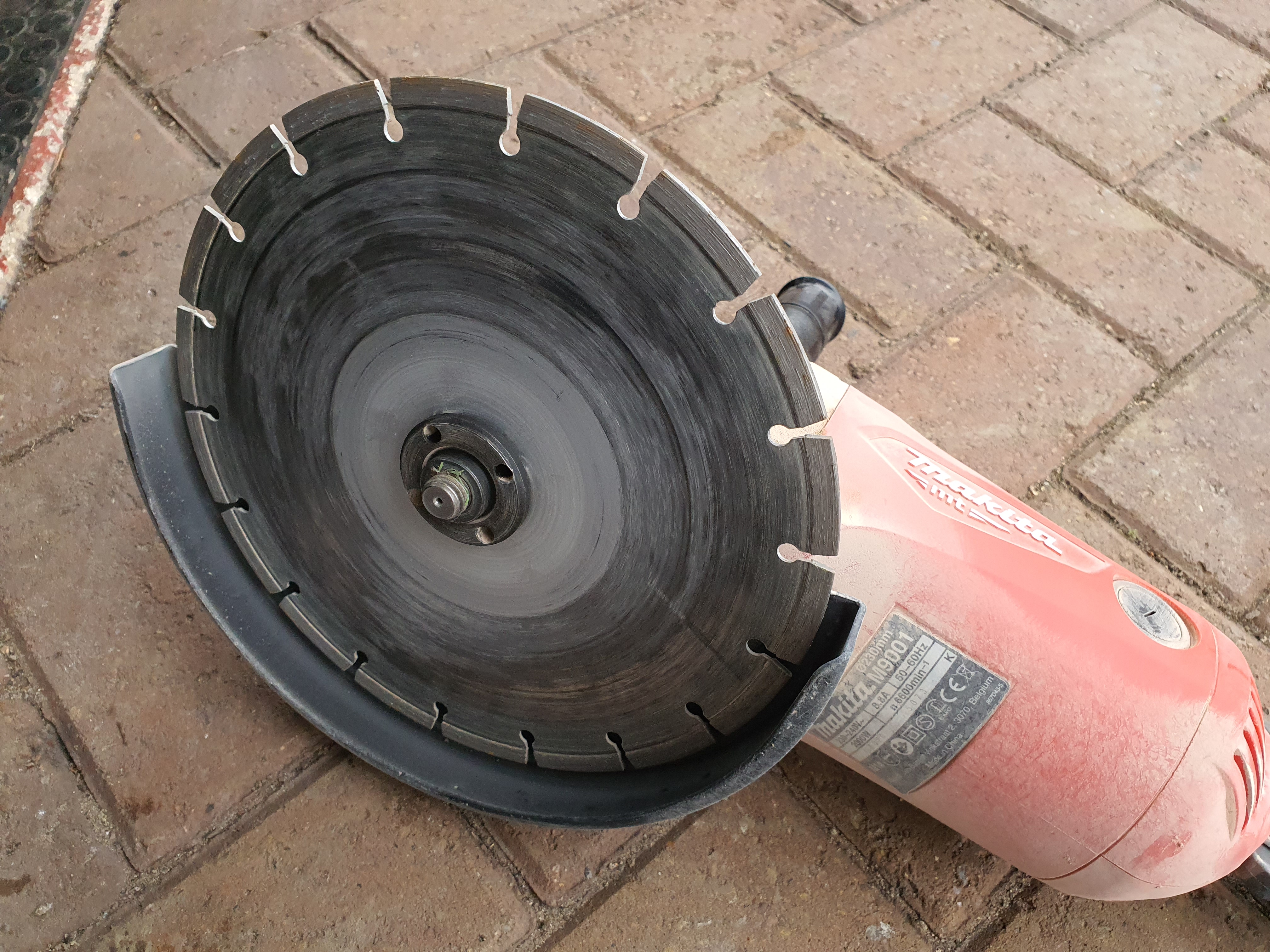

This thing has been great, a no frills, 9" Makita angle grinder combined with a cheap sintered diamond blade. Both from Amazon. Made the cutting very easy! :+1:

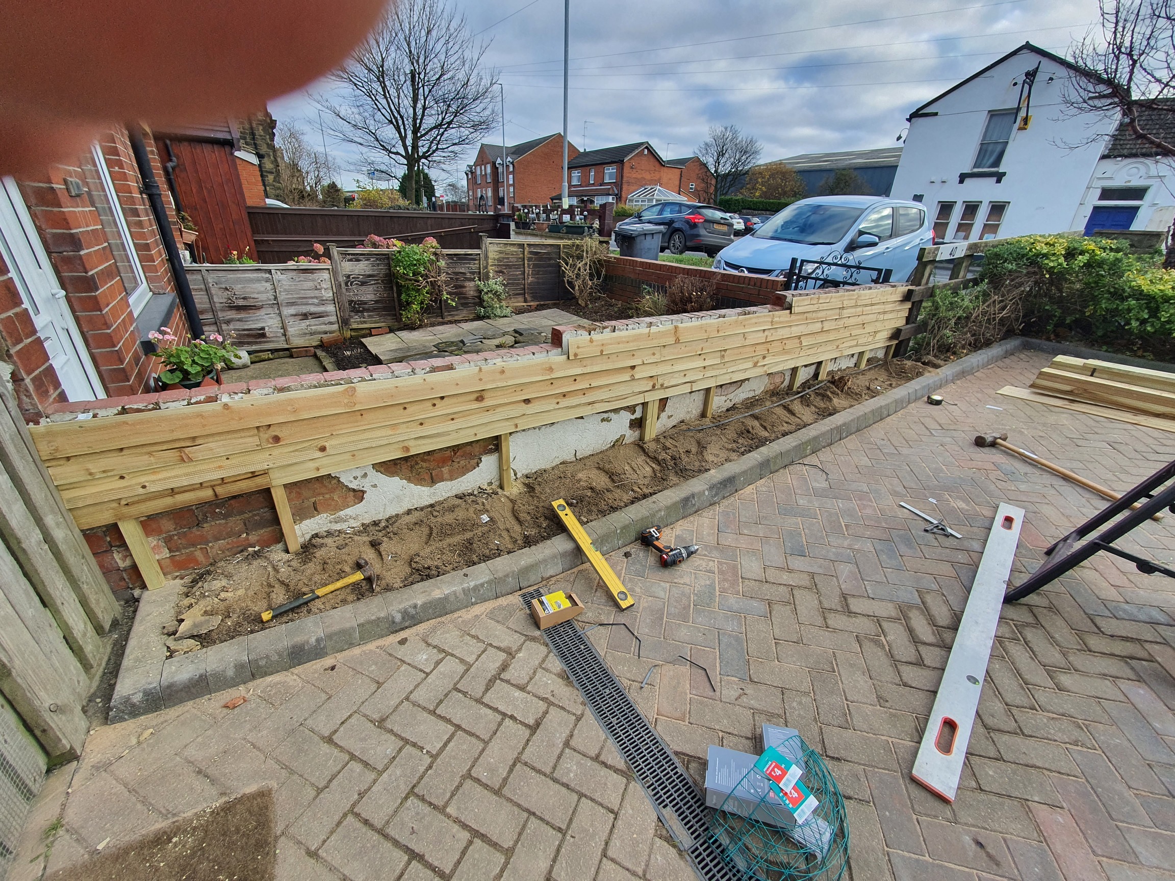

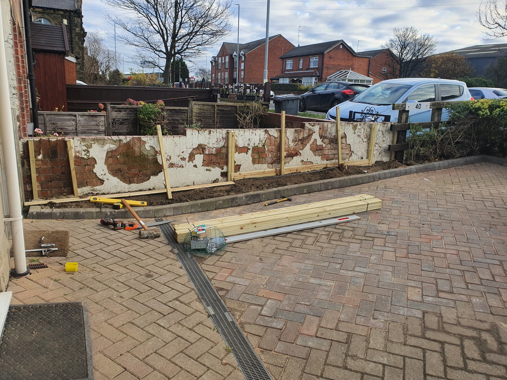

Never one to slow down, I’ve done bit more to the new paved area, well, the adjacent wall at least. The wall belongs to my neighbour, who has no interest or intention to tidy it up.
I removed all the loose render (which didn’t take a lot of doing, and it ended up looking like this.
I went to buy some masonry paint but the brickwork is class B engineering bricks with extremely low porosity, so the paint isn’t really suitable :thinking:
Back to the drawing board and I decided to clad it with treated feather board. I needed to make frames to hold the cladding so drove posts down the face of the wall into the ground and secured them near the top with a single fixing drilled into the wall.

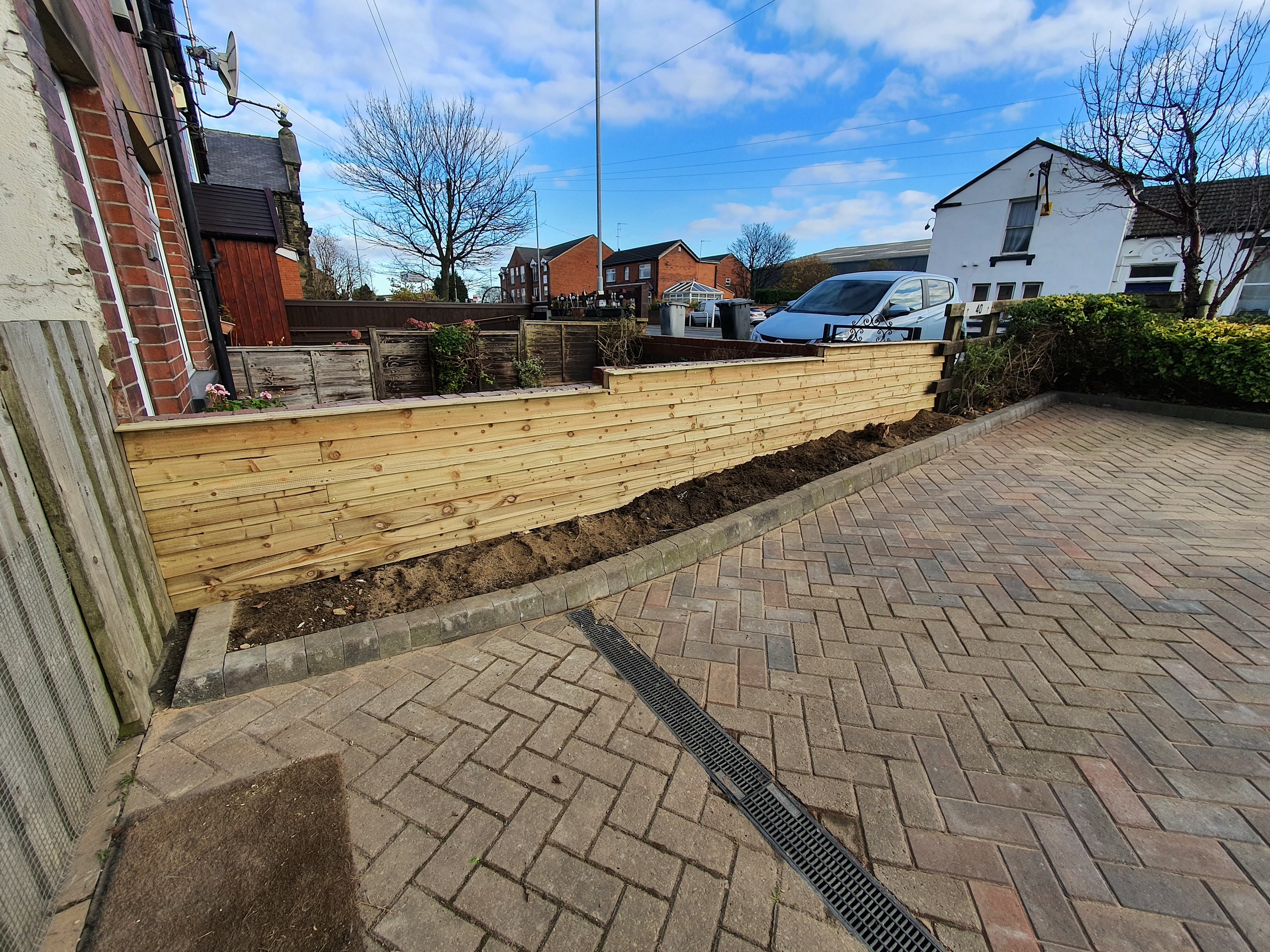

Once all these were fixed and correctly spaced to accommodate the cladding, I started to fix the boards into position, staggering the vertical joints on alternate rows.
The end result is this!
It’s certainly tidied it all up. Bought a load of bulbs to put in and a few plants also. Mrs B will sort that over the weekend hopefully! :wink:

That looks a lot better Barrie .:+1:
