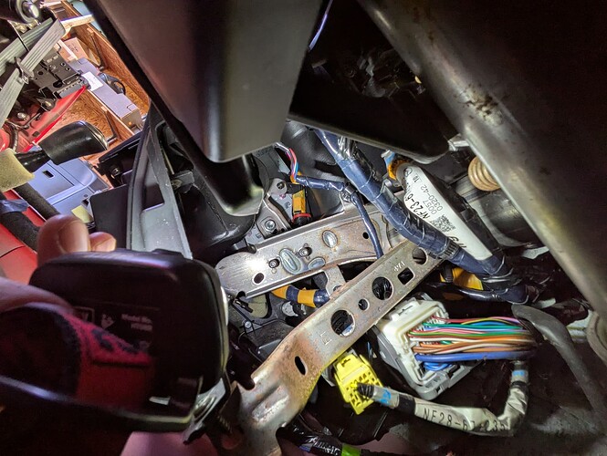

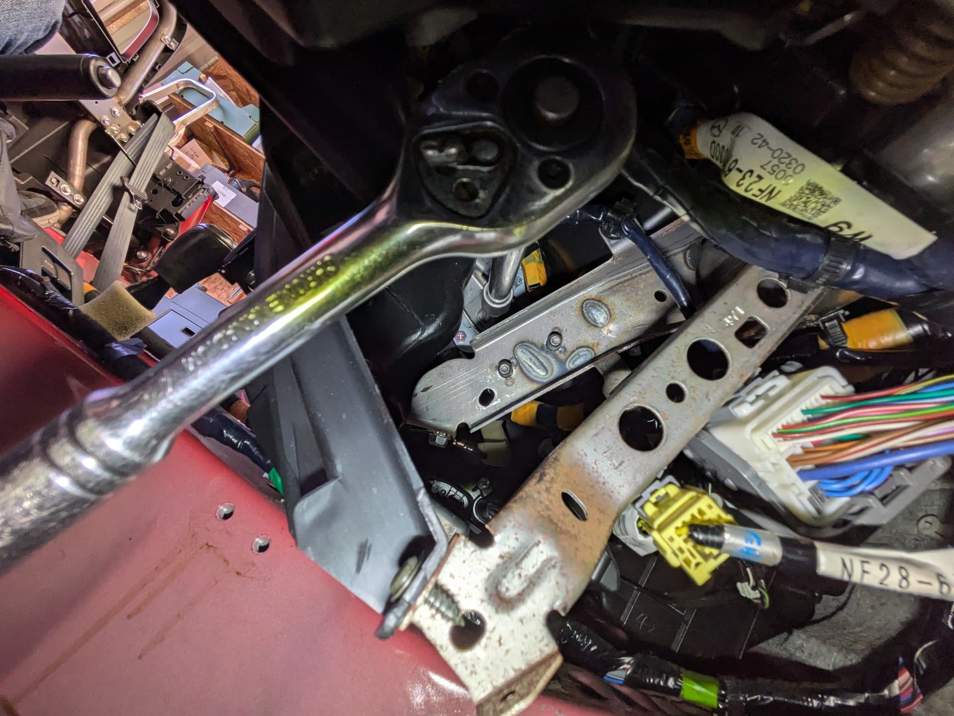

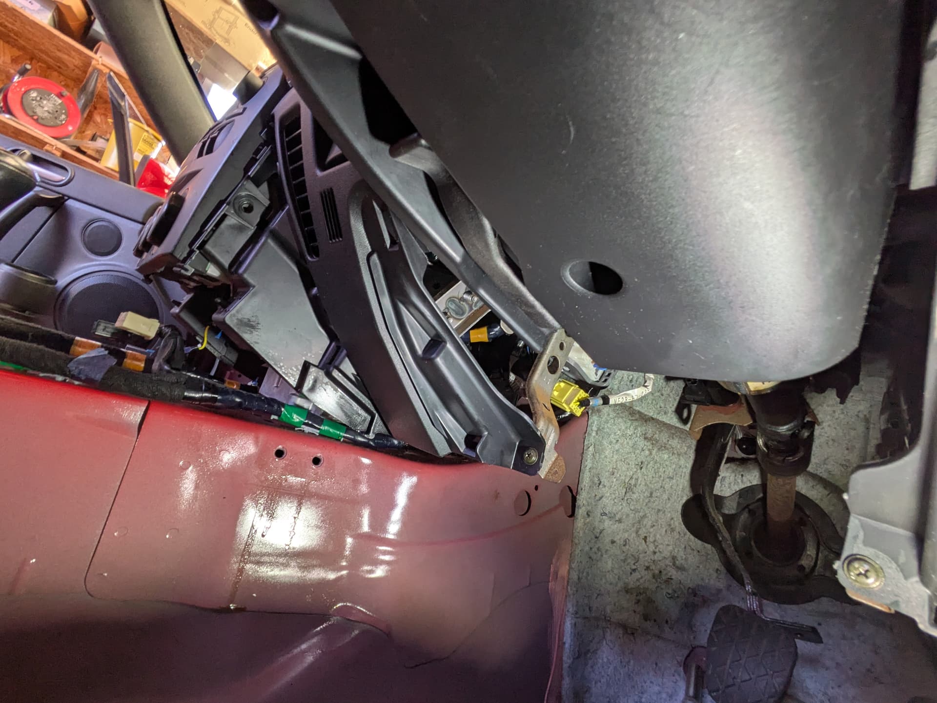

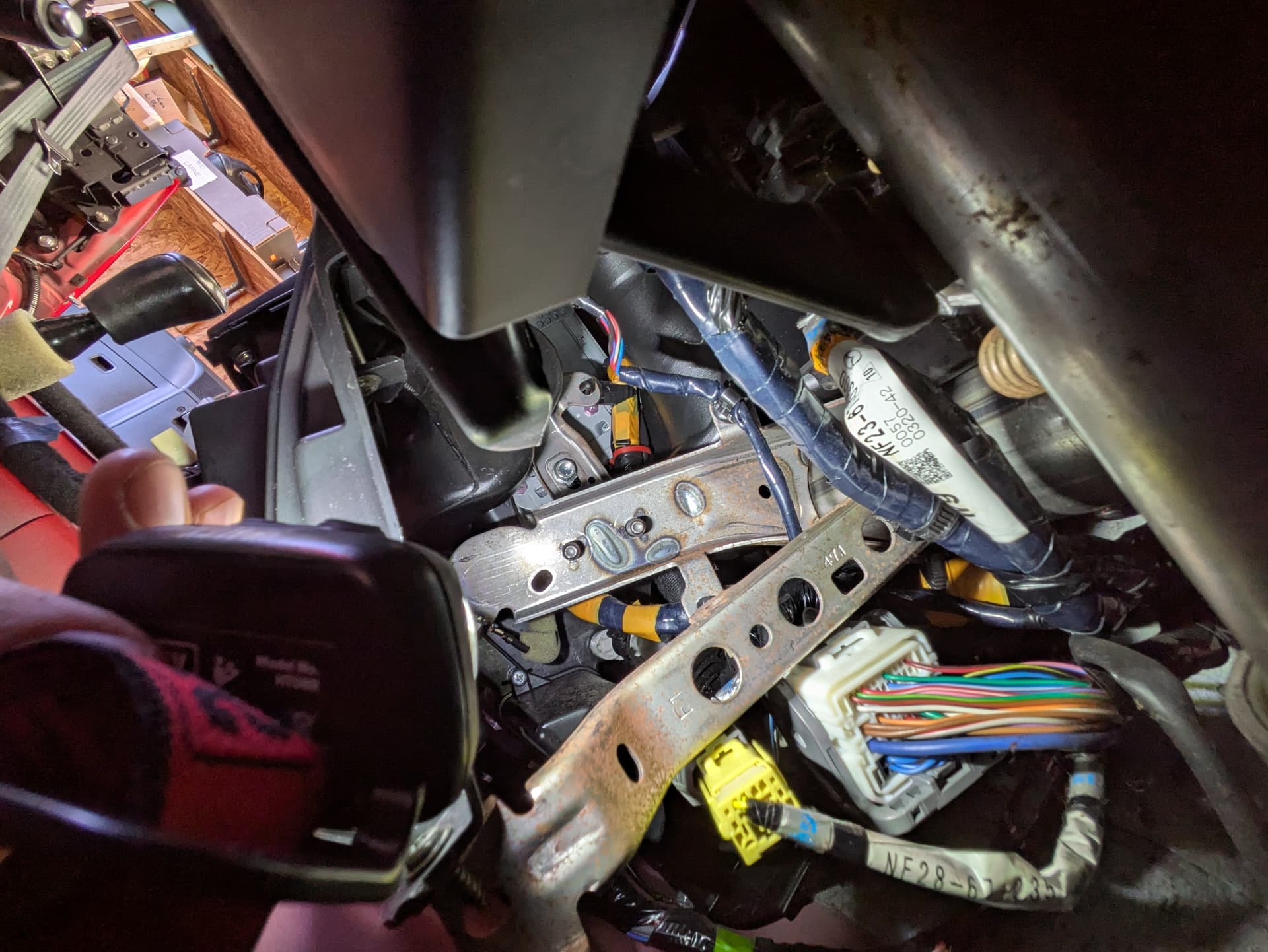

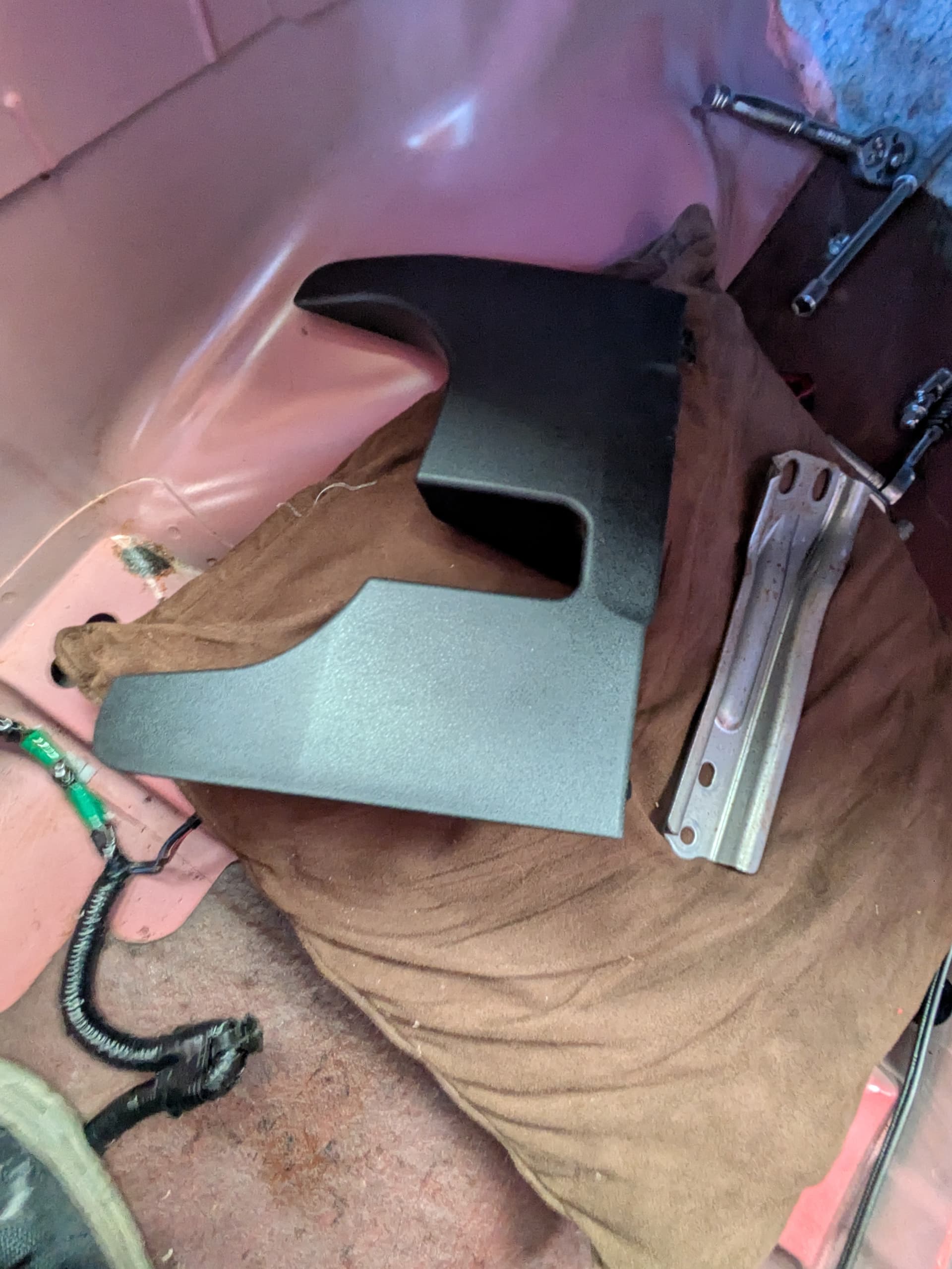

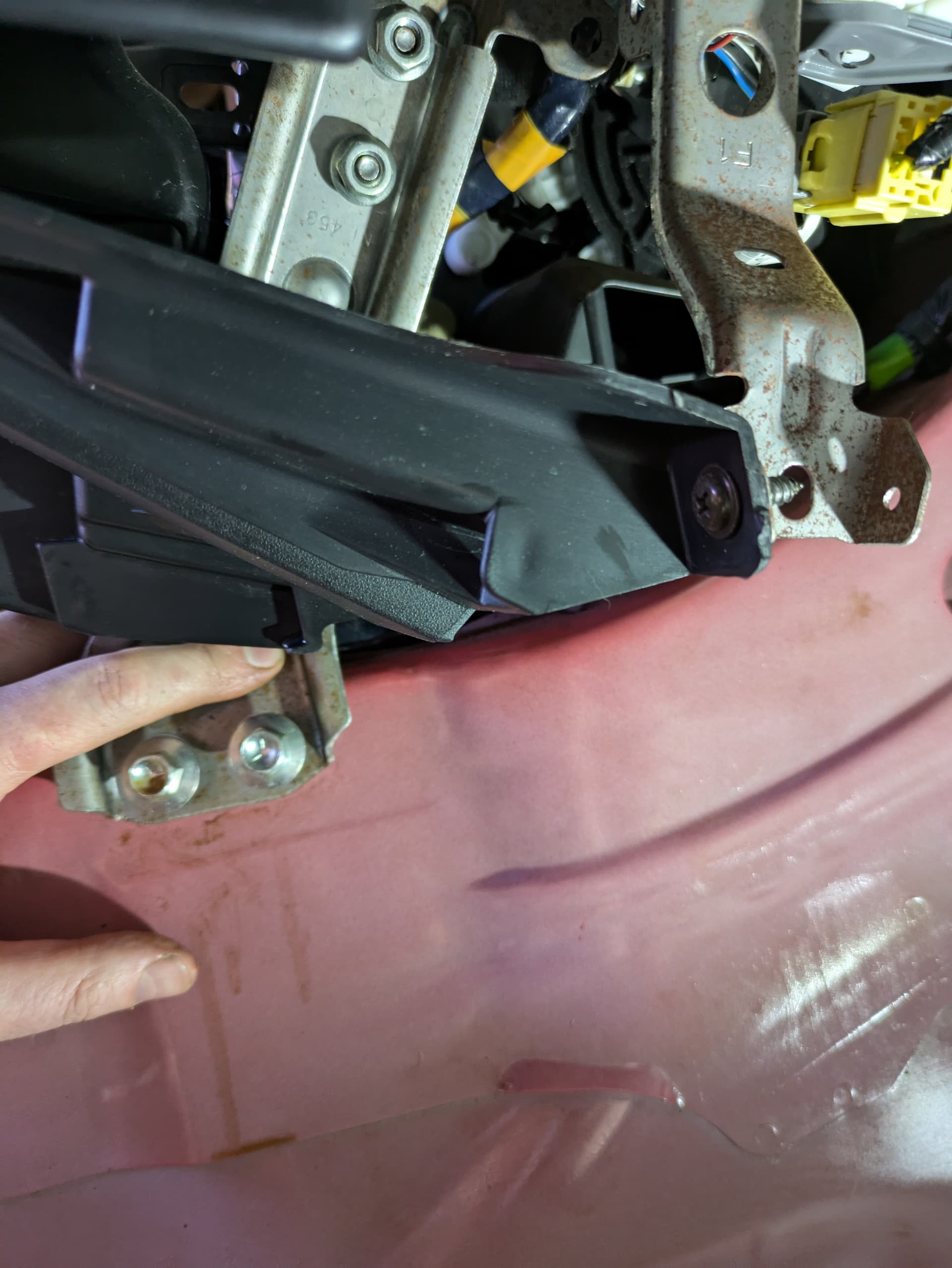

I suggest remove plastic cowel and the metal support - then a long attachment to reach the bolt!
remove metal bracket:
remove plastic cowel as well!:
now you can see the cursed bolt!
long reach and its out!
