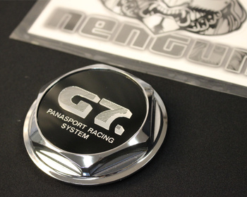

However, I’m having an issue finding Panasoprt center caps…amy have to resort temporaily to generic rubbish as 60mm are hard to find.
Sorry for hi-jacking the thread OP.
Have you contacted Panasport Europe, which if you google, is a UK firm. They won’t be cheap though!
60mm ones here:
If yours are 60mm centre bore, then they are certainly aftermarket, and possibly were fitted previously to a different car. 60mm is the common Panasport centre bore size.
Yes I did.  I thought almost £400.00…for caps was a tad prohibitive though
Unless you have 4 sets of wheels, the price Nengun want is based on a set of 4, not each.
Ah!
Online senior moment…
