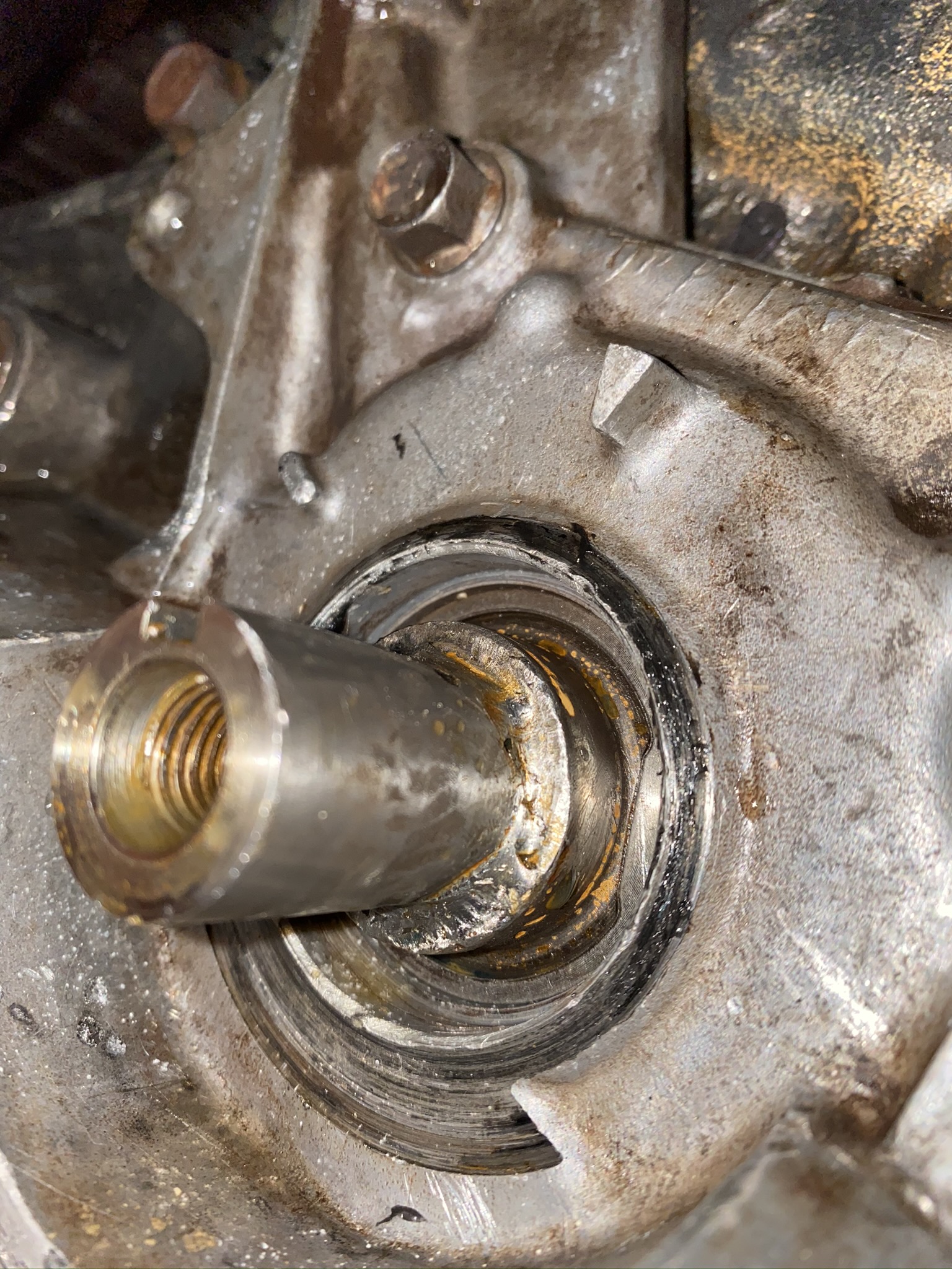

Hi all,
I had a problem while driving my Mk1 the other week. The engine cut out and when I pulled over and lifted the bonnet the crankshaft pulley was laying ion the undertray. The front of the crankshaft had snapped off due to the bolt coming loose. I have made a new extended nose and welded it on to the crankshaft but now need a new 4 slot pulley and can’t find one. Help needed please.
