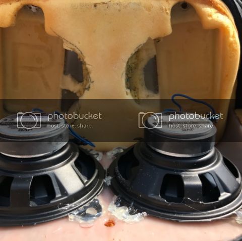

You will find the paper has disintegrated. I replaced them (there are two in each headrest) with 2 x 4" speakers and had to carve a bit of the foam out to get them a tight fit. The seat cover keeps them snugly in place but I added some hot glue gun to them as well.

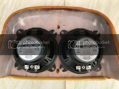

This shows how the speakers will fit on the “lid” inside the headrest. As you can see, there is just enough room for the two 4" speakers to fit side-by-side. I did not want to have anything sharp in the headrest, so did not use screws or bolts or anything that could impact with my skull in an accident - out came the new glue gun - it takes 2 and a half glue sticks for the job, by the way.
Speakers positioned on the lid.
IMG_0145
IMG_0148
The connectors on the original wiring were identical to the tags on the speaker, one small and one large female spade connectors, so no rewiring required.
