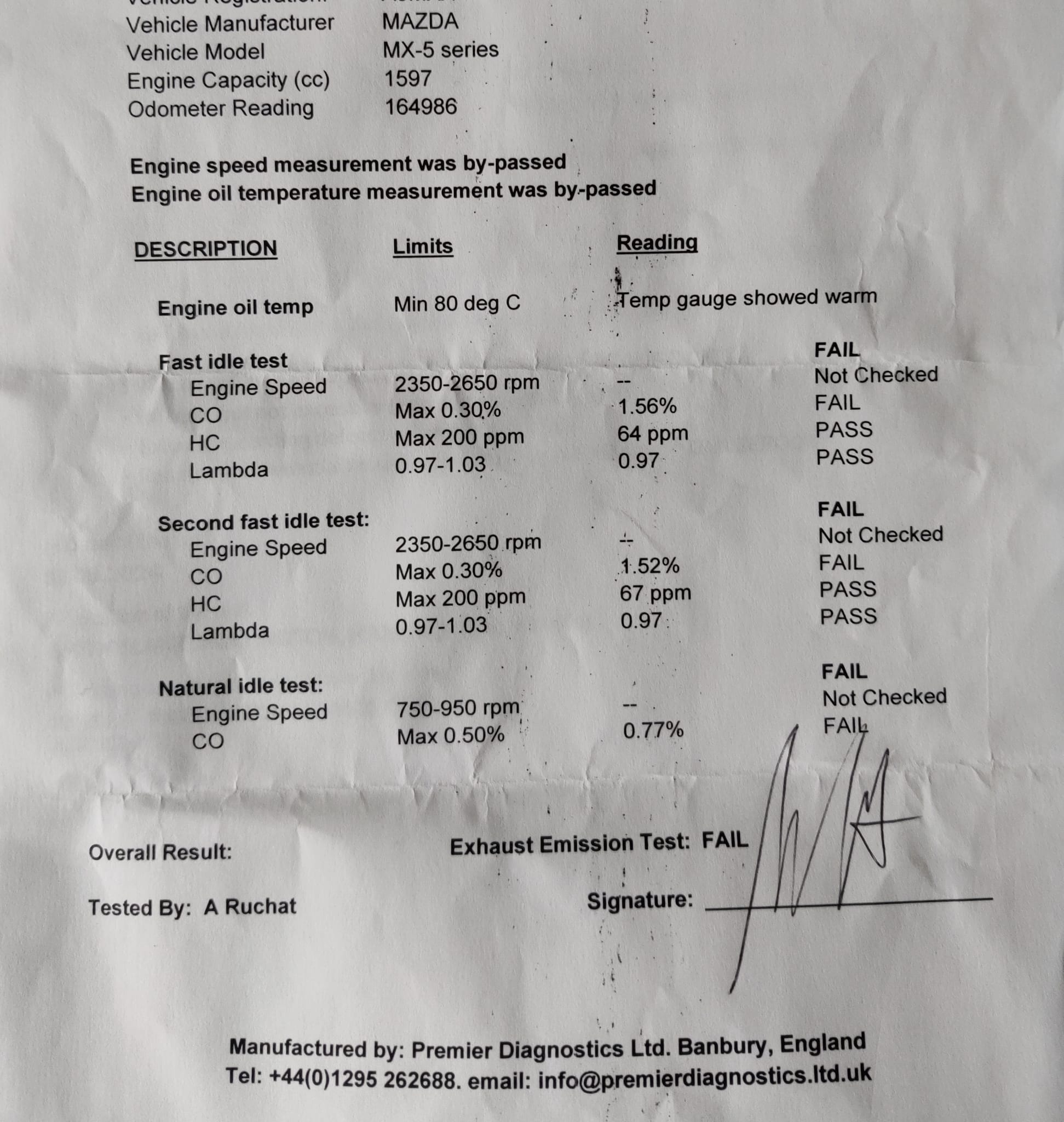

Took my mk1 mx5 for MOT and it failed on emissions on CO only, averaging 1.54%. HC and Lambda both passed easy. I’ve read that imports are tested at 3.5% CO instead of 0.30%, but the goalposts move often, so is that still true? MOT tester was adamant that that wasn’t the case.
Ran it on E5 for a week and drove it for 30 mins before I brought it to the test centre to warm it up. What else can I try to get the CO down?

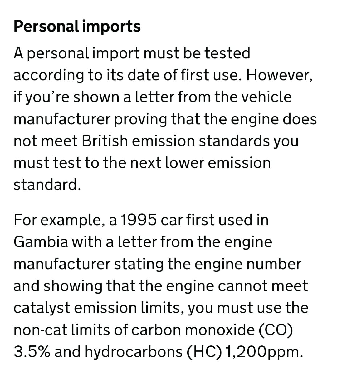

MOT guide mentions the need for a letter from the vehicle manufacture? What’s that about? Is that a formality, or do i actually need to find myself a letter to present to a tester?
Have a read of this, take it back and present the flow chart to him/her. Contact dvsa if necessary as they are very helpful and will send you a confirmation email too.

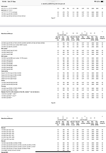

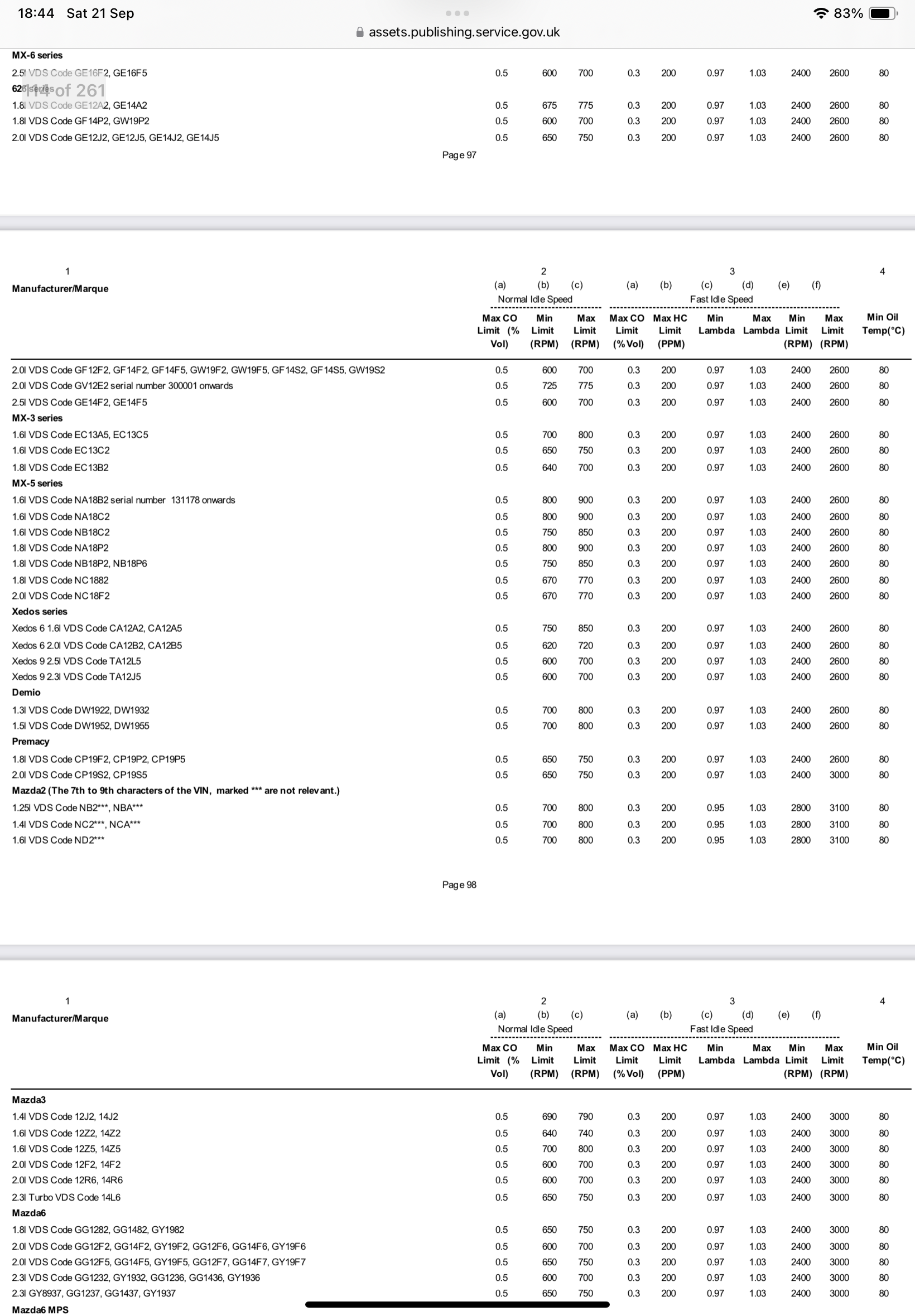

The mot tester needs to look up the chassis number in the annex of the mot guidelines. NA6-CE IS NOT LISTED.

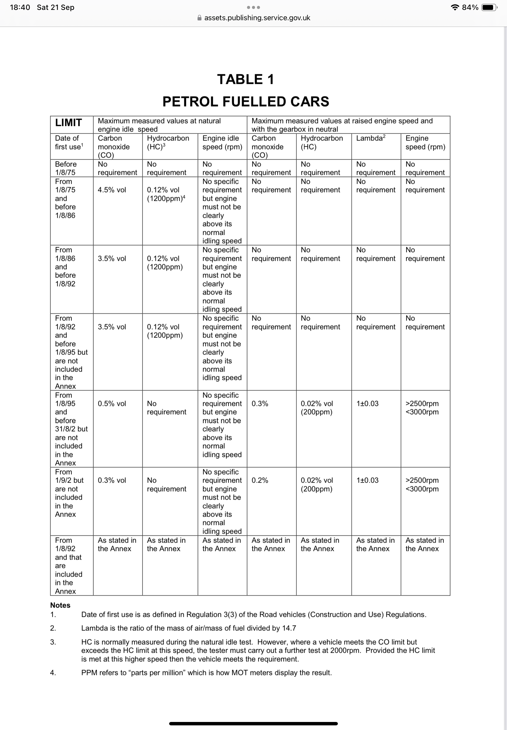

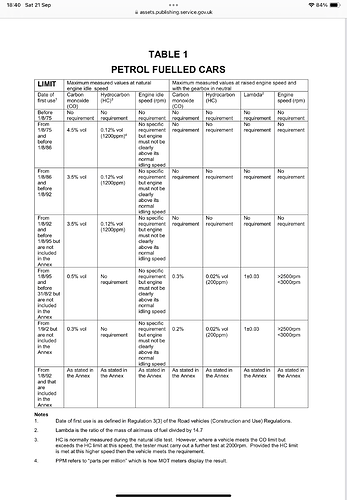

This means he should be testing according to the idle test for cars first registered before August 1992. NOT the FAST IDLE test. https://assets.publishing.service.gov.uk/media/5a81bcf5ed915d74e6233d90/in-service-exhaust-emission-standards-for-road-vehicles-19th-edition.pdf
Your Tester is not doing the test correctly your Eunos Roadster should have a basic emmision test as it has no data in the UK Mot Testers Manual.
I used to take a copy of the relevent part showing the flow diagram when I had my car tested. The engine needs to be really hot as well.
Actually as the car is pre August 1992, it needs the Standard Emissions Test. Not the Basic Emissions Test. That means it is only tested on idle. Not “Fast Idle.”

I don’t like to be a ‘negative Nigel’, but I tried this course of action last year, my Eunos is registered as an MX-5.
The only way to get your V5 changed (and the details changed when your tester logs in to the DVSA MOT test data) is to get a letter from the car manufacturer.
Mazda UK cannot help (or couldn’t help me), as the chassis number is not a UK number.
You need Mazda Japan, but as a non-Japanese speaker I couldn’t get on with their website (international calls are not an option on my mobile contract).

As other people have commented, the MoT tester is testing to a later standard because the system has selected a later model MX-5 as your VIN is not recognised.
Are you testing at the same MoT station as previous years? If not, go back to the one you used previously as the test system there is capable of recognising you have a pre-cat car. If you are using your regular test station, then you need the paperwork to show what spec. the test should be conducted to.
It is very unlikely that any amount of combustion chamber cleaning can get the CO emissions down to the level for the later test.
Note that the MoT emissions test is intended to check that the engine on the car complies with the emissions standard in place when the engine was built - so it might be worth asking the test station to search for the engine number, but this might be difficult as it is a personal import.
