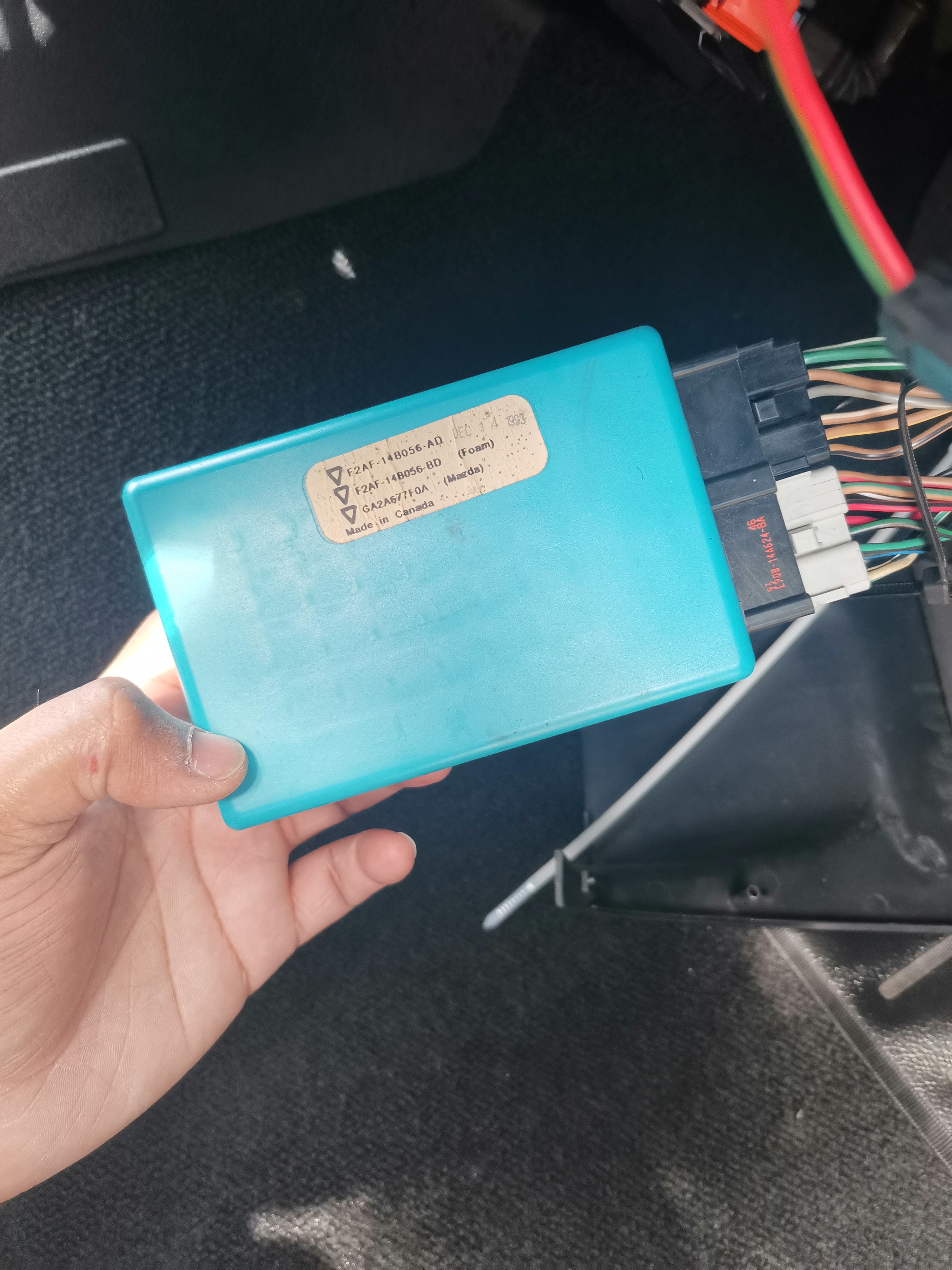

I presume that this is the fault diagnosis module?
Yep, that looks like the early type, did you slide it off the bracket and leave the bracket in place?
I did, it that not the right way to take it off? :confused:
Saves removing the dash :+1:t2:

When I removed it to get the parts numbers, I got a little bit worried that I got it out so easily after reading everywhere that it requires taking off the dash :joy:
