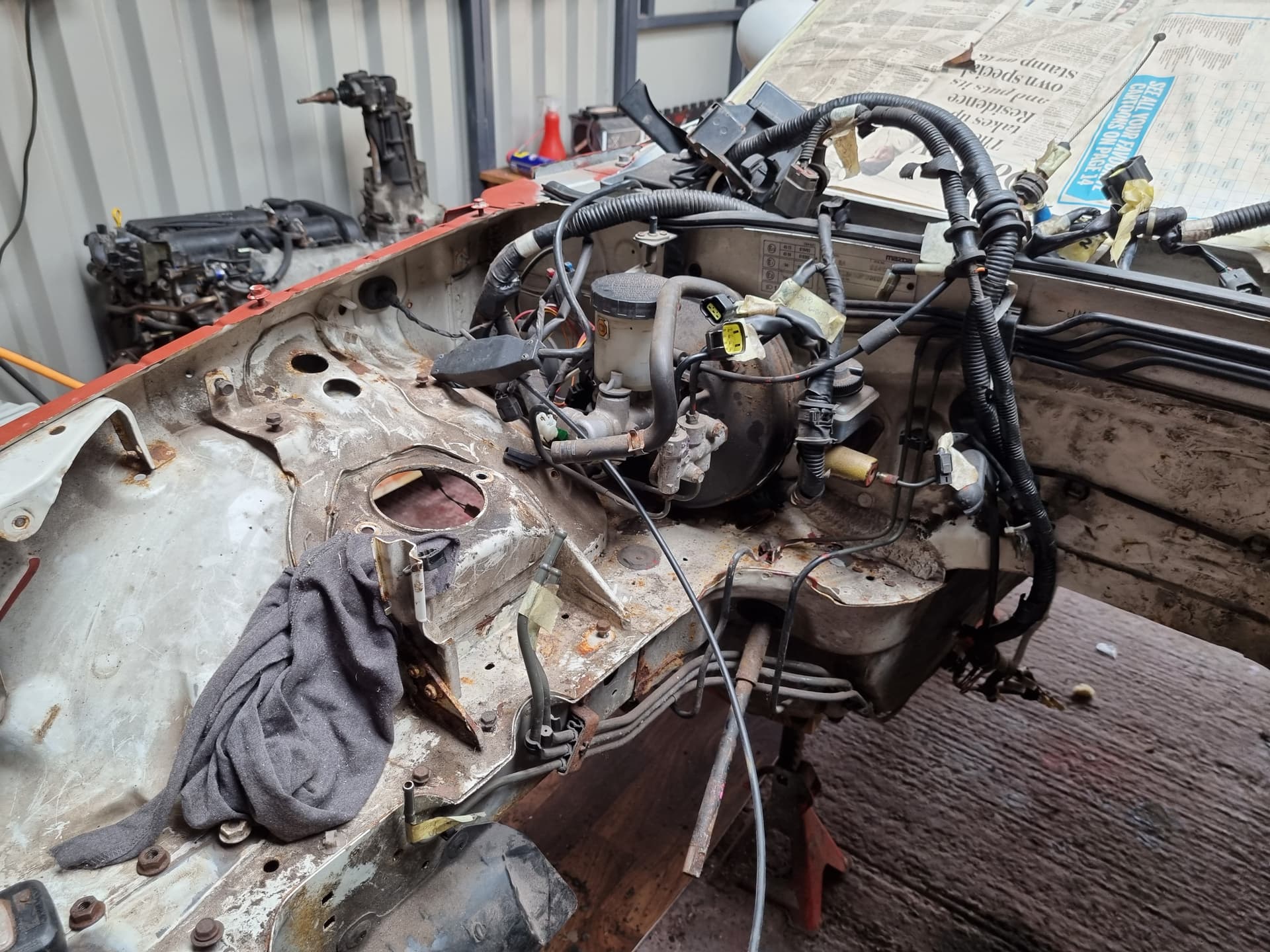

Since June, i have removed the engine and gearbox and mounted the car on the spit.
Its been much easier to remove all the crud from underneath.
Thankfully, no more rust other than a small piece at the bottom of the sill end plate again.

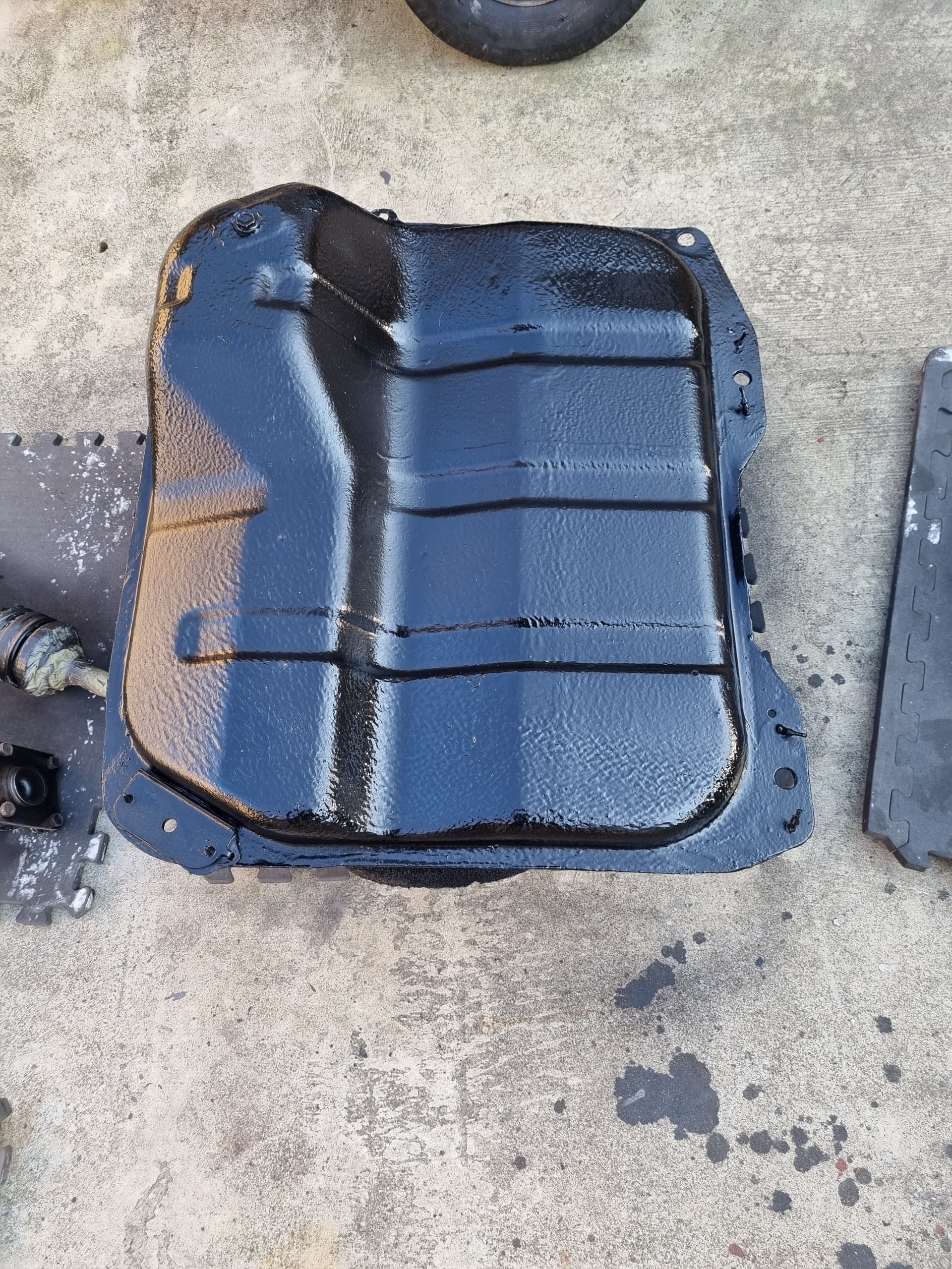

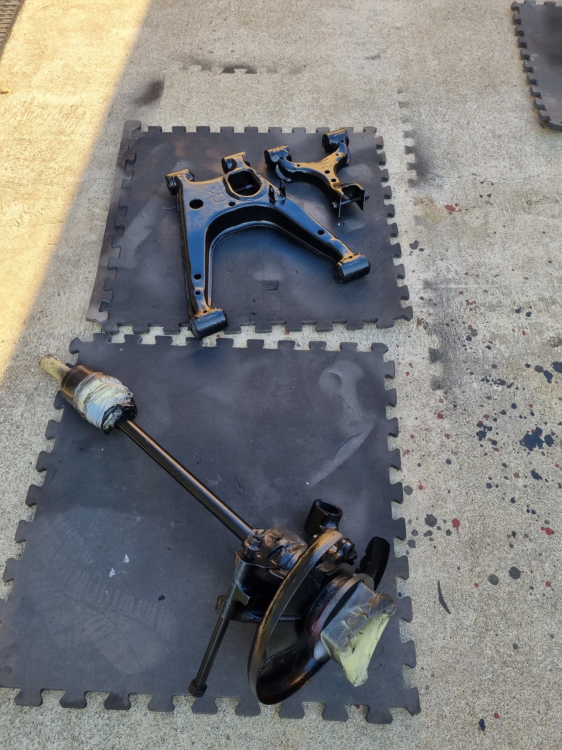

I then dug out the rear subframe and suspension arms that I’d rebushed last year with IL motorsport fast road bushings. Gave them another coat of satin black so that’s all ready to refit now.
1st thing though is to refit the fuel tank and fit the new fuel filter.
