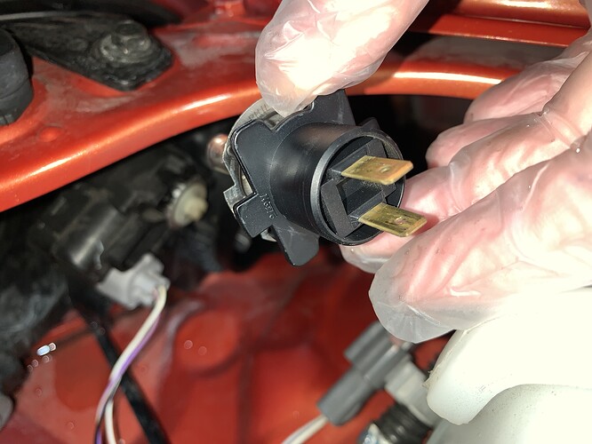

In the pic below you can see the new bulb has a 3 prong fitting but the existing ones have only 2 prongs. I thought it was something to do with the adpater at first but even remnmoving that they appear to be completely different…or am I missing something?
Original bulb shown with adapter removed

The clue here is on the removed bulb. It says H7 which is a twin prong lamp.

There is a cut-off VIN number for these, assuming we are discussing the outer dipped beam bulbs. The three pin H4 fits cars with a VIN number where the last six digits are less than 413680, typically up to 2005 manufacture date, NOT registration date. The H7 took over at the end of the MK2.5 run and was used in the MK3 car as well.
I think the confusion with your car is manufacture date versus registration date ie 2004 manufactured but registered 2005. If its a ‘55’ plate rather than ‘54’ or ‘05’ plate would confirm.

Yes very confusing, here is my reference. Your VIN appears to be some way further forward into H7 territory, not even close to the cut-off VIN number.
The point is that these are not interchangeable so you will need an H4 bulb rated at the correct wattage for your application.

Aahhh, with it now, I they sent you the older H4 with three pins:-)

Remove the electrical plug
Remove the rubber dust cap
Unhook the spring and the bulb and adapter can be pulled out
Pull the bulb and adapter apart
Press the new bulb in without touching the bulb surface. I wear gloves as an extra precaution.
You have to twizzle the bulb and holder about a bit until it pushes down into place. Once in place rehook the spring back under the tab.
Put the rubber seal back on giving a good and repeated press down not just round the outer edges but around the inner side of the seal too to go around the bulb.
