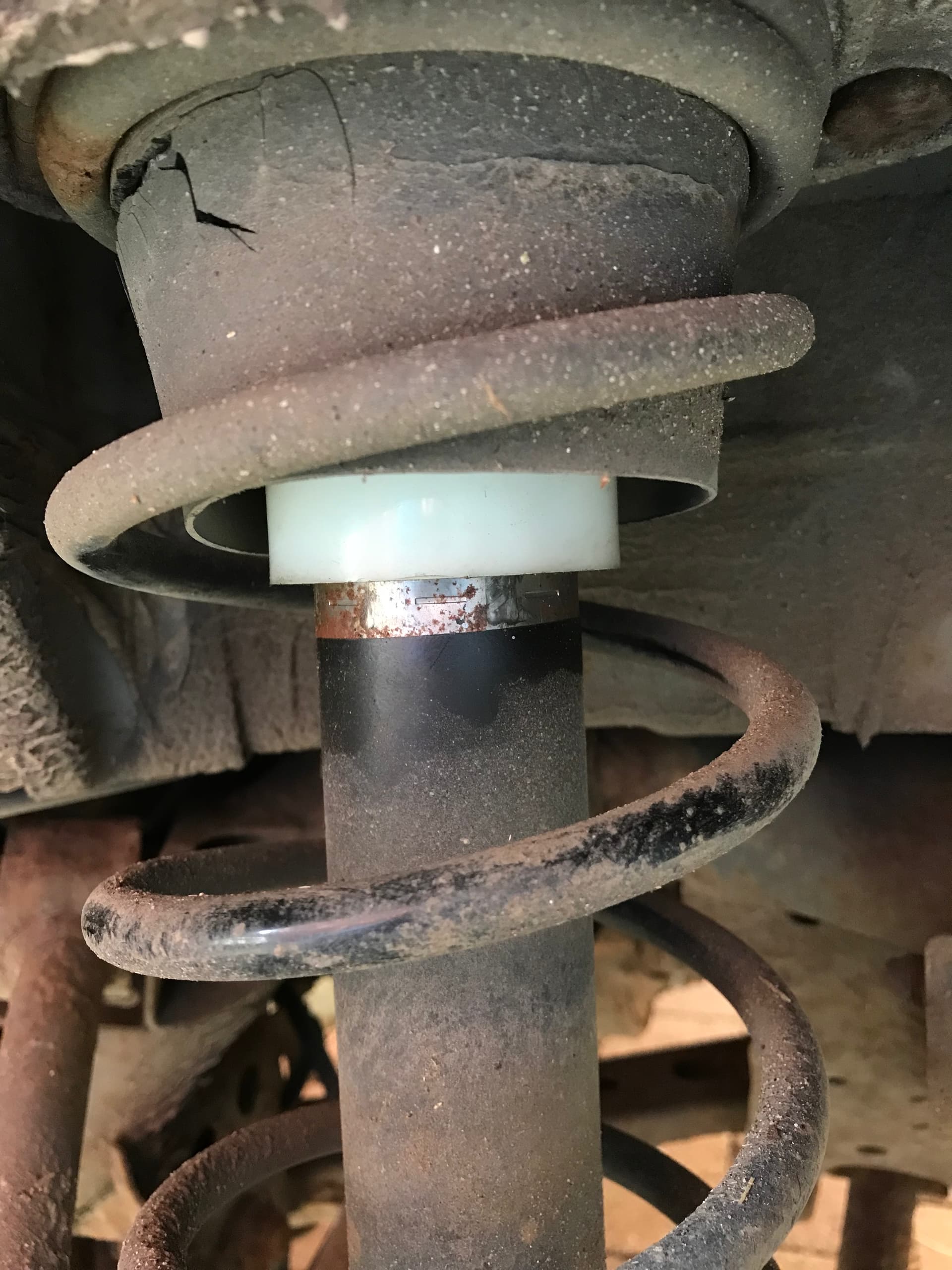

I traced mine (more of a jiggly rattle) to the plastic cover on a rear OE shock top (2008 NC), and thought I had fixed it, while also doing the drop links.
But after a happy trip up to Woodhall Spa this week (and NO distractions there from t’internet thanks to BT line fault), the rattle suddenly returned yesterday, when nearly home on a rough bit of road churned up by HS2 traffic. Sure enough it’s the other side now.
Oh well, at least I know what it is, and I can live with it until I have time to jack it up again.
This post by another member has a picture showing the problem part
