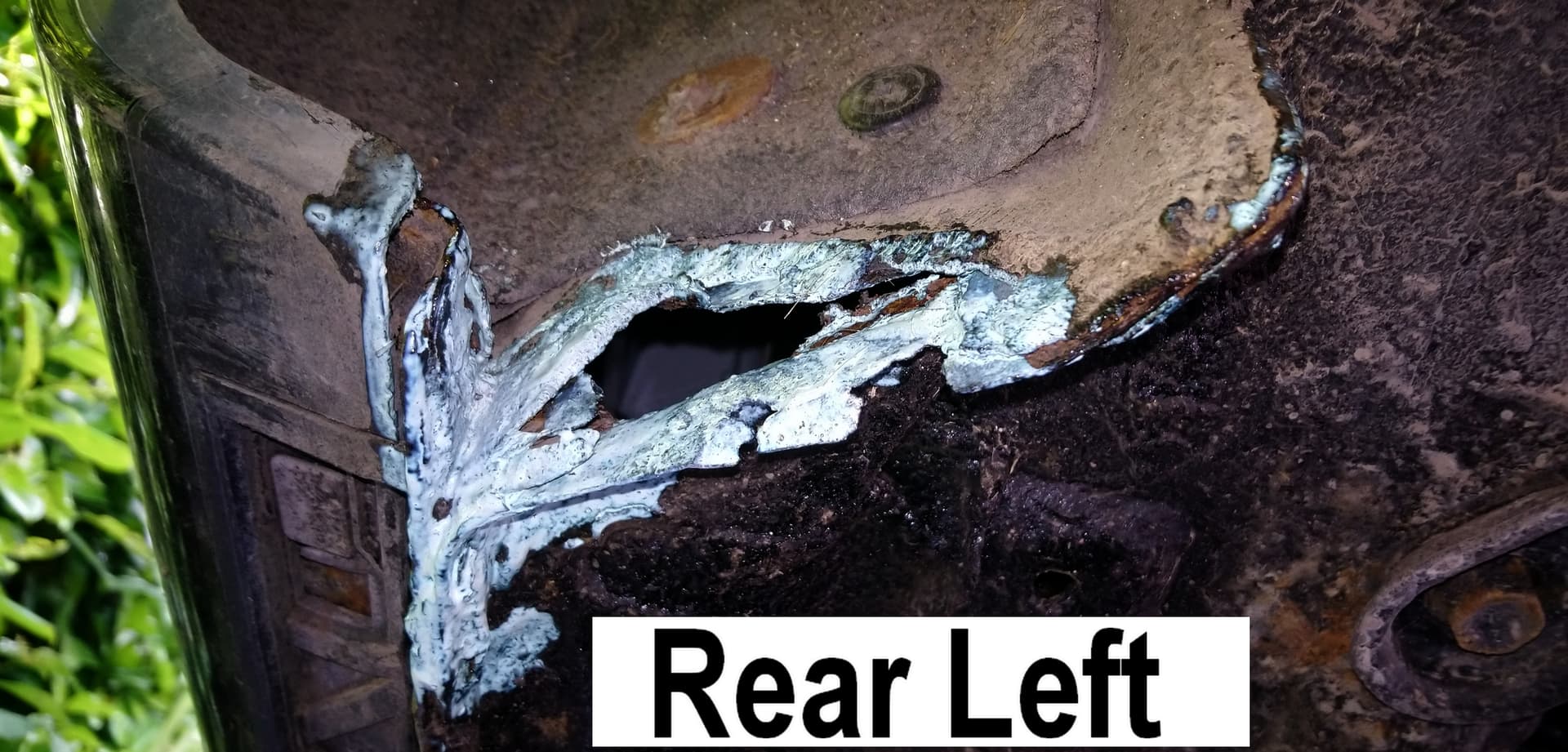

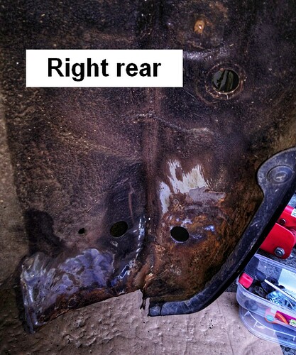

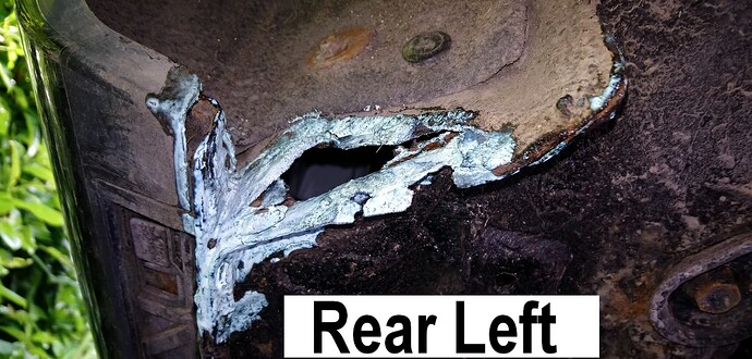

Rear wheel arch?
Take out the arch liner and it reveals 2 rubber bungs shown in picture 1.
If I remember there are more rubber bungs further up and around the wheel arch.
Also, picture 2 the screw/bolt holding the lower part of the arch liner goes into a plastic bung behind. Remove that (it pops out) revealing another access point for cavity wax.
I’d be inspecting inside first for corrosion, piling in copious amounts of wax on top of rust won’t really stop it, it’ll just hide it and most likely make it worse.

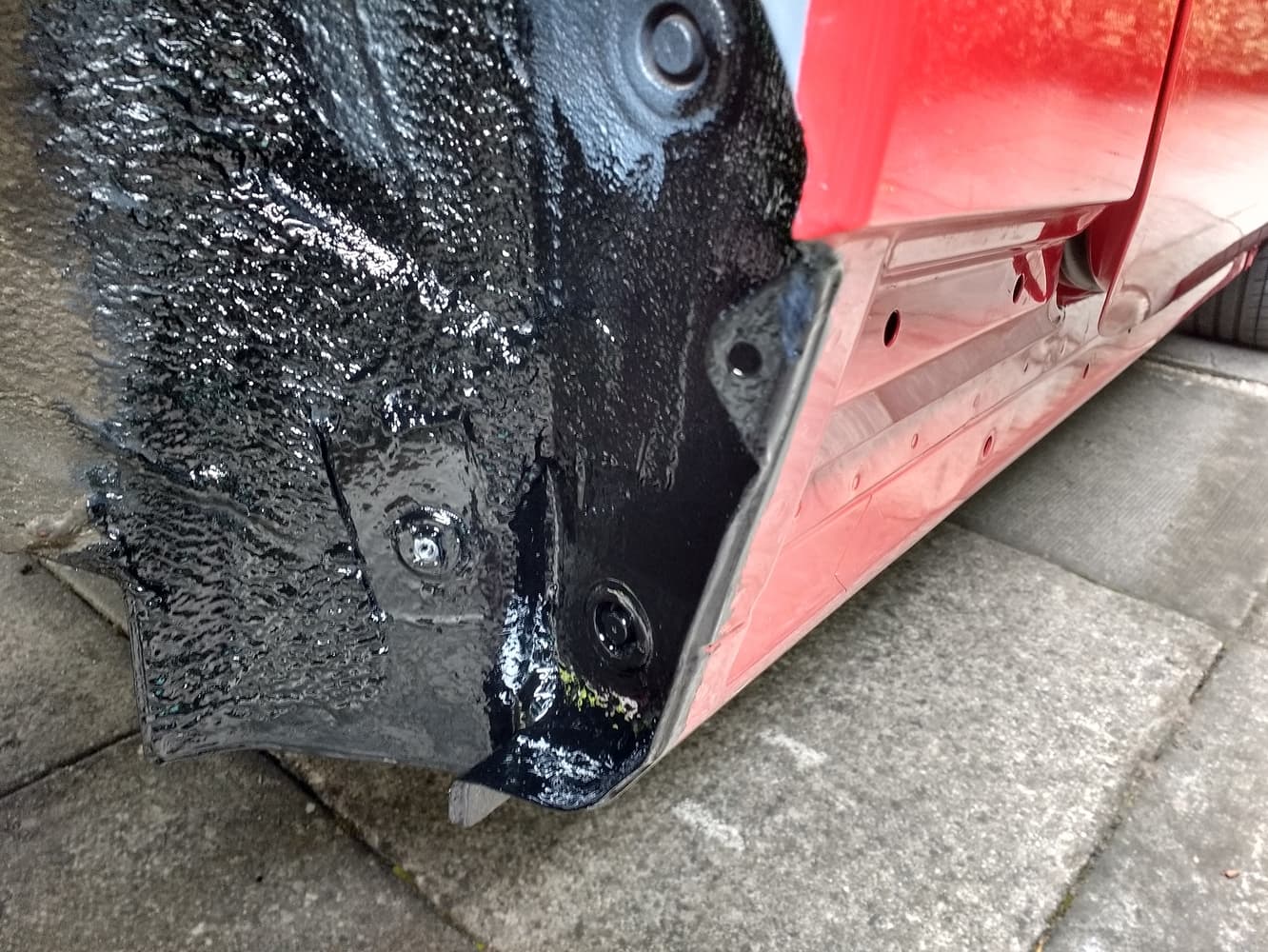

If you open the boot and remove all the trim you can gain very good access to the wheel arch areas. You can be very liberal with your application as any excess will drain to the sill area.
Whatever you use make sure it is very ‘runny’. Waxoil is particularly ‘gloopy’ straight from the tin so use white spirit to thin it down.
