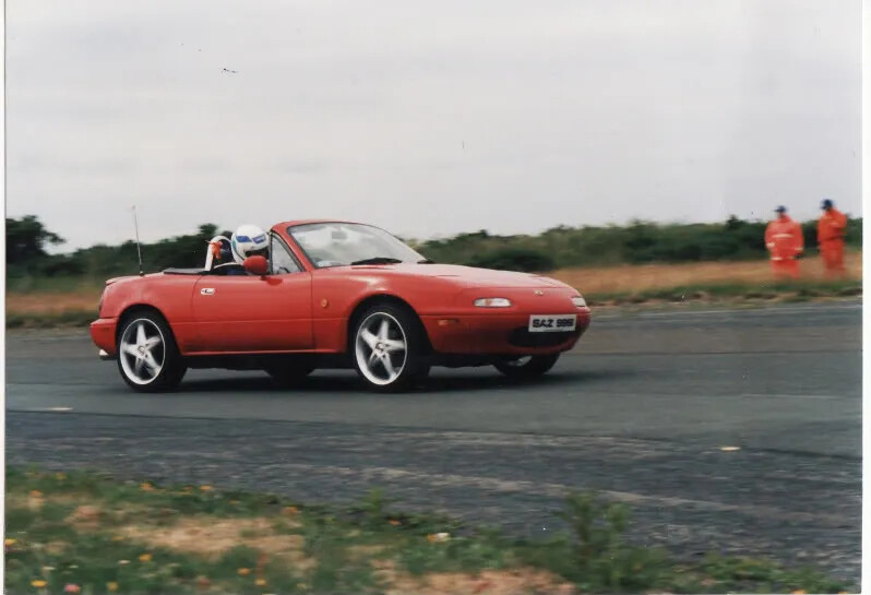

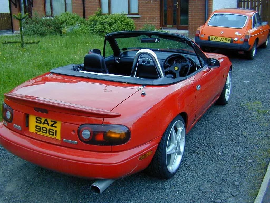

My experience of a 17" wheel, 205/40 tyre, on a Mk1, was pretty awful. The steering was heavy, the car was lowered, and the increased weight I think ruined the springs, causing sag.

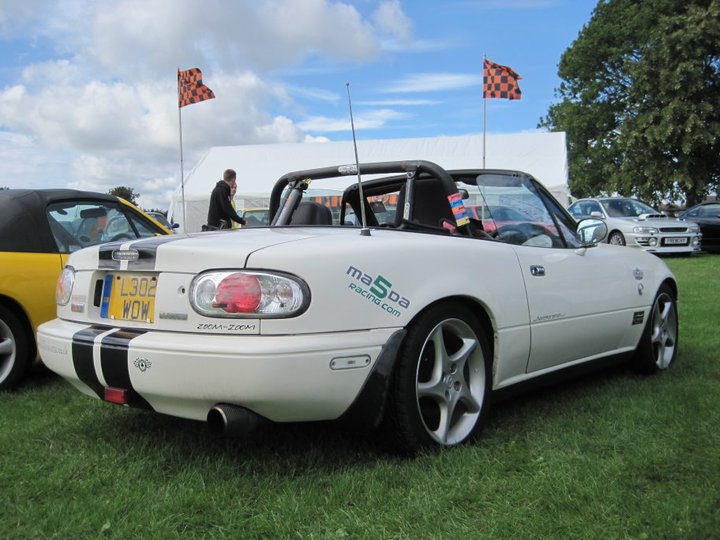

My experience of a Mk1 with the 16" Mk2 wheel is more limited, but my recollection is still heavier steering, and less wheel crash.
I suggest sticking with 15" wheels. The 16" offers no tangible benefit.
