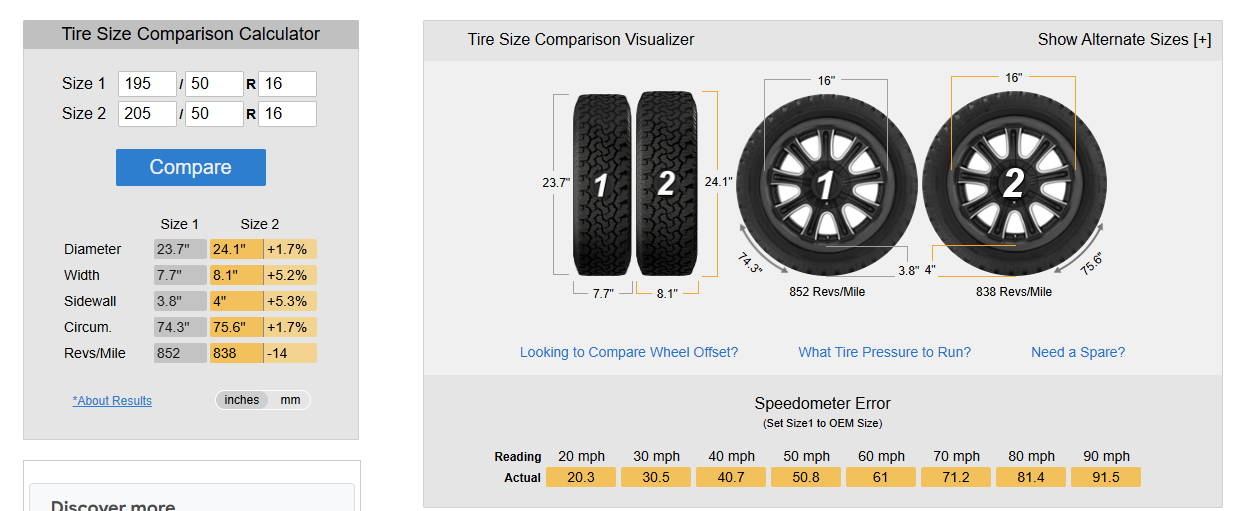

Hi, has anyone put 205/50 R16 tyres on an ND 1.5 instead of the standard 195/50 R16? The choices of 195/50 are quite limiting, a few more with 205/50. But does it cause a problem with rubbing with/without wheel spacers? How about speedo accuracy? I think 205/45 would be too low a profile for me - harder noisier ride?

You will impact the speedo reading by going for a taller tyre, but I’d wager the ND over-reads anyway.
