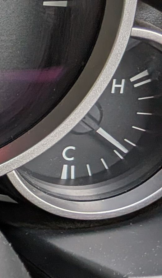

Take a look at your temp gauge, is it about 1/4 up, if so you need a new thermostat.

I think mine seems ok? Here is where it usually sits:

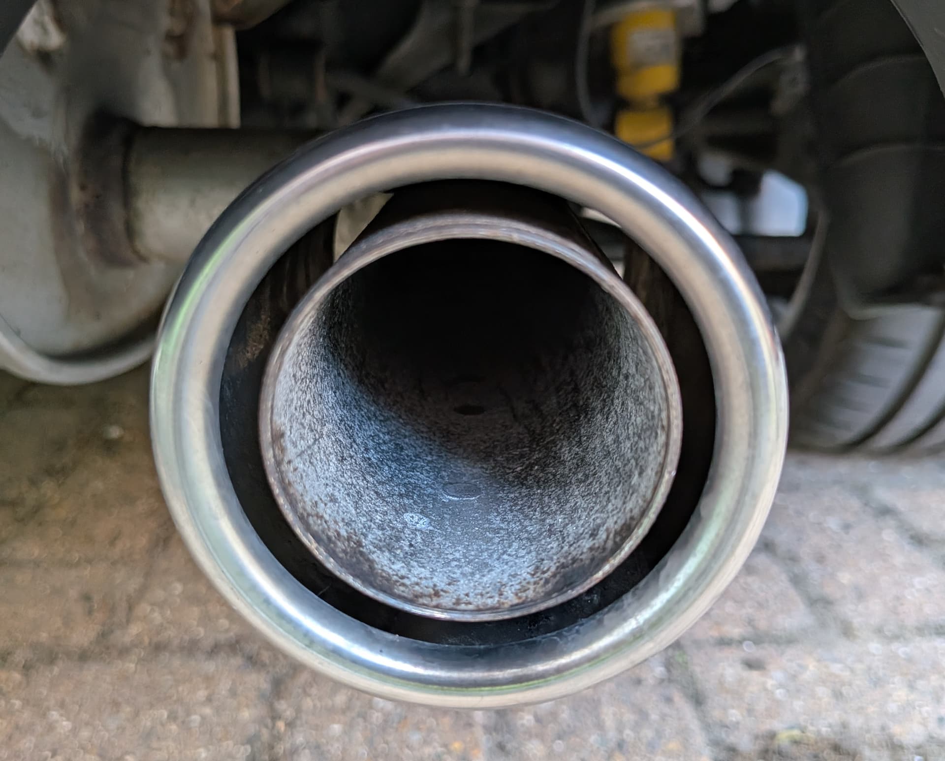

Thanks for sharing that link, unfortunately I washed the car a few days ago so the tips were cleaned, but I took a pic of the inside of the exhaust pipes and they seem clean, what do you think?:
Yeah that’s fair, I’d say 40% of the time was spent getting in and out of London.
No obvious problems showing inside the exhaust, it looks normal, so engine is probably OK.
