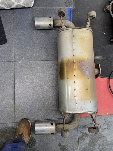

Exhaust removed to gain better access to underbody

Exhaust cleaned up :nerd_face:
The hangers and side pipes treated with rust killer :confused:
The heat burnt bit comes off pretty easily with metal Polish on a drill buffer I found - you can see where it was but it’s gone :+1:
