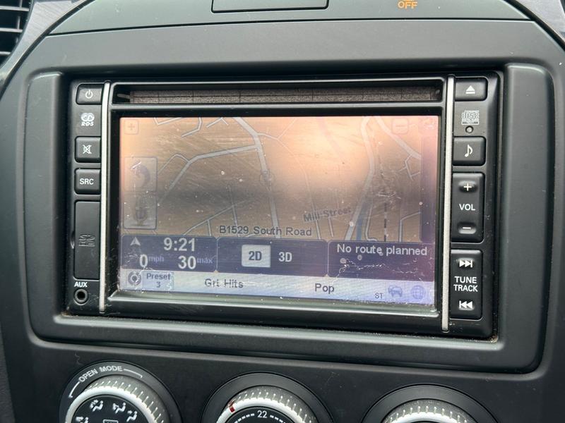

I currently have the Sanyo Tom Tom ICE, but I’m desperate to change it after living the last year with cables all over connecting my phone to the line in.

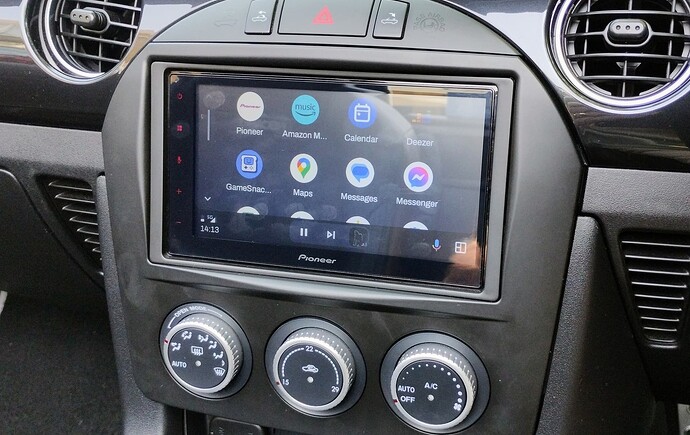

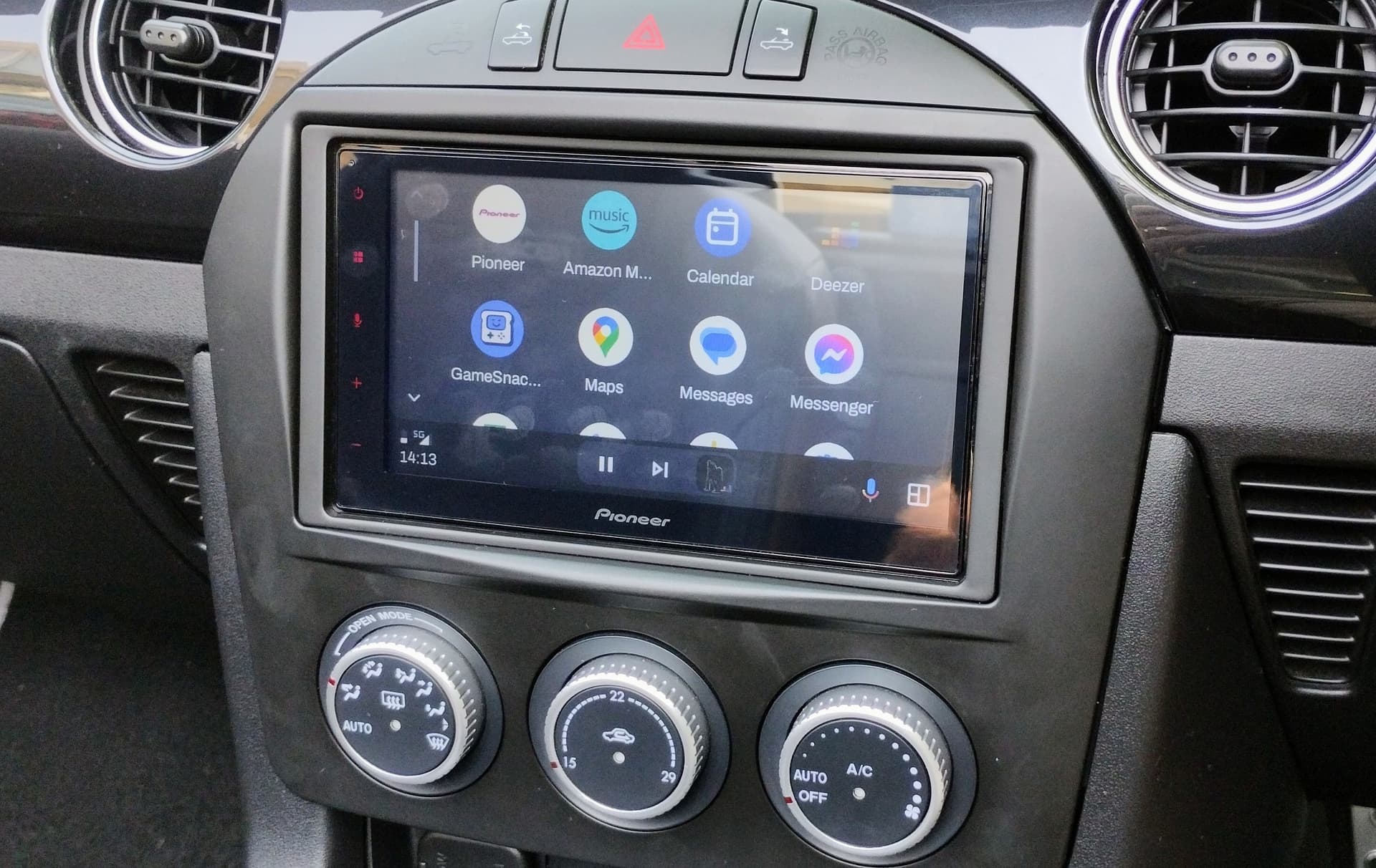

Just for info - the phone you see in my picture is in a Brodit Holder with a pro-clip.
It keeps the phone safe - charges it when in the cradle - and allows wired android auto.
I went this way because I found wireless android auto was eating the battery - you need the phone connected via bluetooth and wireless at the same time.
You’ll most likely need a facia adapter too, the Sanyo and Alpine nav units are fitted in a different size facia.
Also you’ll need to trace back down the loom behind the Sanyo unit (usually covered in a foam sheath) to the connection needed to link up that set of leads you link to.
Your unit
An aftermarket fitment, note the shape/size.
