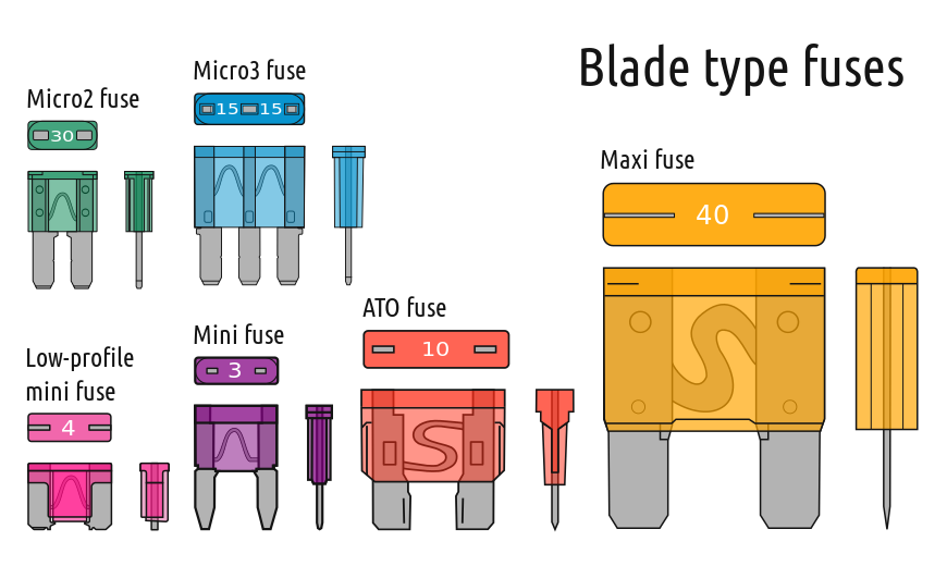

A J-type fuse is a specific squarish-shaped fuse. I don’t think that I’ve seen them used in the NC, which uses a mixture of Mini and Low Profile Mini blade fuses.
A Slow Blow fuse is one which will not trip for a transient current surge, but requires a sustained over-current situation to trip. The alternative is Fast Blow, which will trip with even a transient over-current situation. It’s important to use the correct fuse for the specific application.

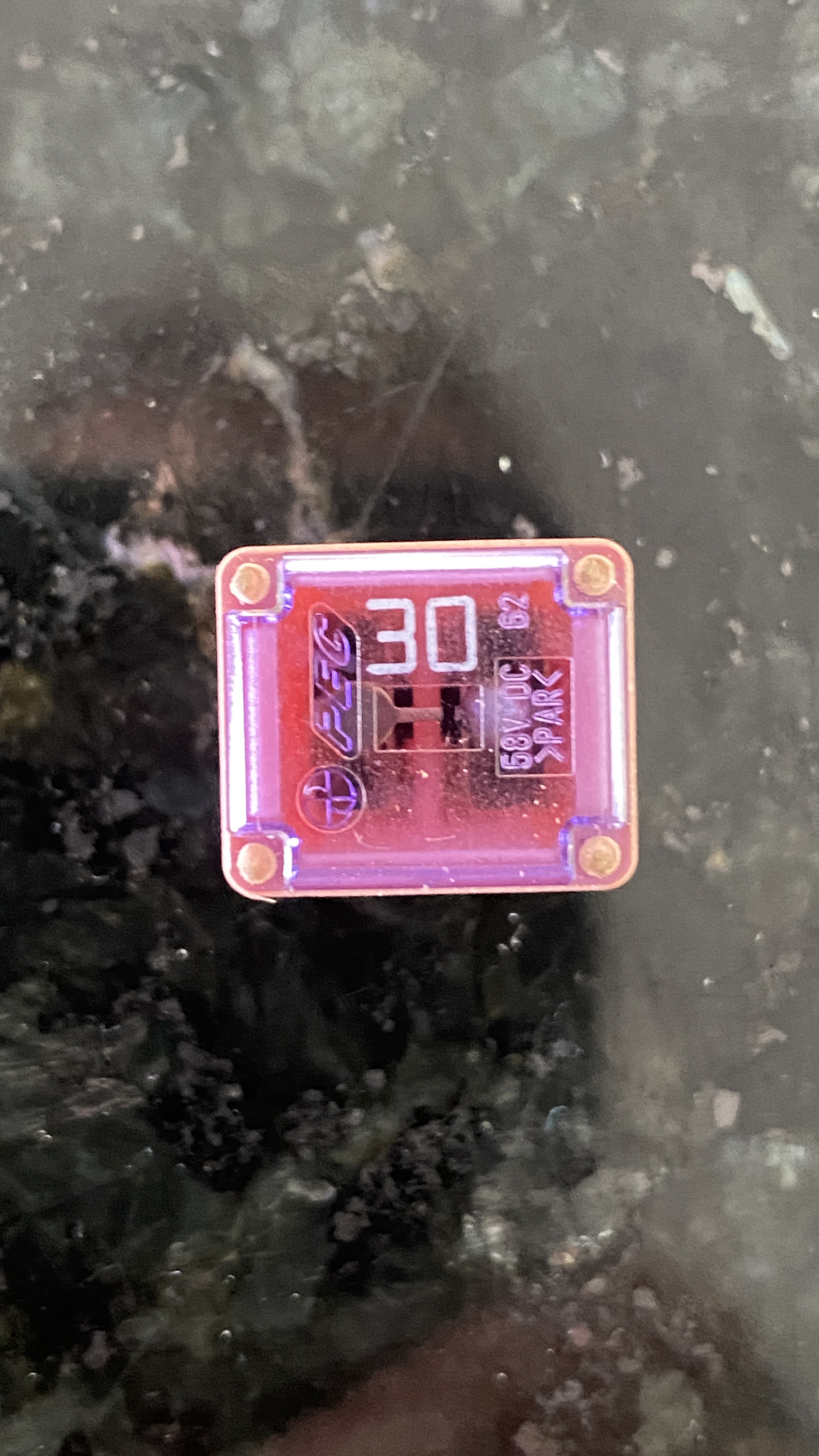

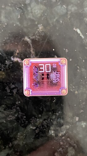

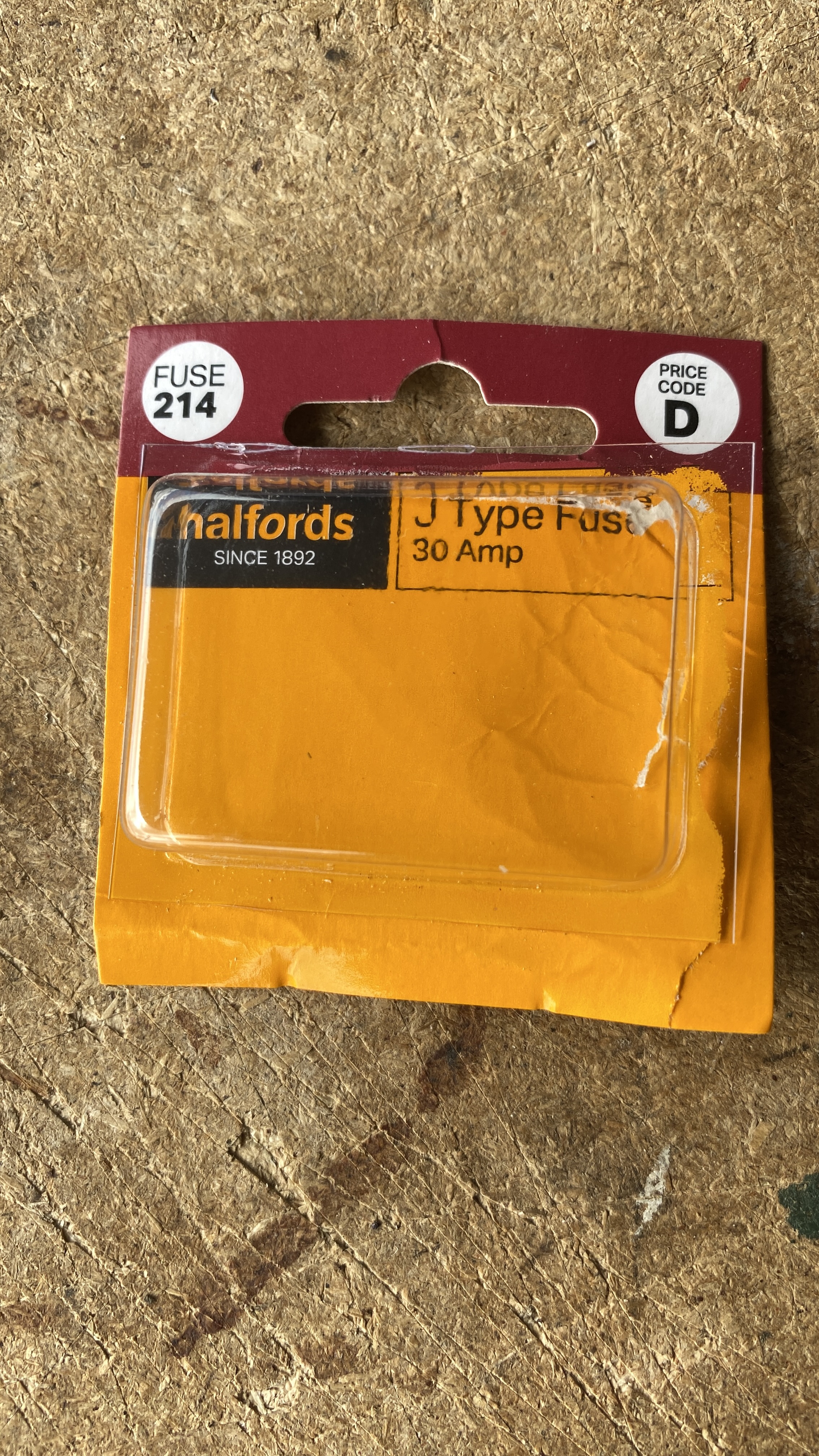

I’ve just had my fan fuse blow and this is what it looks like when blown. There are two fan fuses, the j type 30A and a std blade type 7.5A
Halfords do them at £2 or so.
The original fuse was shorter in height than the new one. But it fits fine as there is plenty of space before the fuse box lid would be an issue. There are relays in there and they stick up quite a bit.
My only concern now is why the fuse blew as I can’t find anything wrong anywhere thus far.
Hope that helps and hope the pics have uploaded as I’m away at the moment
