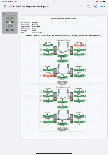

Thanks for the inputs. I went with Motorsports in Northampton which is closest to me. They adjusted my ride height and did a full four wheel alignment. The car really does feel like it goes round corners on rails. Cost was reasonable and combined with new Uniroyal rain sports the handling is transformed.
For those interested this is the alignment settings
Thanks, will use this as a “fast road” baseline for my upcoming alignment.
