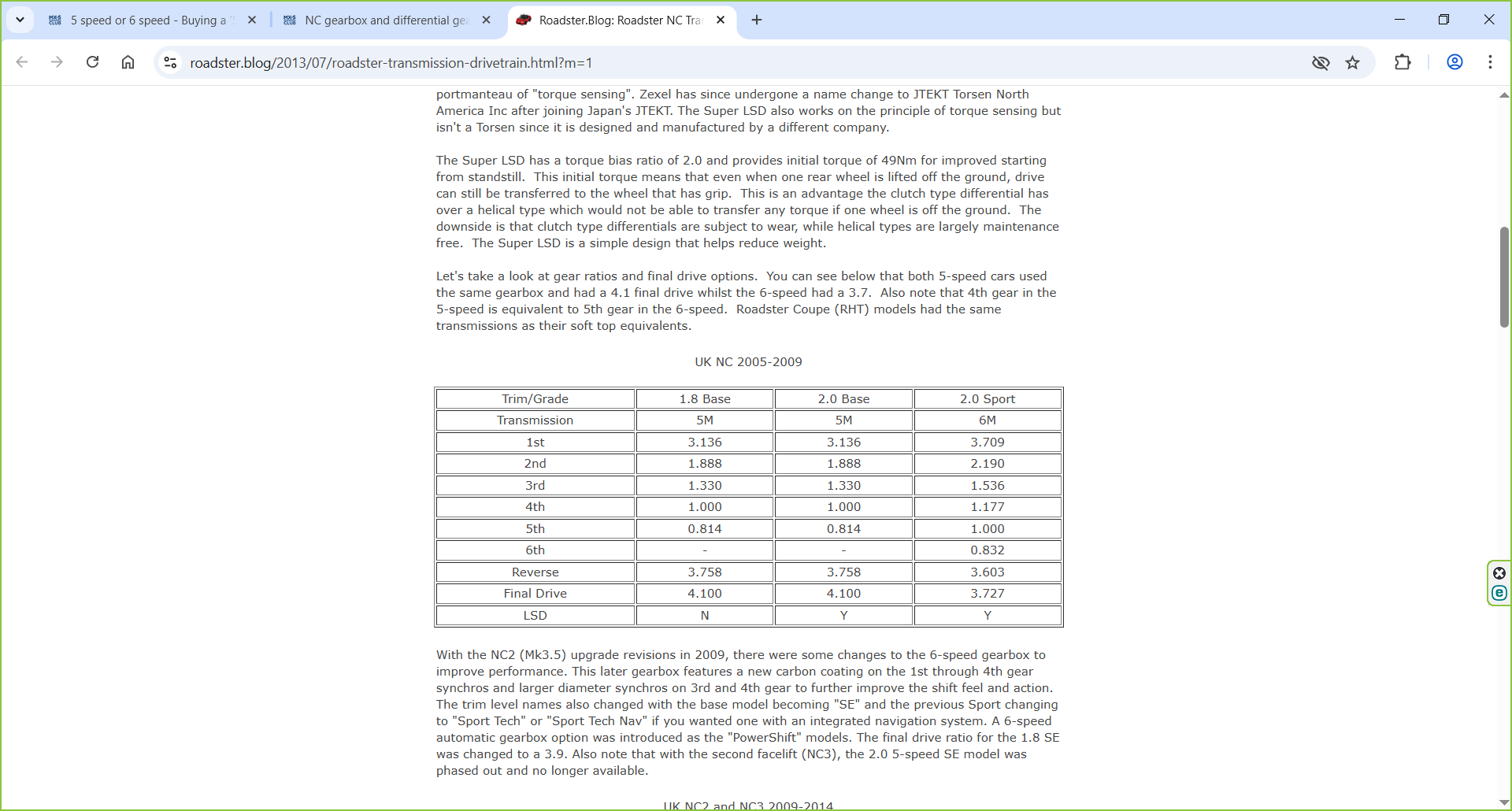

My source indicates that they both have the 4.1 diff. But as it only cost £2 from a charity shop it could be wrong!!
This is the table that I went off :

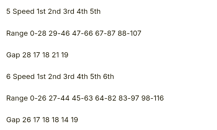

I came across this, 0-5000 rpm.

Being a bit sad I have looked at old Mazda brochures and the schedule you have posted corresponds to them up to 2009.
From approximately 2010/11 the final drive on the 1.8 5 speed was changed to 3.909 and remained the same till the end of the NC. It appears that this was the same time the 2.0 with a five speed gearbox was deleted.
So as it turns out everybody is sort of correct!!
PS My referance has been Mazda | Auto Catalog Archive - Brochure pdf download
