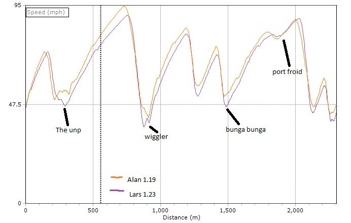

This graph shows how a fairly novice trackday driver (2 events) in a standard Mk3 2.0 can pull some good times with a bit of advice. His best time of 1.23 is a great time and he has still to maximise his cornering potential.which should see him drop to 1.21 ish
The graph also shows how being a little quicker in the 3 key corner (the Ump, the Wiggler and Bunga Bunga) can give you and edge on straight line speed.
Both drivers having similar Braking Curves. But 1 car had ABS and one didn’t. Both cars had the same tyres, federal 595 RSR but different pads, Standard Oem in my Mk1 and Carbotechs in the heavier Mk3.

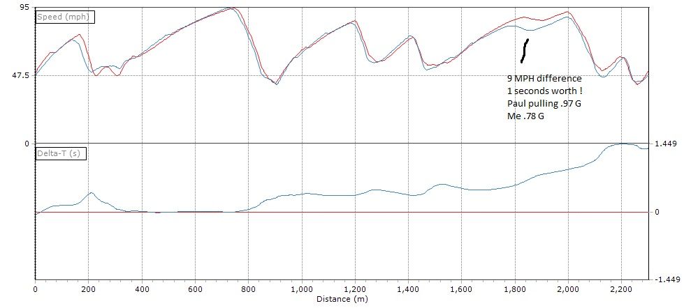

Now a bit of self assesment. i have waiting  to Log Paul Roddison and find a few secretsZip It!
So Paul in a “tweeked” Mk3 good suspension, brakes, tyres and a lightly modified 2.0 L engine.
Me in Uma.
Top graph is speed as above, Bottom is a Delta T…It shows you where each lap differs and where time is lost. Im matching Paul upto the wiggler. Then he pulls .2 of a second in both Bishops and Bunga Bunga. But my big loss is In Port Froid. Paul is faster and hold more lateral G.
That speed difference losses me 1.0 second…Not a lot, about 3 cars length. But cumulative thats 1.5 seconds down . 1.19.08 and a 1.17.67.
All on a 1.6 mile track @ an average 72MPH !
Goes to show we can all still learn. Im going to to be concentrating on Port Froid because thats where Im weak and can gain the most.
