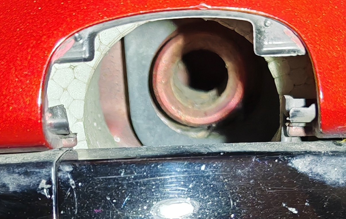

I’m sure that I am not alone among NC owners in having lost the tie-down hook cover from my front bumper. Personally, I blame the number of potholes on our roads, but who knows?
The covers are not that expensive, but they are supplied in black plastic and need painting in body colour; not the cheapest exercise, especially if you have a Soul Red car.
I’ve managed to get a replacement, but I’ve been wondering about adding a tether (possibly glueing a nylon zip-tie or similar between the back of the cover and the inside of the bumper).
Some people have glued their covers in place, but this is not a solution that I like, as you never know when you may need access to the socket. But some silicone sealant might hold the cover in place, while allowing it to be removed if required?
So – has anybody come up with a solution to this issue? If so, what did/did not work for you?
We use fishing wire to secure go-pro cameras to the motorbikes.
If it will hold a go-pro - it will hold the tow hook cover.
You could also consider gluing a metal plate on to the cover and gluing magnets inside the bumper.
I rebent the clips on mine after it became loose. Otherwise I would glue it in with waterproof wood glue - will hold it well enough but will give way when needed for removal.
