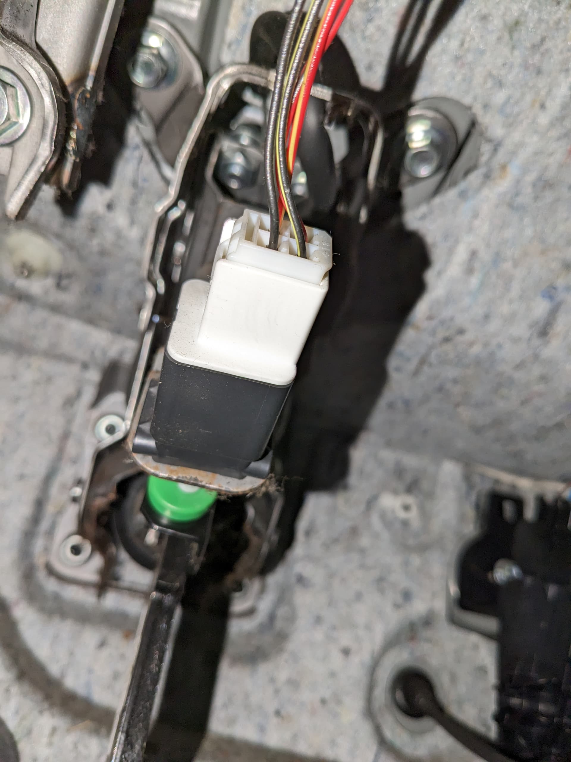

I count 4 wires, so will swap the wheel over and see what happens!
You have the “right” number of wires going to the switch, but I suspect you have the Non cruise control switch, which only utilises two of the wires ie has only two contacts.
The switch for cruise control has four contacts inside.

Ah I see! That makes sense, thanks.

@Wardy5 , Good news on the wiring for the brake switch.
Now unplug the loom and see how many pins are on the switch; if its only 2, one of the third party brake switches on ebay will suffice.
