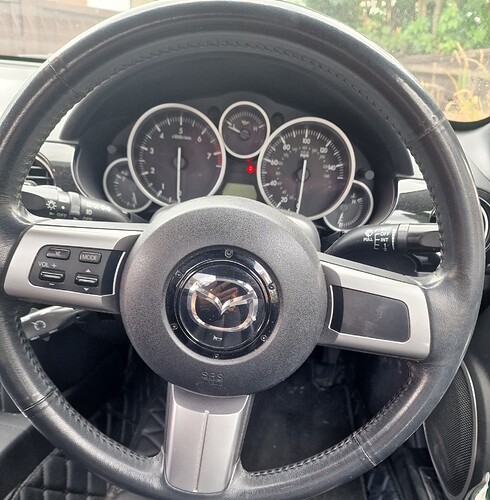

I’d also like to add cruise to my recently acquired NC2 2.0SE and have acquired a suitably adorned steering wheel.
2009 and later ‘supposedly’ only requires the steering wheel switchgear and the relevant 4 connector brake pedal switch …

I have purchased a replacement steering wheel with the necessary switches on it but still not yet ascertained what else I need to do after changing the existing wheel for the new one. I have found a place which can provide cruise control but it comes at a price and has an additional stalk. Would be a shame to do that if there is a way to use the ‘correct’ steering wheel. I really would like to know exactly what needs to be done to achieve cruise control now that I have the steering wheel. Please, someone?

As Max eluded to, unplug the brake switch connector to see if the loom and/or the switch have 4 pins, if they do then it’s just one extra step to put the steering wheel on that you’ve already sourced.
