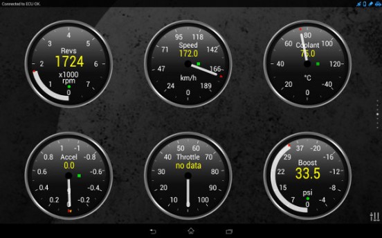

You could consider an aftermarket head unit and get the information from the Torque app.
torque_pro_2

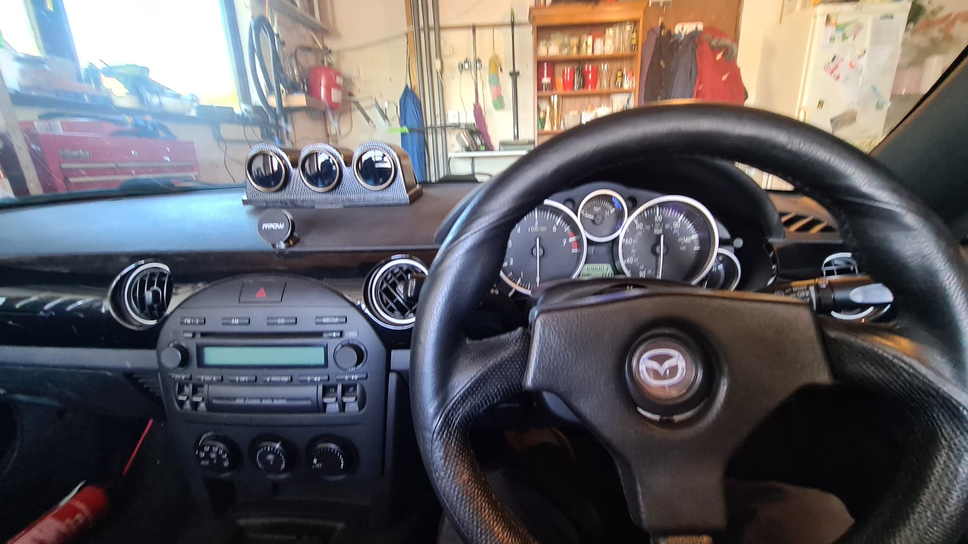

I’ve fitted all 3 gauges to my NC, mounted on a binnacle on the dash. The oil pressure is T’d from the oil filter plate, as I’ve fitted an oil cooler in front of the radiator. The same T piece provides the oil temp connection. The water temp comes from a collar on one of the water pipes at the top of the engine.
The binnacle is fitted over the grille on the top of the dash, where all the wires are fed though.
The gauges came from ebay, lots of suppliers sell them. The binnacle came from ebay as well.
