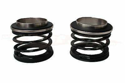

Bare in mind gas gold only have one set of collars so on full droop the coil will have a gap to the top mount. This is where helper springs can be used but also is fine to run without just might clunky occasionally.

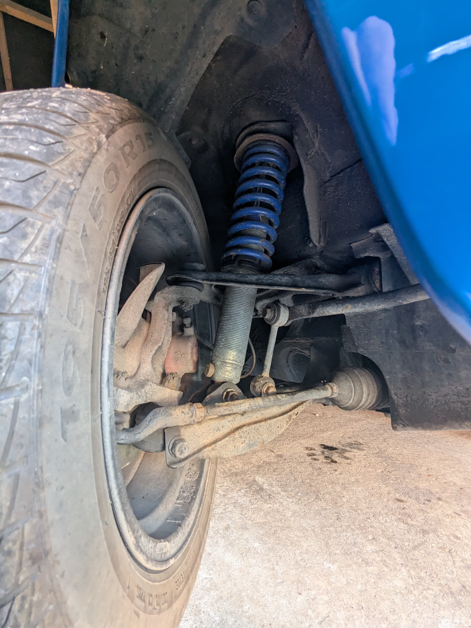

This is a photo I took the other day when I first started. Not sure if it’s any help
That looks like a single perch design, so only the preload is adjustable. (Compared with a double perch design where the overall length can also be adjusted.)
You can reduce the preload to the point where the spring is almost loose, but that’s your lot. If you wanted to go lower you would need ‘helper’ springs to ensure that the main springs don’t become dislodged at full droop (or different springs). A spring that’s loose at full droop is an MOT fail if discovered.
That said, you should have seen a significant difference from the adjustment you made - did you unscrew both of the nuts? (The lower one is only there to lock the upper on in position). The ride height should change by ~30% more than the shock height due to suspension geometry.

Unscrewed both rings yeah. Brought the locking ring down a good 15mm and then the top ring down to meet it.
That’s when I noticed the spring was loose.

The Sportives are a ‘2 perch’ design - you can alter the length of the shock by screwing the bottom mount up and down without affecting the preload.
Gaz do sell helper springs. Might be worth a call to them to see what ride height you should be able to achieve before you need them.
