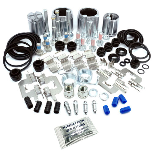

I have just done a refurb on all 4 calipers.
New everything ( pistons, seals, slide pins, springs, pad shims etc )
All in - appx £100
It is doable DIY if you are reasonably handy with the tools.

This is the kit I used - very comprehensive and all the parts fit as expected

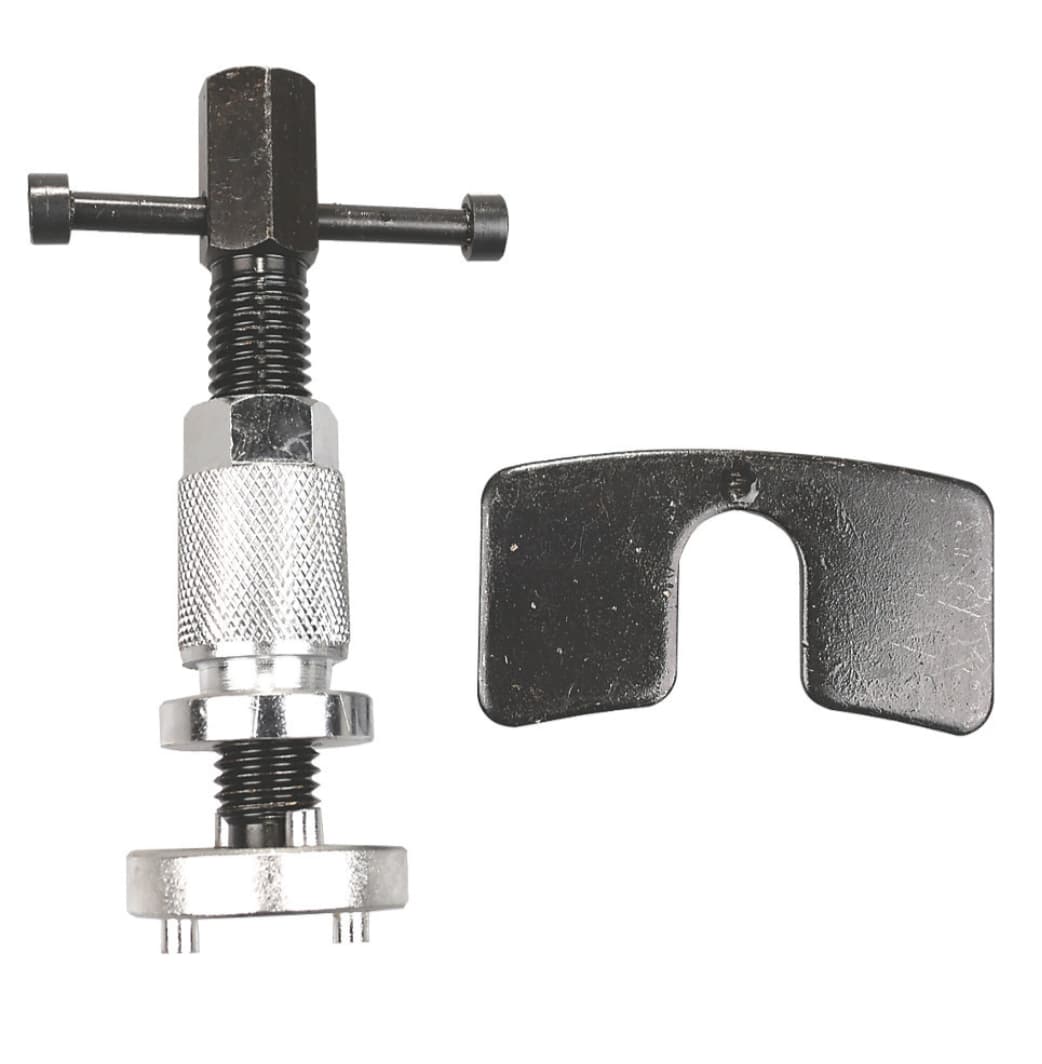

A simple tool like the one below is all that’s needed. Use the plate as normal on the tool for the rears to wind back. For fronts use as packing an old brake pad to push on against the caliper piston.
About £14 from Screwfix, does my NC and daily drivers calipers front/rear.
