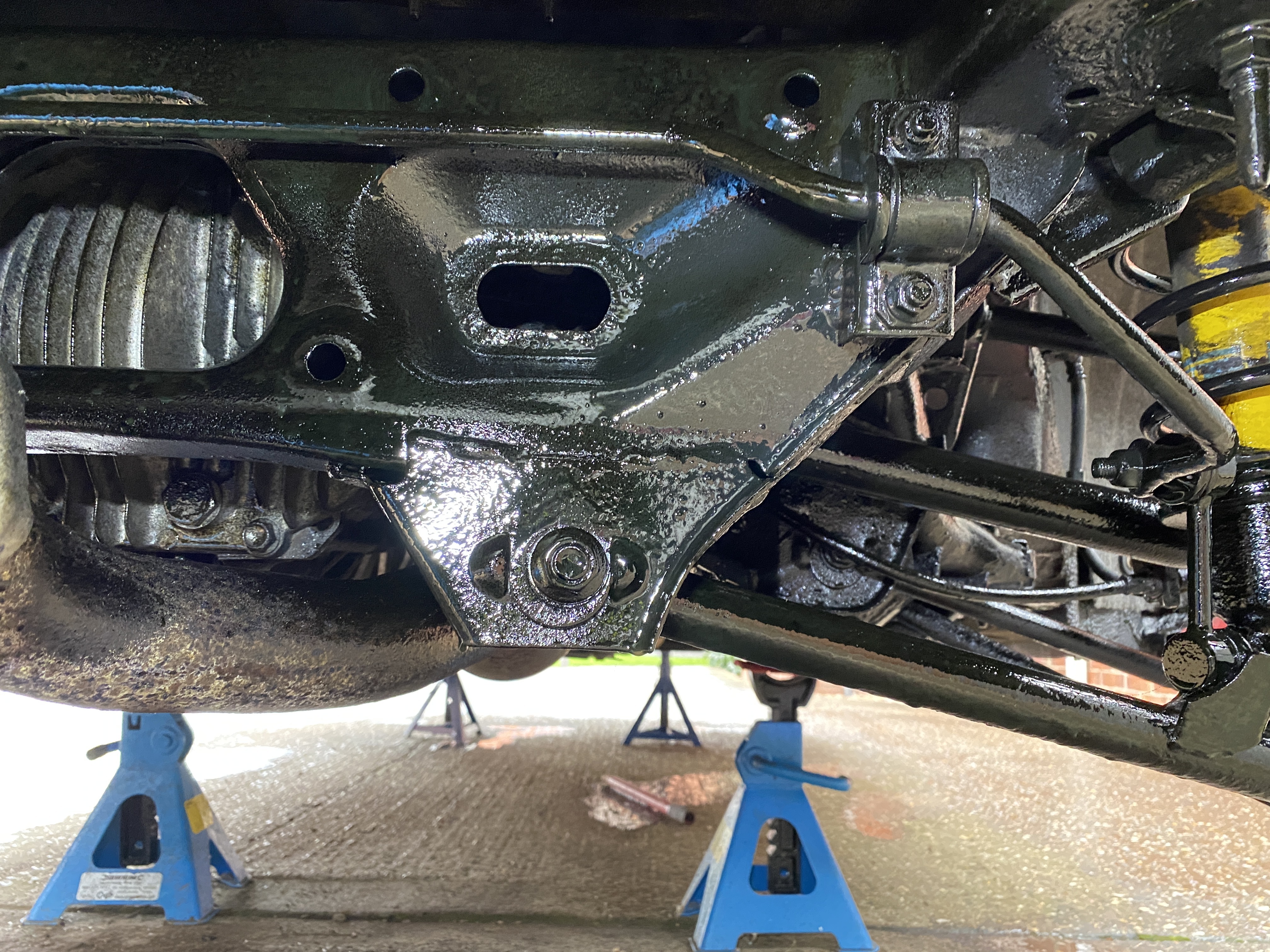

Jet washed ,
Rubbed down with drill / wire wheel ,
Rust killer ,
Treated with TETROSEAL,
Coating of lanogaurd
I used tetroseal on the underbody of my old car and it was great, very oem finish. ![]()
