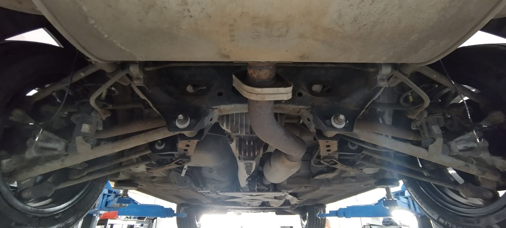

The current state of the underneath back in August when I got the new ABS sensors fitted.

Forgot to say, your car doesn’t look that bad underneath, seen much worse on younger cars.

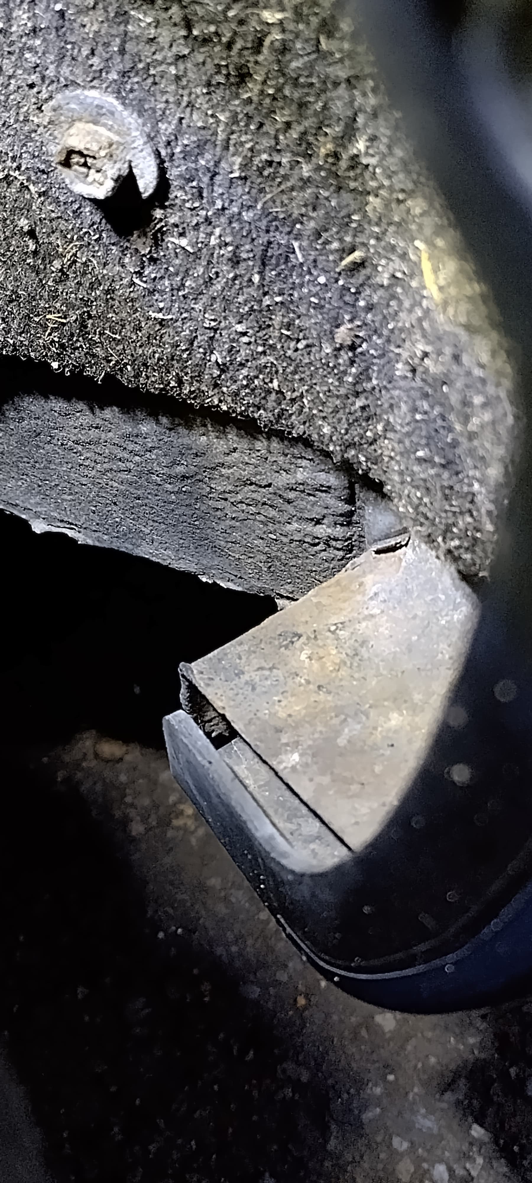

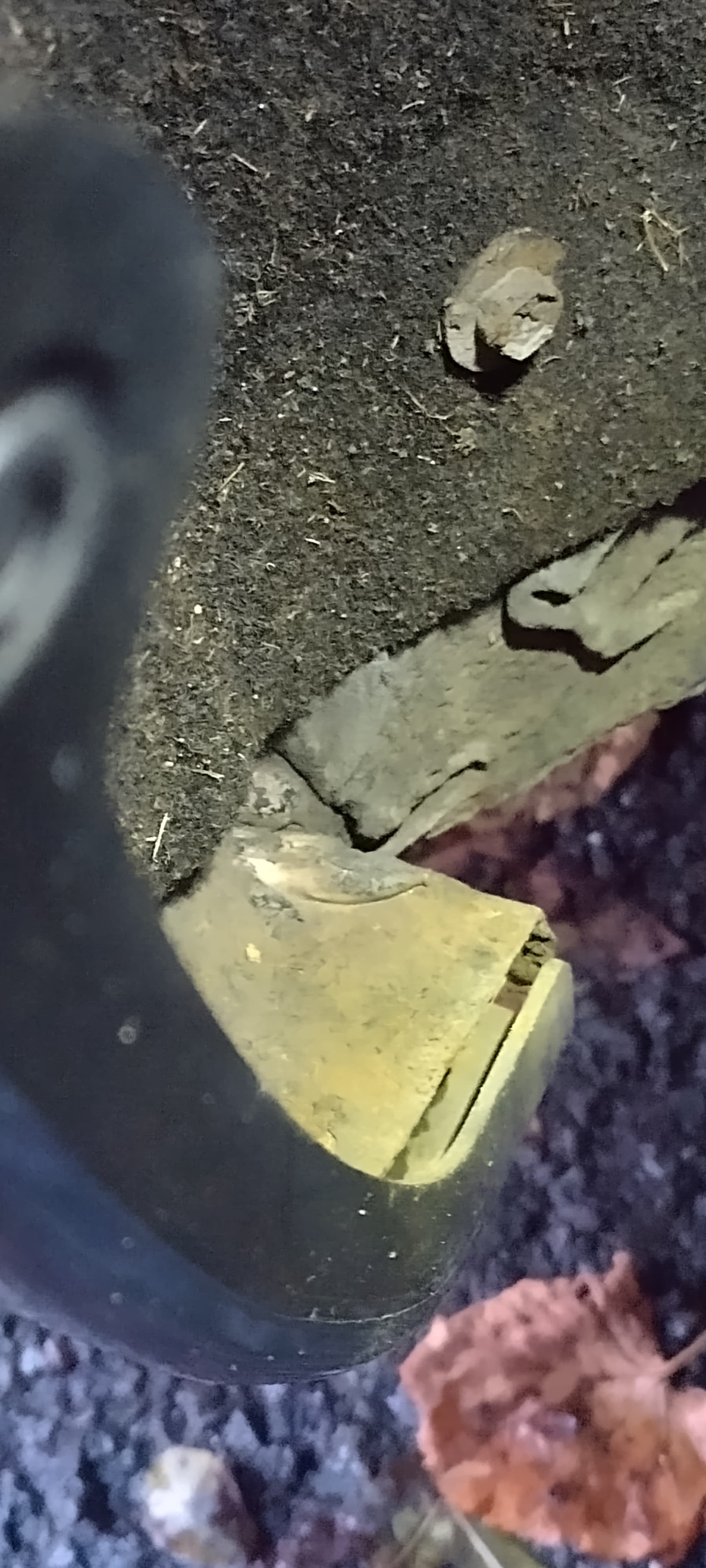

It’s usually the lower rear arch area that catches the rust, just around that lower securing screw/bolt.
First pic liner in place with lower screw. Second pic rust treatment with Built Hamber mastic.

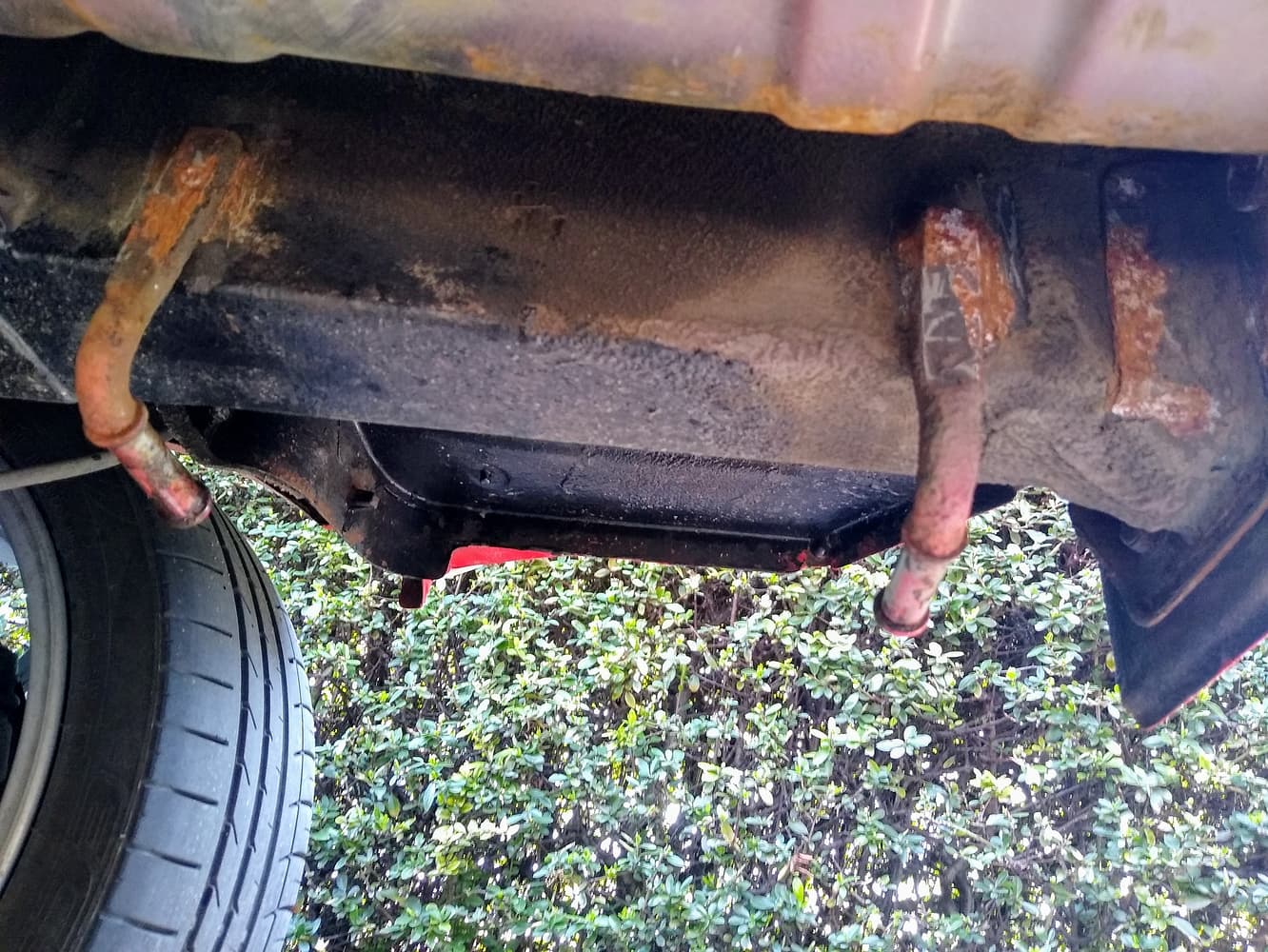

This area below, the rear chassis members and exhaust hanger mounts + boot floor can rust away. Best treated with the rear exhaust back box off, I took the heat shield off too.

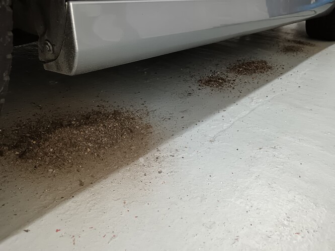

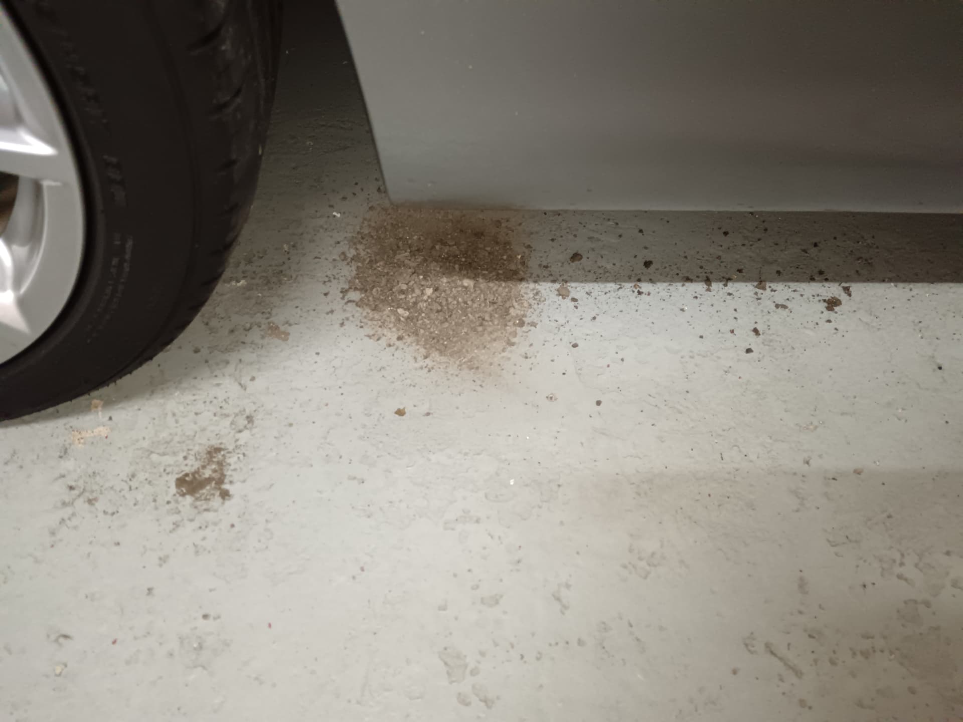

Under mine didn’t look that different from yours. First thing I did is get it up in the air with wheels off and remove the liners, see what I was working with. Citrus cleaner and jetwashing revealed it wasn’t in bad shape at all, most of what I thought may have been corrosion ended up being caked on dirt.

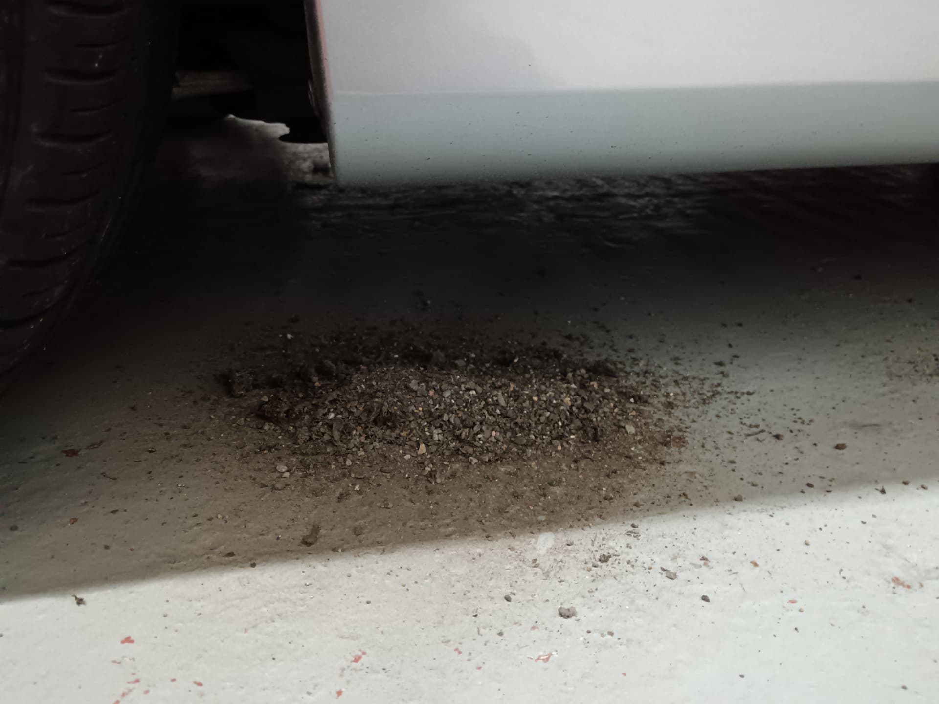

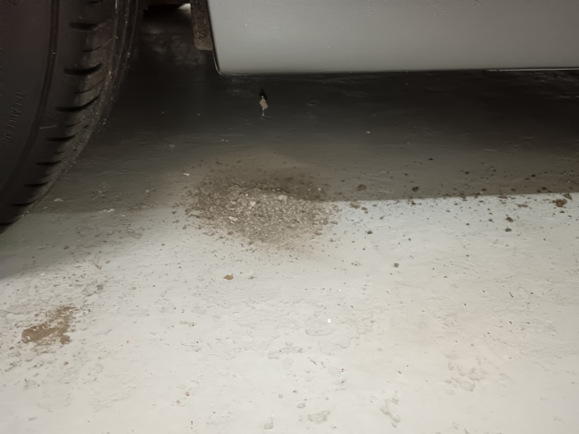

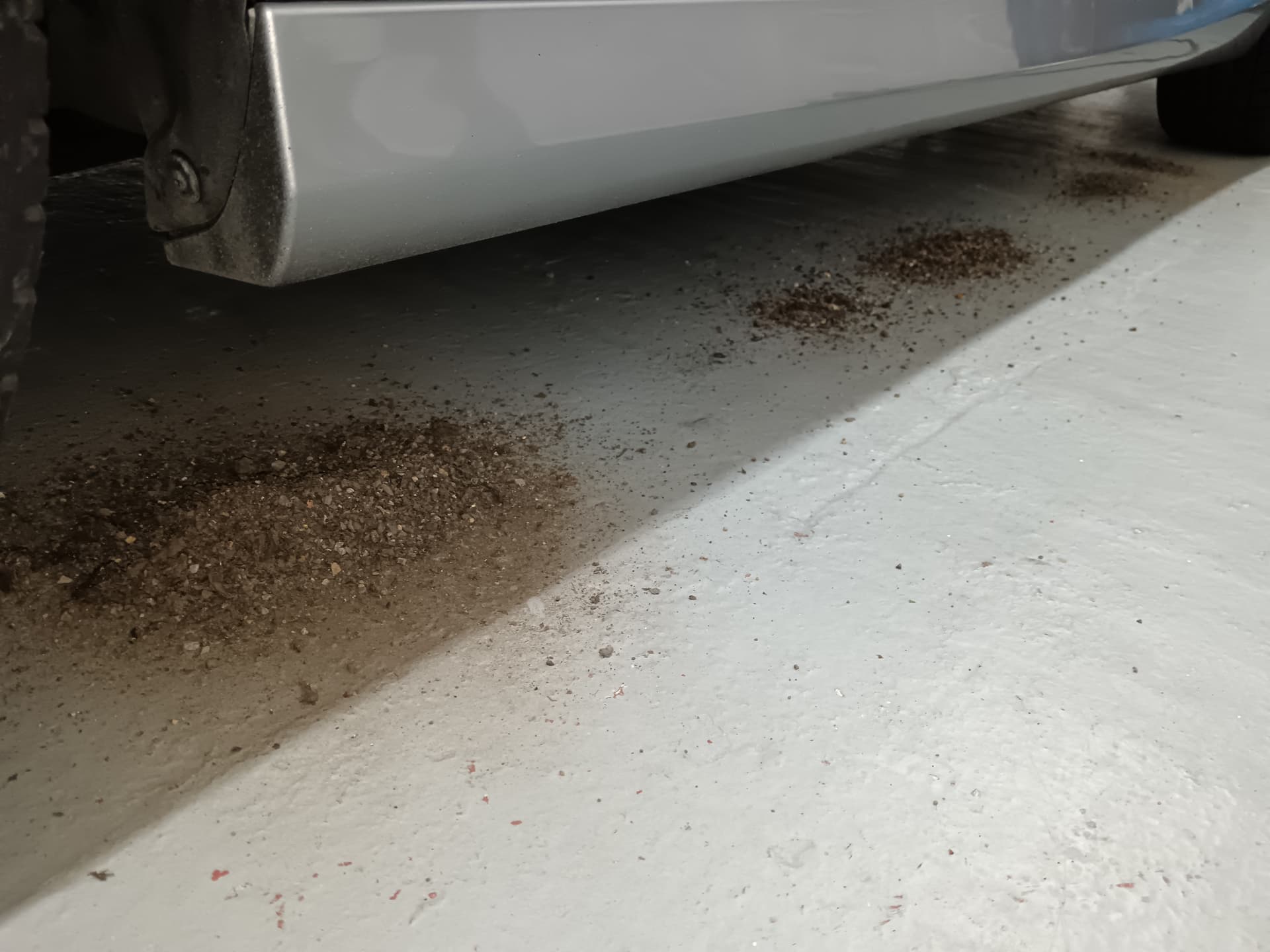

One thing I’d say for certain which I discovered by accident - if you can safely remove them then take off the side skirts to clean them out - they seem to be a poor design, there isn’t anywhere for anything to fall or drain out apart from a very tight gap against the sill. Mine were absolutely filled with old dirt but where the car had been stored inside for a bit it had all dried out. I didn’t take the skirts off as I didn’t want to break all the clips unless I had to so ended up tapping firmly all the way along them and the dirt just kept falling out until it stopped coming. If anyone hasn’t done this I’d highly recommend it, I reckon when all was said and done I had a good kilo of mud and grit.
I imagine this is part of the reason they rust along there, if that dirt is trapped between the skirt and the body and gets wet, you know the rest! The most dirt fell out right before the rear arches and behind the front arches, which seem to be problem areas.

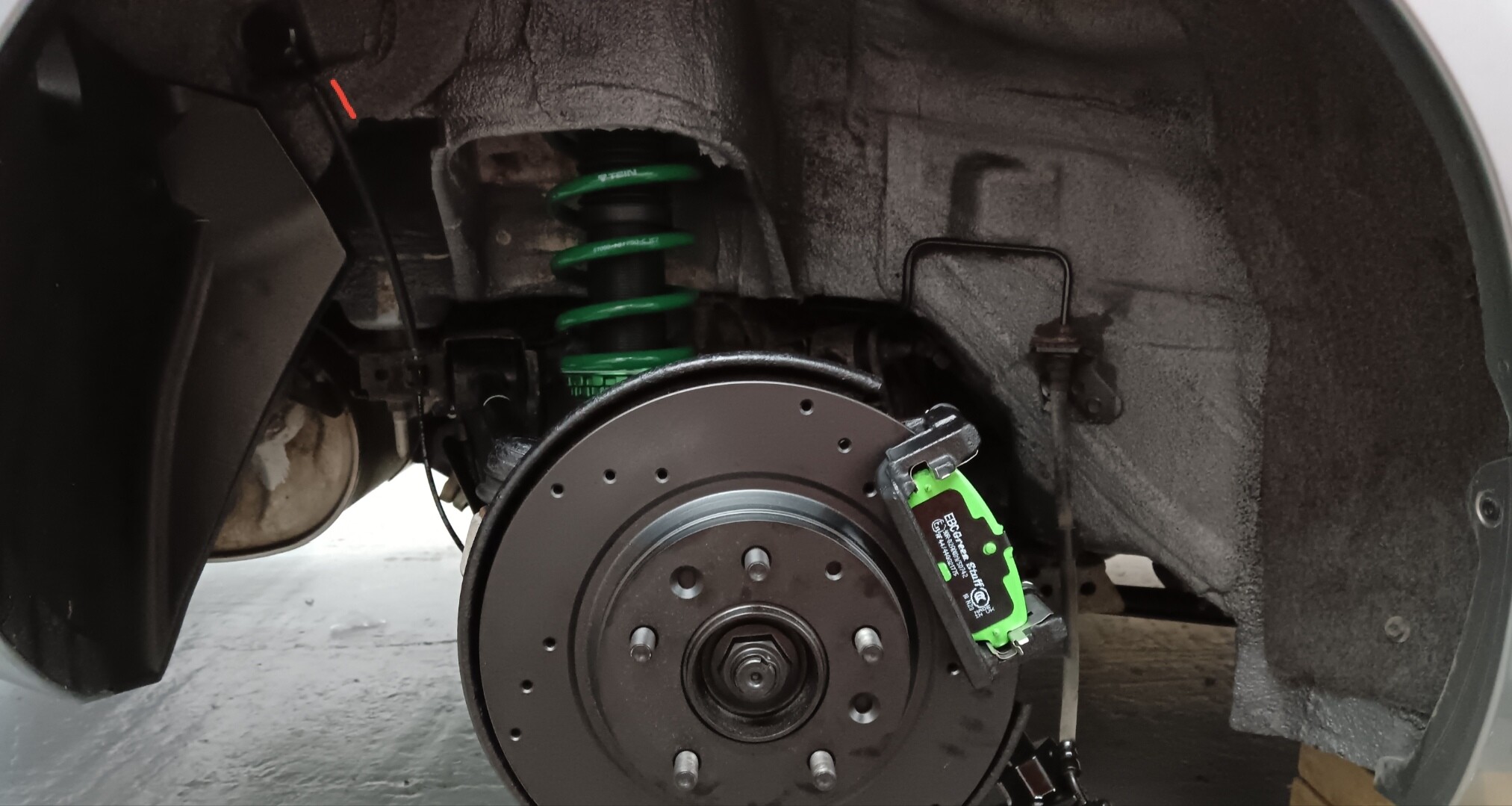

The liners all came off easily. Front ones with a fingernail or small flat screwdriver, might of had the odd 10mm bolt. They go around the suspension strut so you can drop them but not completely remove without dropping the strut. Rear ones you may have trouble with the little screws down the bottom spinning the captive fixing while you’re trying to get them out. You’ll have to snip through a little bit of the carpet style liner to remove them fully unless you want to go into the car, remove the trim and disconnect and remove the abs sensor leads (where the red line is on the photo)
Then there’s just some plastic nuts to spin off.
And here’s the fronts, you can see where it goes round the strut.
