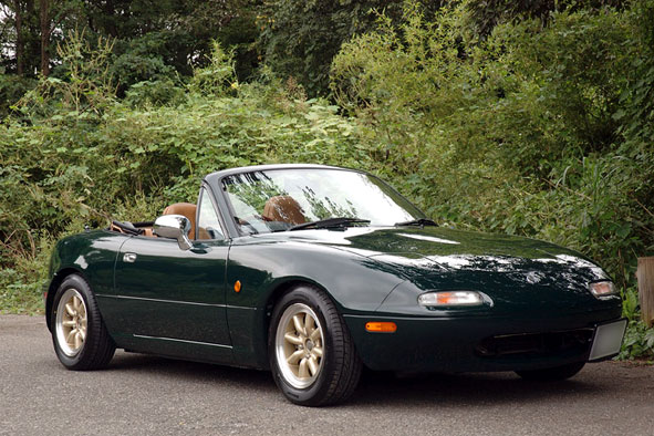

Watanabe F8

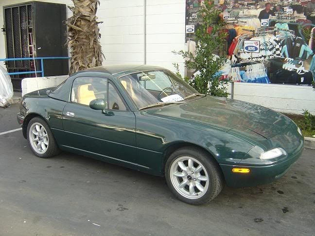

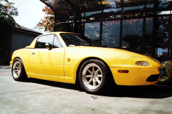

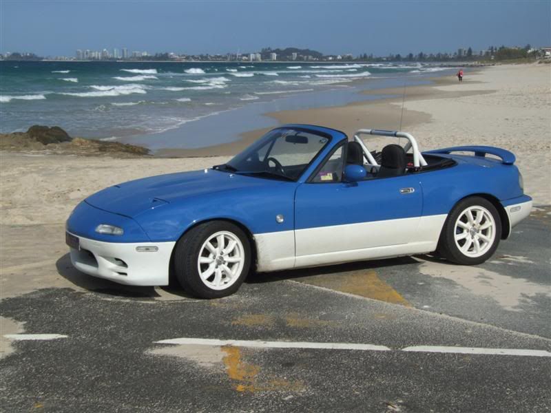

14" Watanabe, with the suspension deliberately jacked up
15"WAtanabe with suspension back to a lower setting

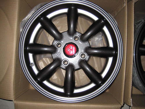

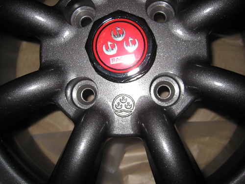

Genuine Watanabe logo (note which way the Cranes face):

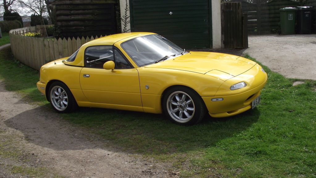

14", different widths/offset
15"

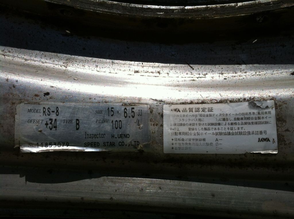

There are also the much more rare 15" Watanabe Speed-Star RS-8

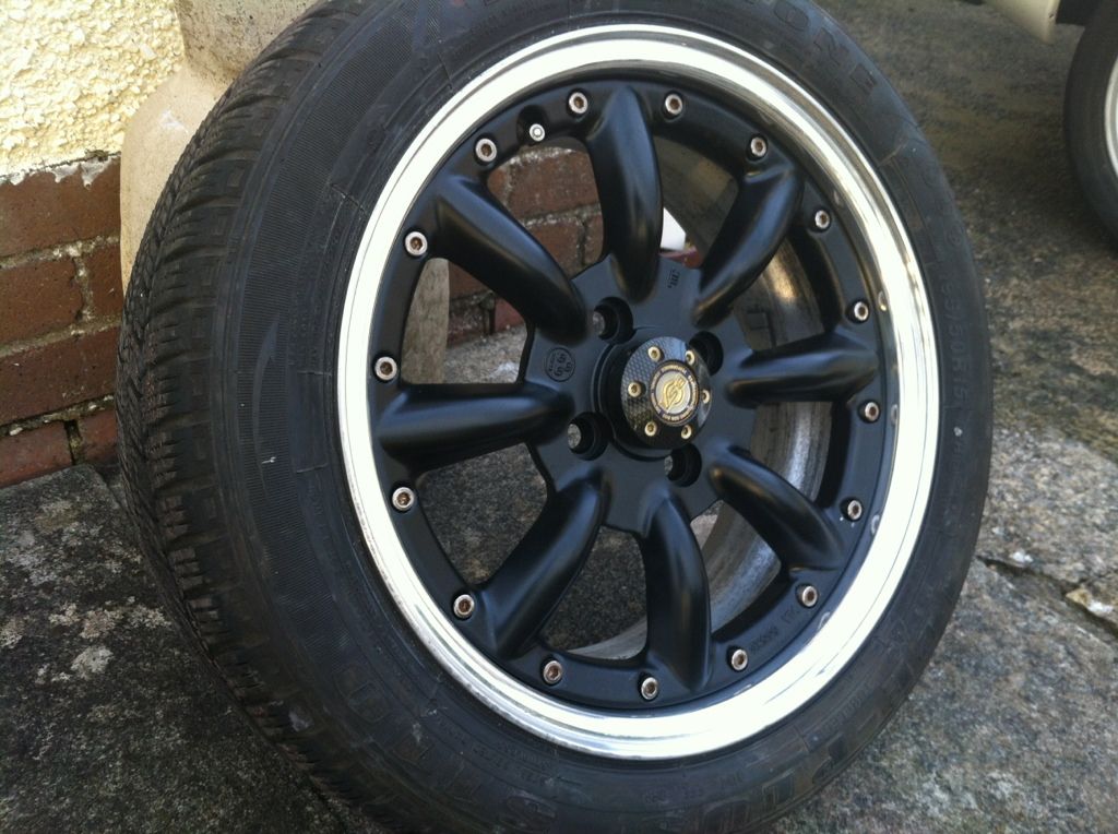

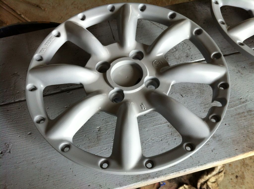

 split-rims, here are some I have just re-furbished, I do know for a set of them available for sale currently, PM me if you are interestedThumbs up
I was going to sell mine but since refurbing them (satin black and hand polished) Mrs. Eunos has forbade them going elsewhere and insisted they now go on our supercharged Eunos R2-Limited - so thats her birthday present taken care off then…Dancing
Not that rare, judging by the number of times these SSR Wats come up for sale. I sold a similar set of these SSR Wats for £60 not so long ago. Some have had the rims welded up in Japan, some haven’t; it seems the seams could leak. They were originally intended to be 3-piece, but it looks like someone decided they should be 2 piece instead. These were made for SSR when Watanabe was facing bankruptcy. The one’s I had had been assembled with stretch bolts; replacements can still be had from SSR, but pricey.  Others were put together with fairly normal bolts, but all the ones I’ve seen look so banjaxed, that I’d get replacements if refurbishing the wheel (which is pretty normal in the BBS world). They seemed an awful lot heavier that the cast 15" F8F Wats I had on the '92 car. Not as heavy as Panasports though (which Mazda opted for as an OE supplier).
I’d plump for the real 1-piece Watanabes if you see them, not the SSR versions.

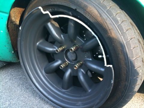

Trouble with the cast Watanabes is that this can happen, I would prefer the rim to bend rather than crack…
