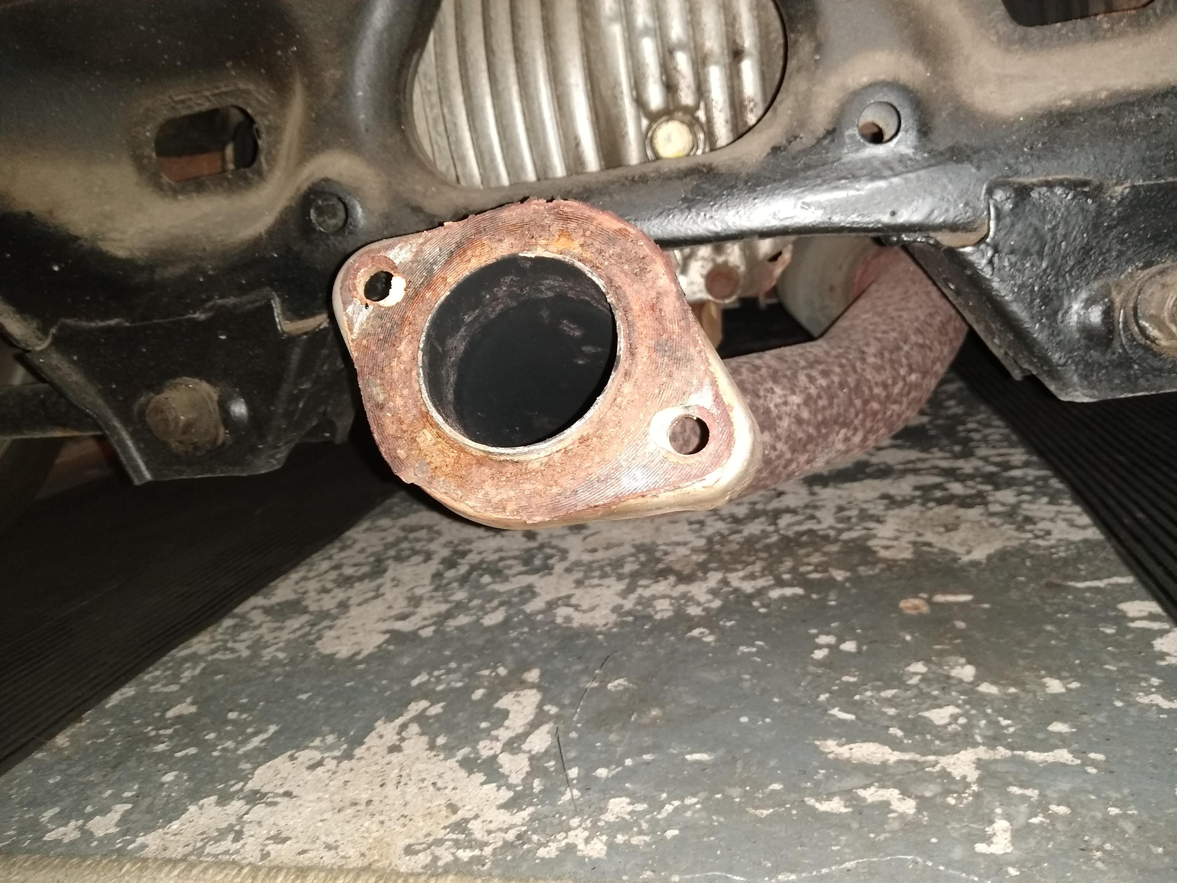

Hi there nick thanks for your reply, I read somewhere if you use these on a backbox with a flat flange and no recess it can bend the flange? Also I used a flat gasket and that’s what I used on my muffler before and that worked fine however they are slightly different sizes by a few mm.

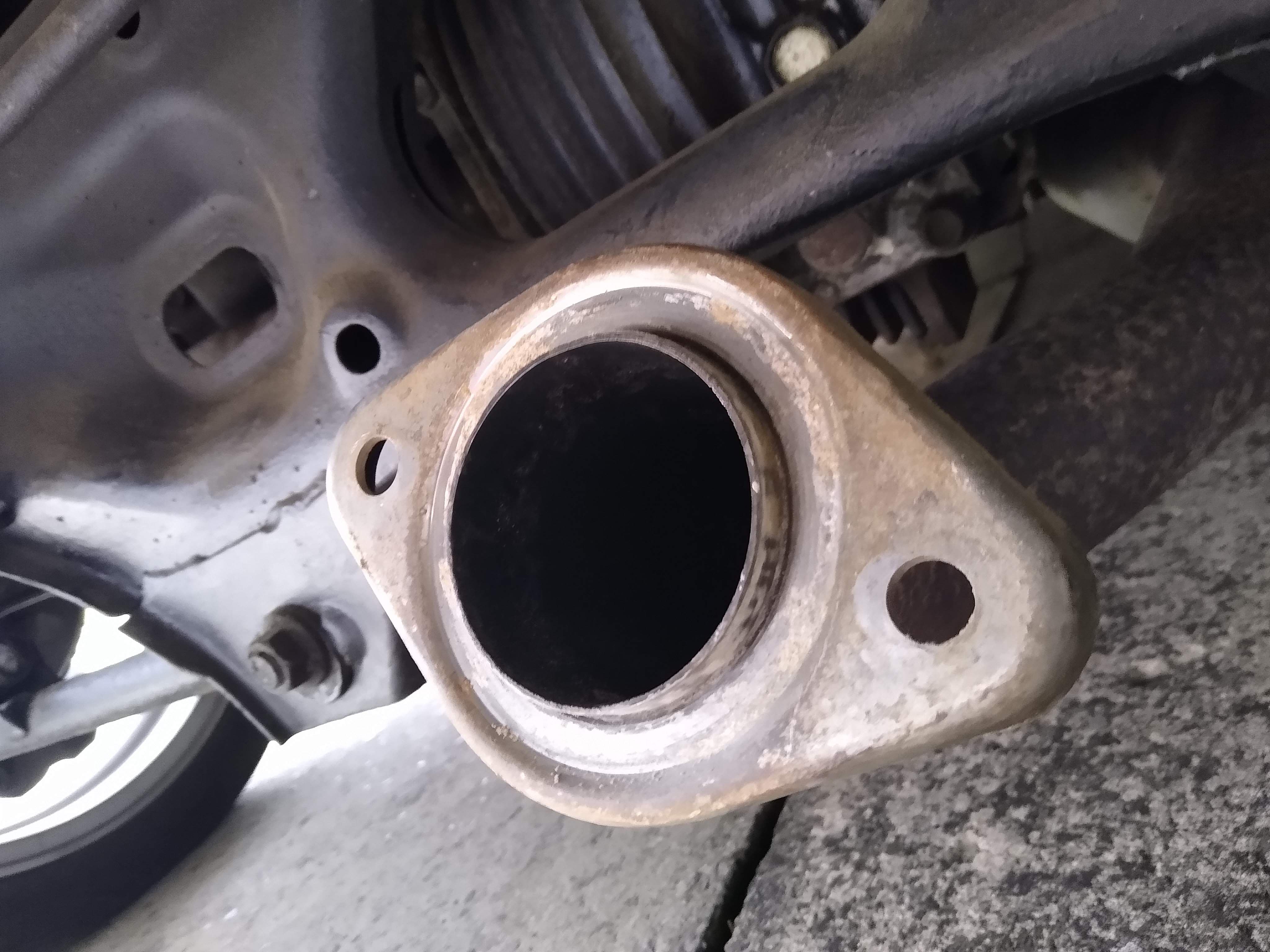

I fitted a flat washer/gasket previously when I purchased a Cobalt back box, the type that has the two holes in it to pass over the bolts. That wouldn’t seal properly so I got that crush washer in the link. For some reason it still didn’t seal properly with that fitted.
I bought another washer some months later, the same crush washer but this time I cleaned up the flange and spigot that’s on the end of the mid pipe and offered it up with crush washer. It all seemed to fit squarely so I bolted it all up and no more leaks.
I think what could have happened with the first crush washer was the mid pipe spigot didn’t fit squarely in the Cobalt back box flange not make a gas tight fit and in turn not crushing that washer enough.
I also supported the mid pipe end when tightening up the joint so it mated together better.

thats helpful, I may give that a go. my only concern is with the crush washer, could it perhaps bend the flanges, if the back box surface doesn’t have a recess in it whereas the mid pipe does.
I cleaned the spigot up before refitting with a new gasket.
