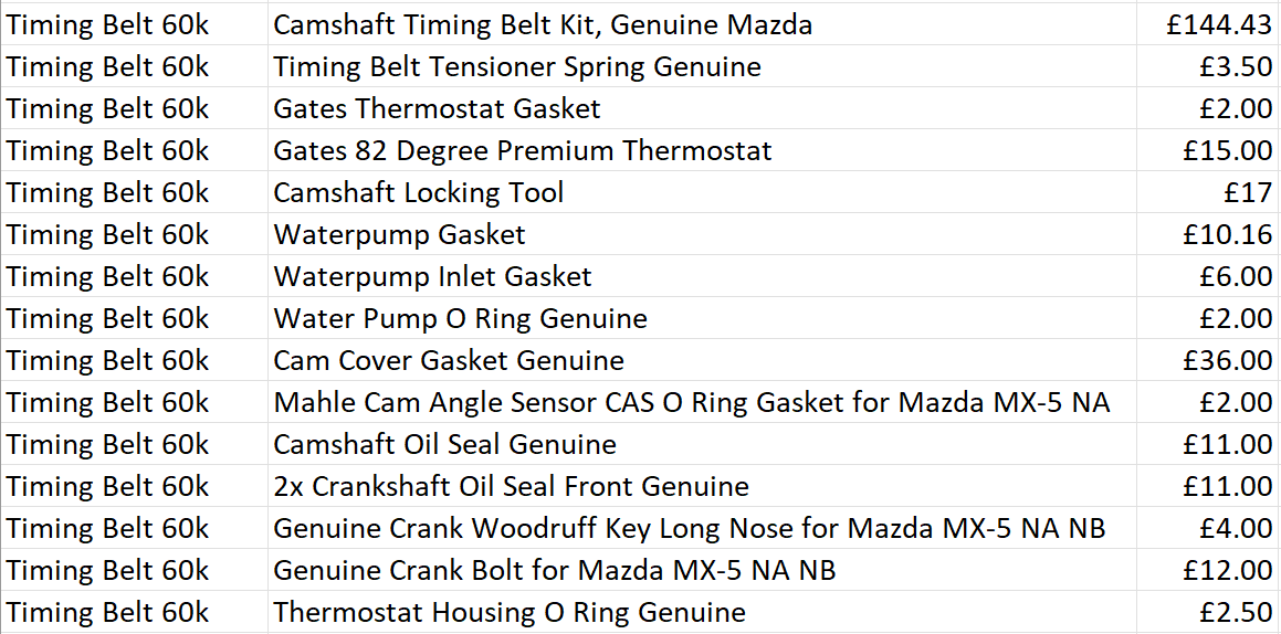

My car has just hit 100k km and its time for a timing belt and cooling system refresh. I have collated a list and wanted to know if I was missing anything essential or just any ‘while I’m there’ things to do. Do you guys think its worth doing a head gasket whilst I’m doing the timing belt job?
Timing Belt
Waterpump included within timing belt kit

I wouldn’t bother with the coolant reroute or the fancy radiator, the money you save on those two items alone would pay for everything else.
You seem to have 2 crankshaft seals and only 1 camshaft seal. It should be the other way round.

Good spot. I must have got it mixed up when making the list. I’ll get this swapped out. Any advice on whether doing a head gasket is worth it before the timing belt job. It will make the coolant reroute easier too. I’m not sure if head gaskets are a time replacement item or wear replacement. Engine is on just over 100k.
