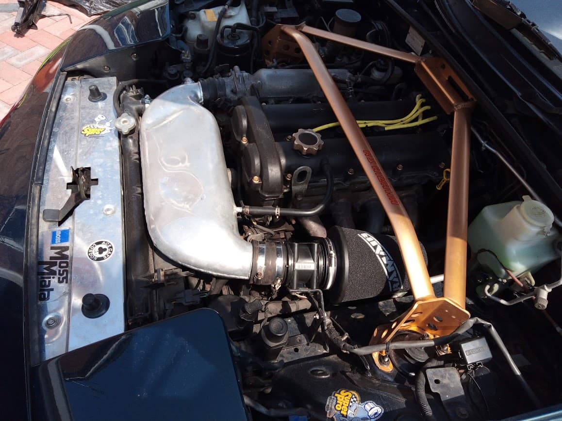

Most sock filters will come with a few rubber ring adapters. Its what I did with a Ramair filter.
You need to figure a way to support the MAS, by jury rigging a bracket

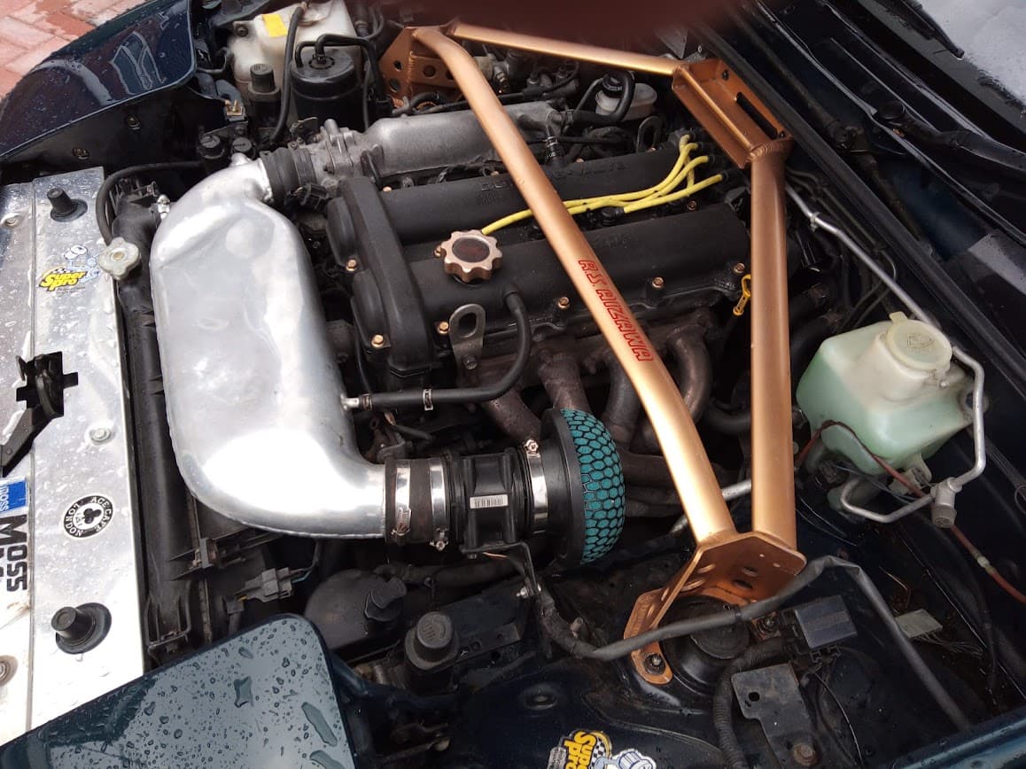

An adapter plate is required for the MK1 / Eunos 1.6 only as it has a Mass Air Flow meter, Commonly known as a MAF Meter with a relatively complicated mate with the airbox, involving threaded studs and in inboard port.
MK1 1.8 and indeed all MK2 / MK2.5 cars have a hot wire system commonly known as a MAF Sensor. These are all effectively tubular, so lend themselves completely to easy modification to fit to rubber/plastic tube or directly to a cone filter.
My advice is to remove your MAF sensor from the airbox end and you will see what you need to join to. The MK1 / Eunos 1.8 even has a rubber seal to fit neatly into a tube or cone filter end. This can be removed if not appropriate to your homemade fitments.
