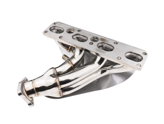

By manifold, I take it you fitted this:

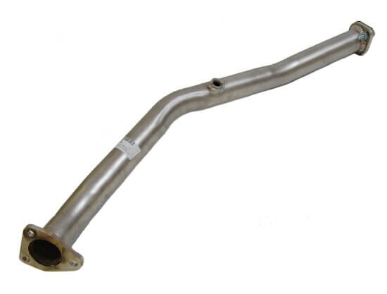

When instead you should have fitted this:
Because that has a O2 sensor port (albeit the wiring will need extending.
1.8 and 1.6 manifolds are different, and not interchangeable (the 1.8 block is longer). You have somehow married up a 1.6 downpipe to a 1.8, with the result your bumper is melting. You should have fitted a 1.8 downpipe (though the full header is better);
Note O2 sensor port.
Come MOT time, you will need to fit a 440mm cat. From experience, aftermarket new cats are pretty marginal, you really need the genuine Mazda item. My car is a 1996, with a 1994 engine, MX5parts header, scrapyard Mazda cat and cheapo ILM twin exit cat back which I hate with a vengance. It still has to pass as a 1996 engine.
