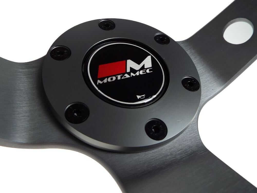

I have two issues I’m trying to resolve with my new steering wheel. I’ve purchase a Works Bell standard boss and a Motamec 350mm wheel.
First issue is the horn. It does not fit through the new boss once it’s pressed into the steering wheel itself and it’s not even remotely close to fitting, I’ve for now taken the little metal surround you get with the wheel and used it as a spacer at the back so there is a space for the clips to sit in but this isn’t really a solution since I sorta need that to hold the horn in.
Secondly it seems the wheel is binding on something, possibly the turn signal clock at the back? It sounds like platic on plastic and the wheel does not self centre.
I can provide pictures tomorrow when I get the car from its MOT but for now hopefully someone has a “aha I’ve had that problem” and chimes in!
The boss kit
The wheel

I actually fixed both problems this afternoon. Some spacers fixed both.
