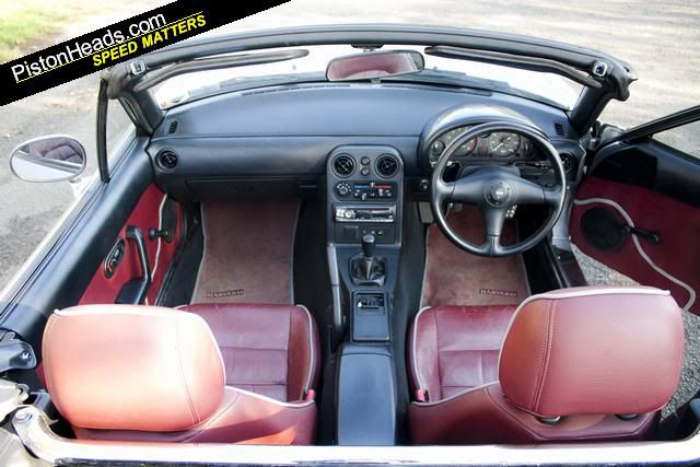

I read your thread with interest as I have recently bought a 1997 1.8i Mk1 with am mx5 Momo wheel similar to the photo below (this isn’t my cars though). I was under the impression that this was the original wheel, but I’ve noticed that i also have an airbag’ indicator on bottom of the rev counter next to the headlamp popup indicator. This never comes on when he ignition is on prior to start up, or after engine is on. There is no space for an air bar on the steering wheel and there is no airbag logo either stamped on it. Any  ideas? Is the indicator there to cover cars of this age that had the ‘option’ of an airbag?  Is this not the original wheel even though it is an MX5 Momo? Will it pass the new regs as it is? Is the issue for an MOT whether a warning light is on? Any thoughts would be very welcome.<o:p></o:p>
<o:p></o:p>
Thanks <o:p></o:p>
Herbie<o:p></o:p>
This is a factory wheel, and is of the same type I replaced with a Nardi. All Mk1 MX5s (at least from 1992) will have a redundant airbag light fitted to the dash (no bulb); US spec cars always had an airbag, and from 1992, it was an option in Japan.
 AT thanks. So they were an option in the UK as well? I forgot to mention mine is a UK car. Whats your view on what an MOT tester will think about seeing a warning light that does nt ‘appear’ to work with no airbag in wheel. ie they dont know the manufacturing spec/details of these cars. The AA site says:
