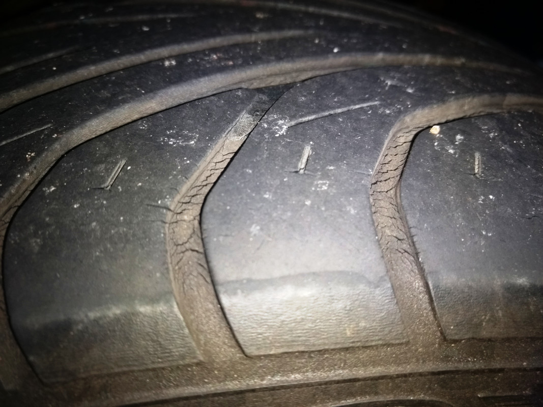

On the subject of changing tyres due to age I’ve just checked mine and there are no signs of cracks on the walls of any of the tyres, but all are showing cracking on the tread face as shown in the photo.  The car’s just passed its MOT with no mention of any issues.  Would be grateful for your thoughts and feedback.
Tyre Cracks
They need replacing ASAP. Dangerous is a word that springs to mind.
Hmm, myself, I’d change them soon as possible, especially if doing any prolonged high speeds or heavy cornering, the rubber has had it.
In 1999 I changed the rear OE Contis on my old Astra specifically because of cracking along the bottom of the treads, after 105,000 miles over five years and still with 4mm tread - mostly at a steady 70 on M25 as daily commute.  They looked fine inside with no crumbing at all, but the tyre experts said it was well overdue because the external rubber was actually perishing and disappearing.  It was only picked up because I’d asked them to repair a slow puncture - I could see the nail in the tread-block.  The fronts only lasted 45,000 and two years at a time, same as the front brake pads.
