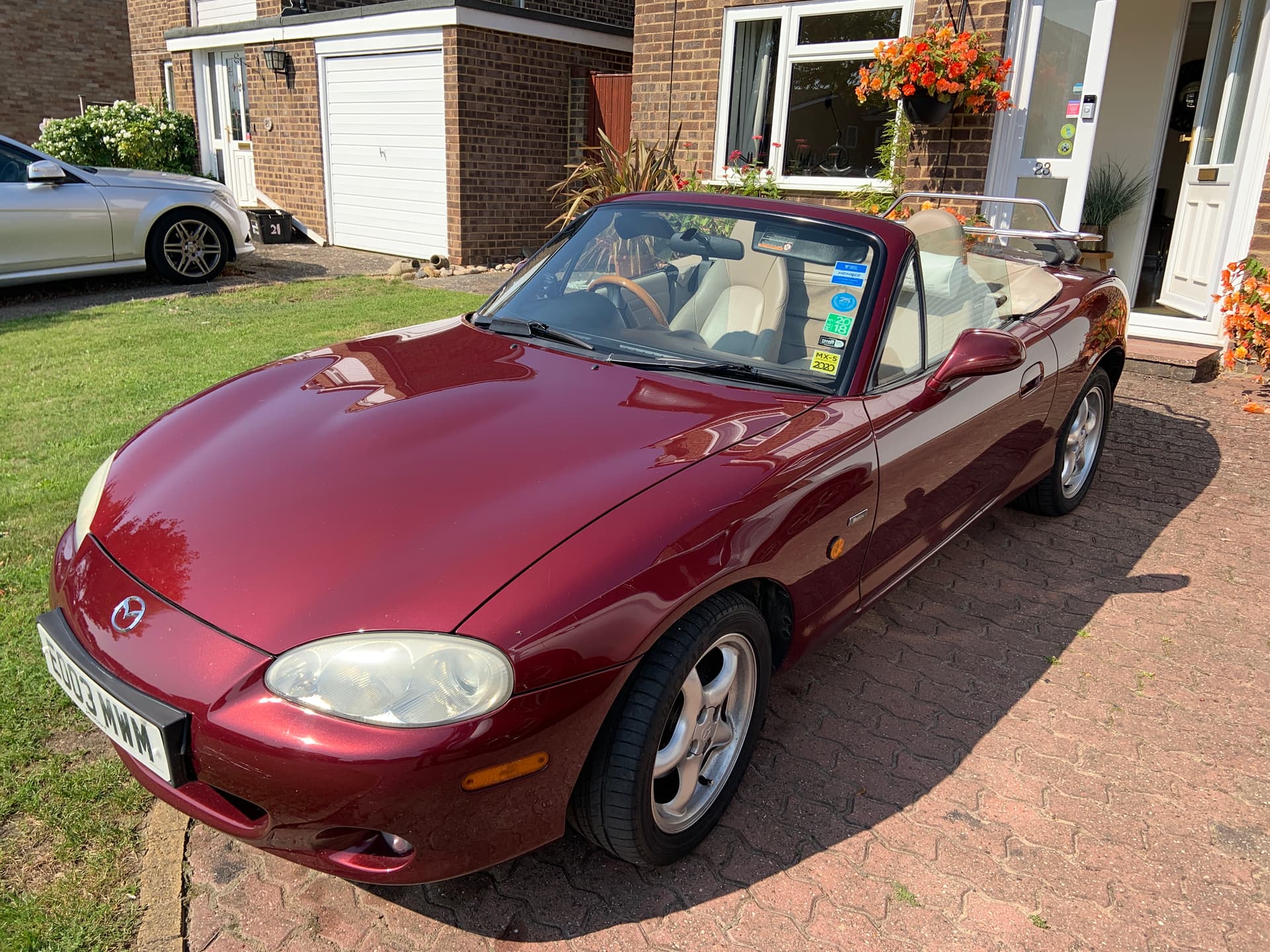

This is such a great club and I am proud to have been part of it for nearly 10 years now.
My Montana will live for another10 years !
